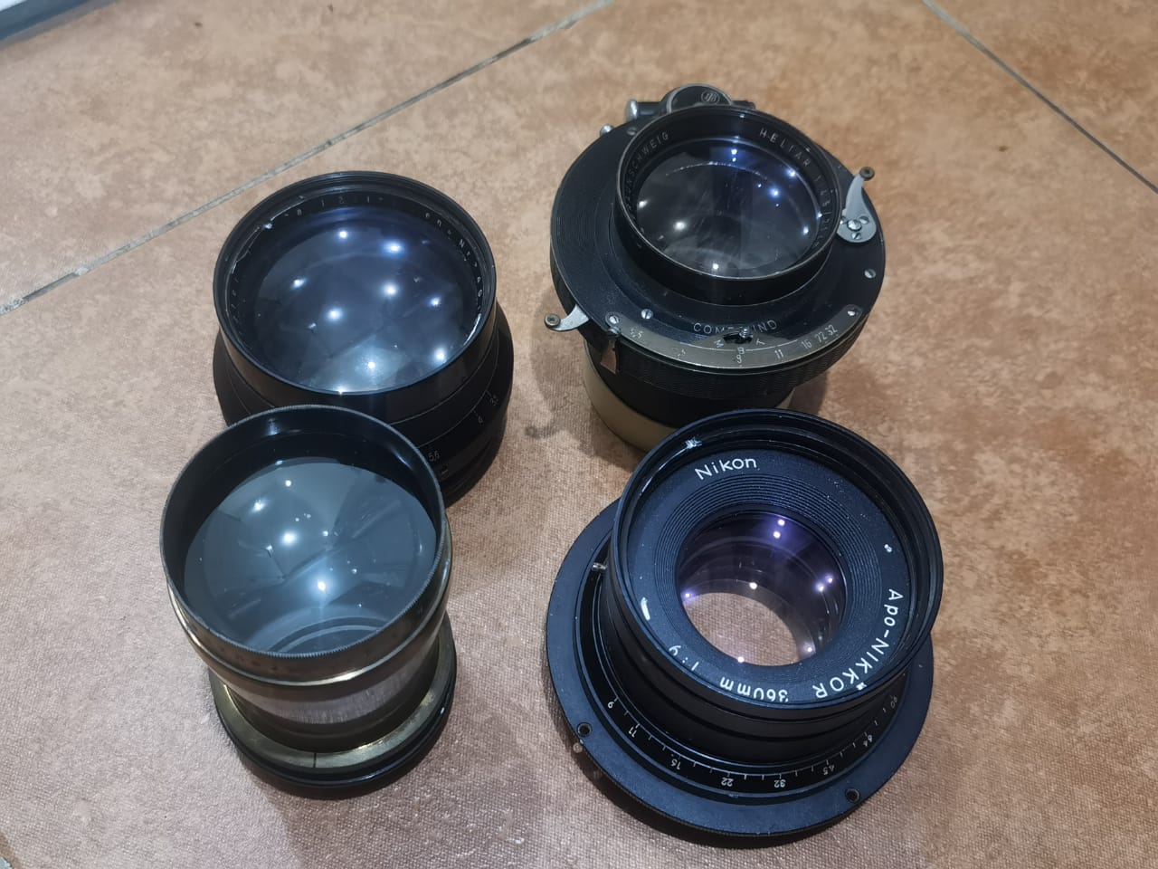

Has anyone own or experienced with these lenses :
1. Carl Zeiss Tessar 21cm f3.5 T
2. Schneider Tele Xenar 30cm f5.5
3. Voigtlander Heliar 21cm f4.5
4. Apo Nikkor 360mm f9
- Is Zeiss f3.5 is a good lens especially wide open?
- What maximum format Apo Nikkor can cover?
Thank You
