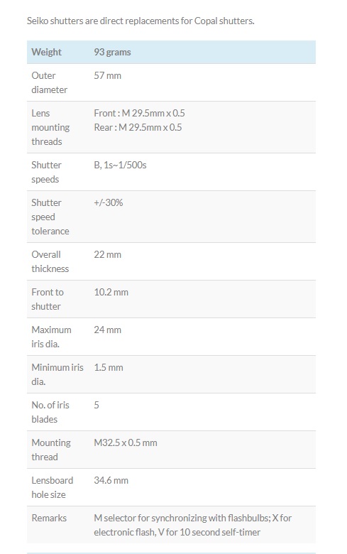

1. Fujinon SW 65/8 Seiko Shutter
I lost the retaining ring, what size should i buy, i measured the diameter is 32.5 mm, is it same with Copal 0?
Mounting thread of Seiko #0 is M32.5 x 0.5 mm, the same than Copal 0
https://www.largeformatphotography.info/shutters.html

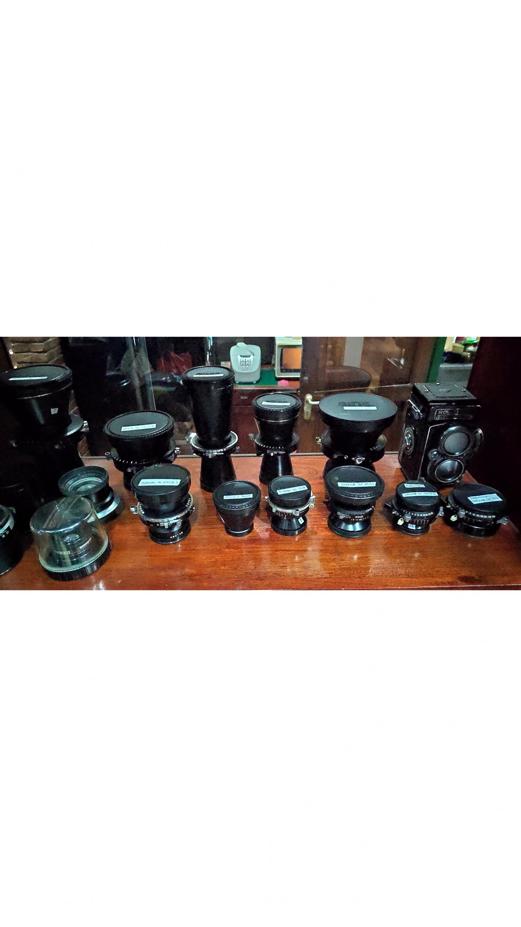

Thank you very much, you always be so helpful and give useful information. Really appreciate it.
Im exploring all the lens at the moment but already know what i will keep.
So far i will keep 90-150-210-300-(360 & 500)

It is a ver well balanced kit, the 90-150 jump is a bit large but no problem, a +50% step would be from 90 to 135, ...but the 150 is the most popular 4x5 focal, followed by the 210
Now this is about shooting film, only time will tell you if you should refine the kit acordingly to your shooting style, anyway many Pros have made their career by using way less glass !!!

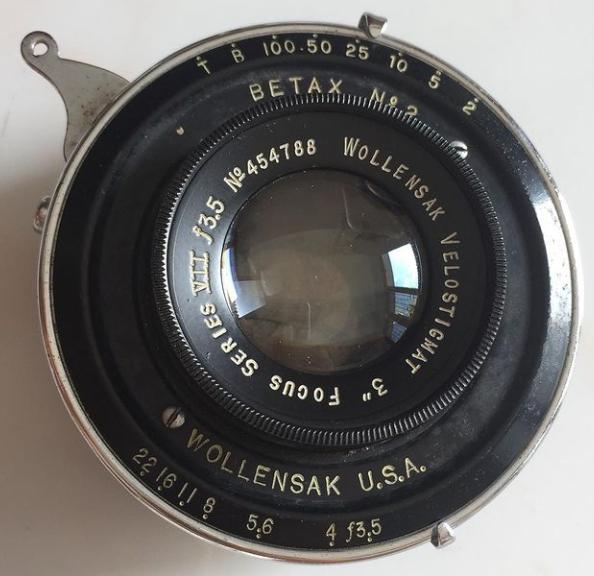

Is anyone know about this lens? cant find much info about it
is it wide angle lens equal 76mm? what format is this lens will cover?
Wollensak Velostigmat 3" Focus Series VII f3.5

135 answers! The Wollensak lens is probably from a 6X6cm box of some sort. It won't cover much more than that. The rest from your original inquiry are Kraft Macaroni and Cheese from a box.
Thanks, that's make sense.
I thought it's for 4x5

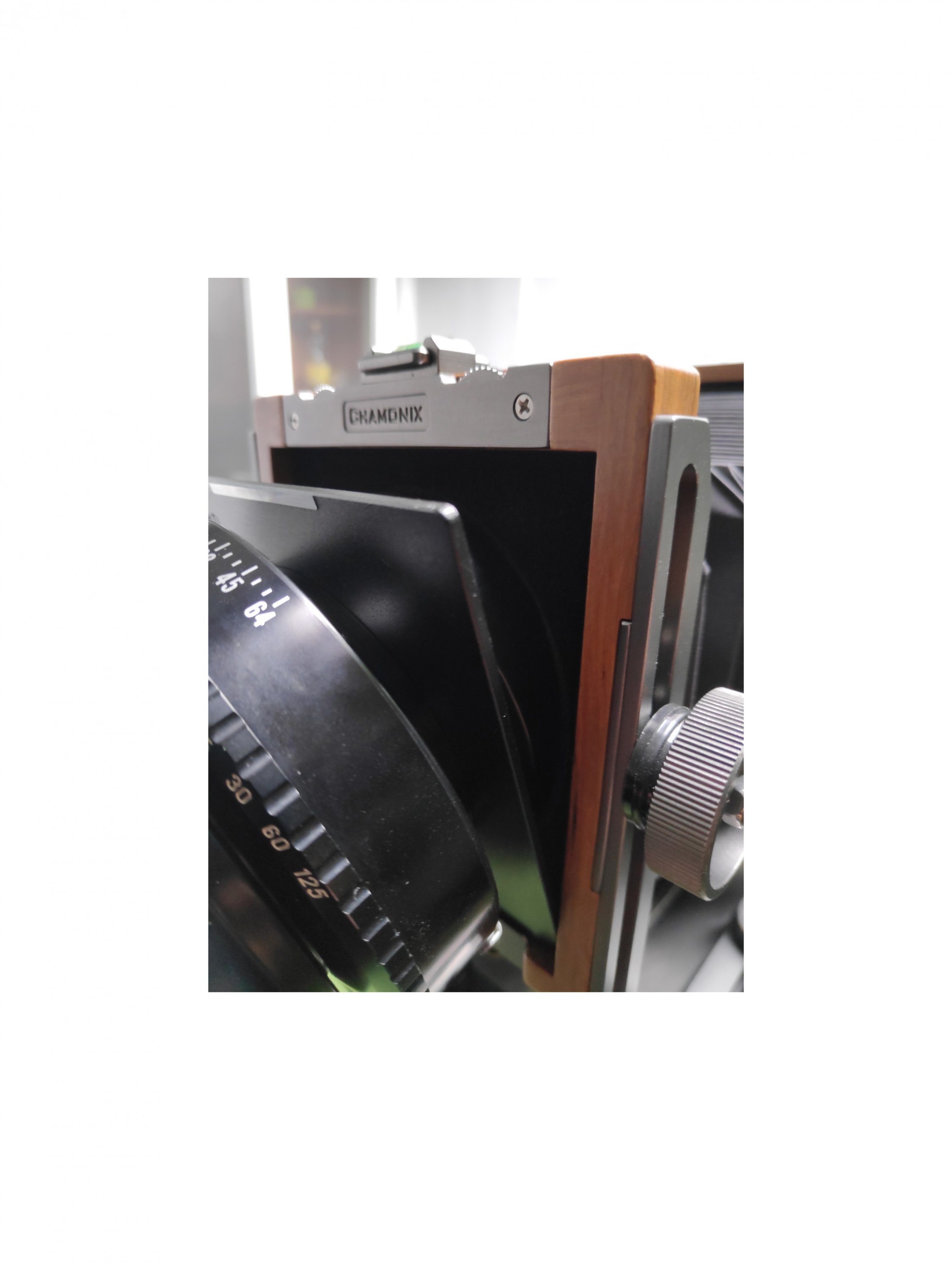

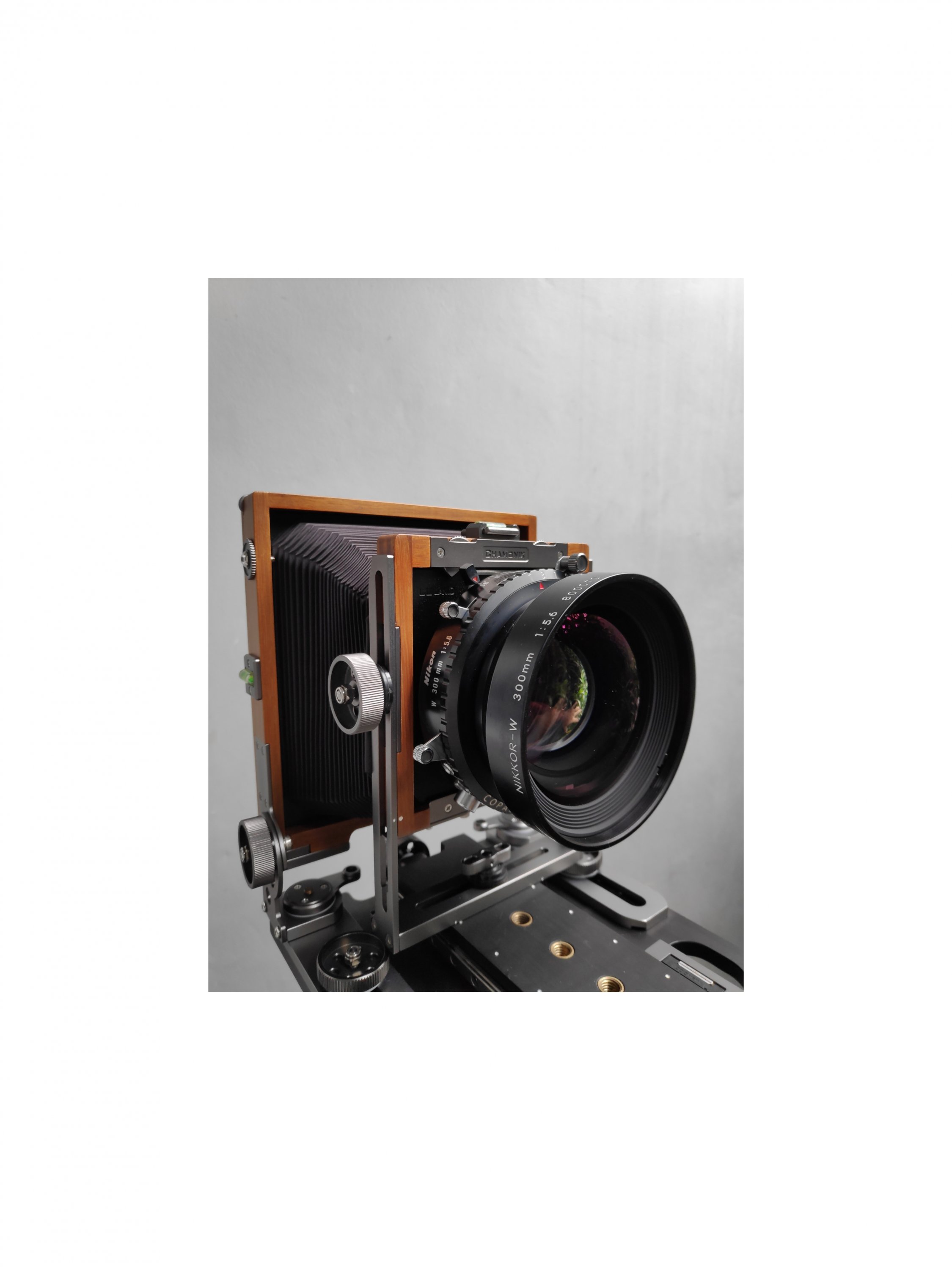

I just got Copal 3 lens board for Nikkor W 300/5.6
But apparently it doesnt fit to my Chamonix N2.
I think the rear optic is too big for chamonix front standard. And the lensboard locking system cannot accept it.
Is it so or am i missing something?

You may try this: Remove the rear cell of the W 300, mount what remains in the front standard, then screew in the rear cell from the back.
Problem is that doing this in the field is a bit risky, but IMO it is no problem if done very carefully, personally to make those those things I put the dark cloth on the camera box, and I put the lens+lensboard on it to remove a cell (convertible symmars...) if not... soon or late a cell may fall to the ground. Also the inner elements and shutter may take some dust, but IMO this is not an issue.

Do you mean rear element is larger than lens board across or larger than opening in the front standard? If so there is no cure as even if rear element is screwed in from behind it will more than likely touch bellows on the inside. And you would be doing bellows disfavor trying to fit a large chunk from behind that is too big for available space to begin with.
No, the rear element is smaller than the openning but for some reasons it can't through in..i try mount the rear element from behind and it works
Problem is that doing this is the field is a bit risky, but IMO it is no problem if done very carefully, personally to make those those things I put the dark cloth on the camera box, and I put the lens+lensboard on it to remove a cell (convertible symmars...) if not... soon or late a cell may fall to the ground. Also the inner elements and shutter may take some dust, but IMO this is not an issue.
Thanks a lot..it works!
Deleted member 88956
Good thing it works from behind, but I don't get how it did not fit through if smaller. I don't own 45N2 but it seems a simple affair to mount a lens board on it from pics of it.
I thought so that simple..but when i tried it, the rear element hit top of lensboard opening and can't get in.

it works!
hmmm... that N2 looks impressive with such a big eye !!!
the W 300 is top notch gear, really top notch, I use the 360 version for 8x10 and I'm impressed... but if has a very large image circle (allowing larger formats) that may generate some flare as rays may bounce inside, specailly if bellows are very extended providing a "tunnel". If the case, you may use a compendium shade to trim the image circle.
Do you think using top hat lensboard would be the best way to use this lens?
Which Nikkor 360, the Telephoto one?
Your camera has 395mm max extension while this lens requires 284.9mm to focus infinite, so you should be able to focus closer than 2m (1.2m perhaps), if I calculated it right (https://www.kennethleegallery.com/html/tech/bellows.php) so you don't need much the extension board for this lens, but I don't know if your bellows are too stretched at max extension, which can provocate internal reflexions ending on the film sheet, so IMO what you should check is if your bellows are long enough, as said, this can also be overcomed with a compendium shade to trim the excessive circle.
The nikkor 360 I shot with is the W 360, mainly for 8x10, and also the W 210 that nearly covers 8x10 and can be it used for that, both are superb. Anyway it's dificult to find a modern LF plasmat lens that is not delivering a crazy good yield. John Sexton exceptional master made most of his work with those Nikkors, still he owned several units of the same model to get top perfomers as there is some variability from sample to sample, for sure me and many would not absolutely notice any flaw in the glasses he replaced, but that variability existed in the production of all manufacturers.
