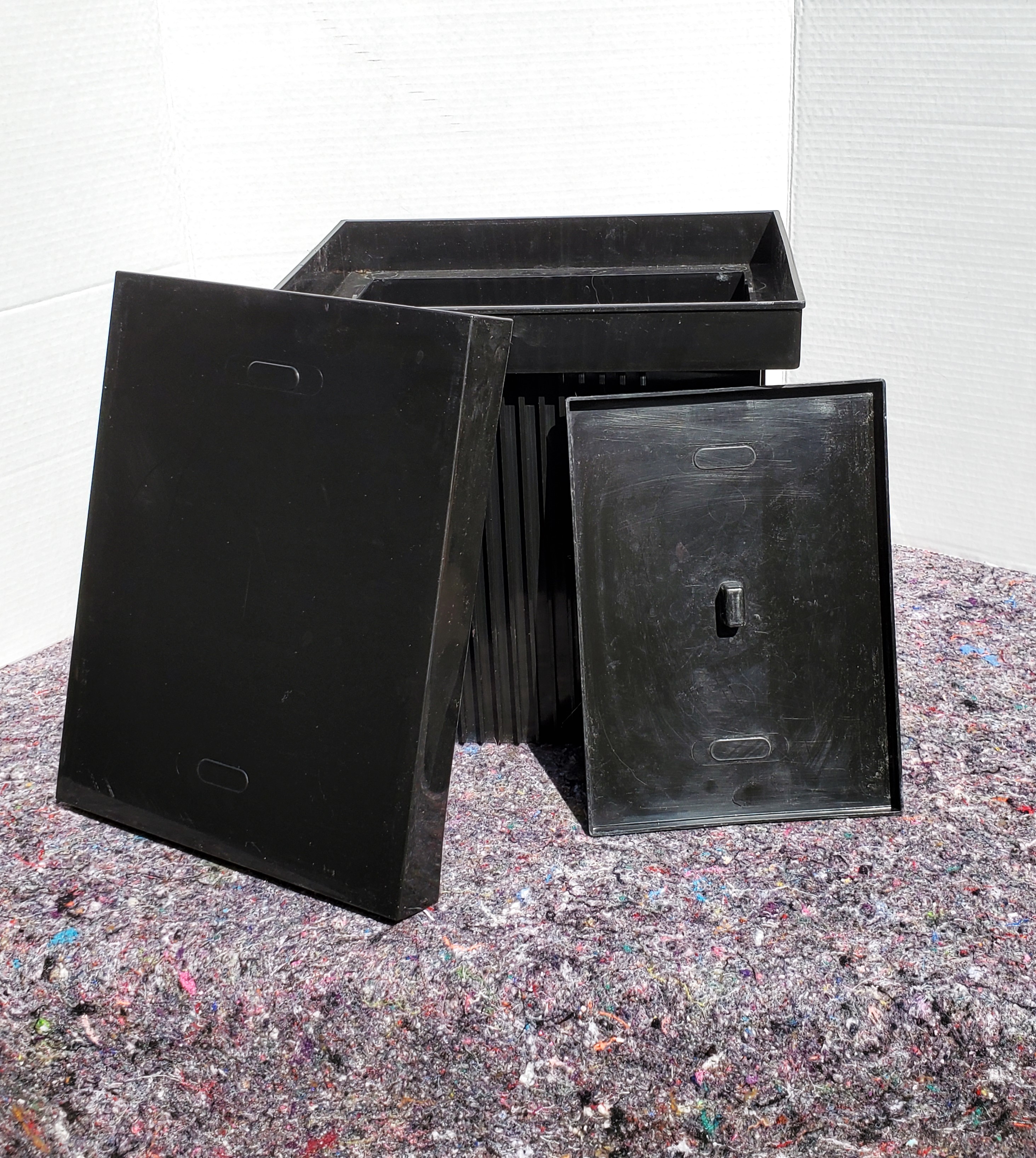

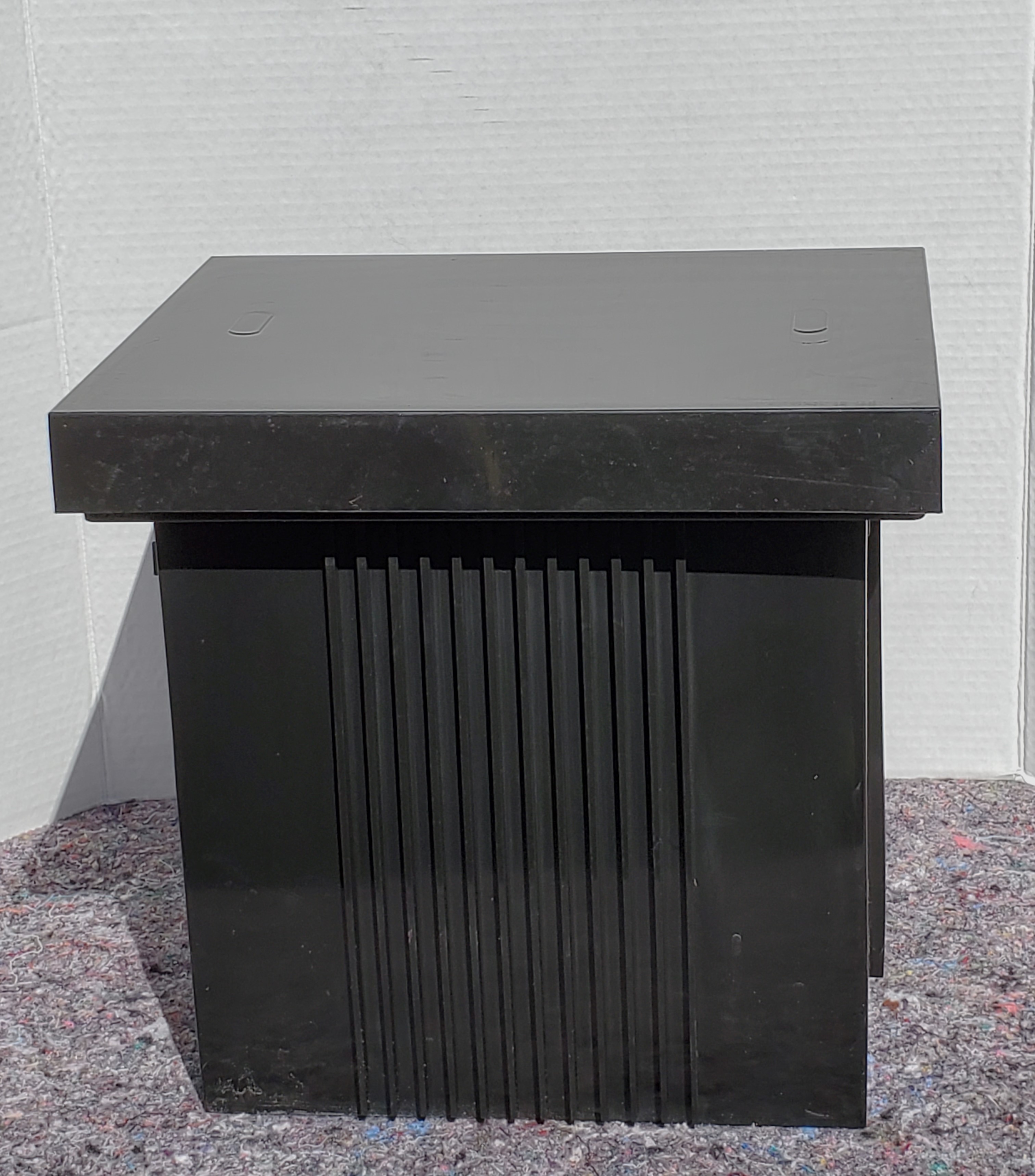

I was thinking of the Cescolite 8x10 Film Developing Tanks. They are a standard size so I would think the Arkay type racks would fit them. They have a floating lid as well as an overhanging cover that would allow you to move it daylight. It is unfortunate that you are so far away as I have a number of these tanks that I have for sale. Your next best bet would be the older Kodak 8x10 Tanks but they are heavy and have a floating lid but I have never seen one with a light tight lid.
