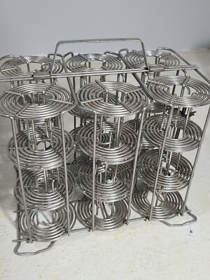

If you snagged this pair of Arkay Nitrogen Burst racks with reels, you might be able to whip-up a homebrew system to process 36 reels at a time.
It would take a bit of work to make the tanks and you'd have to process in total darkness, but...
EDIT: Scroll down on this page to see how the original nitrogen burst sinks looked. This is for a long gone auction:
It will "only" process 18 rolls of 120/220 per run. But it was completely doable (and I did it) but that's a big investment to catch up only a "few" rolls of film.
