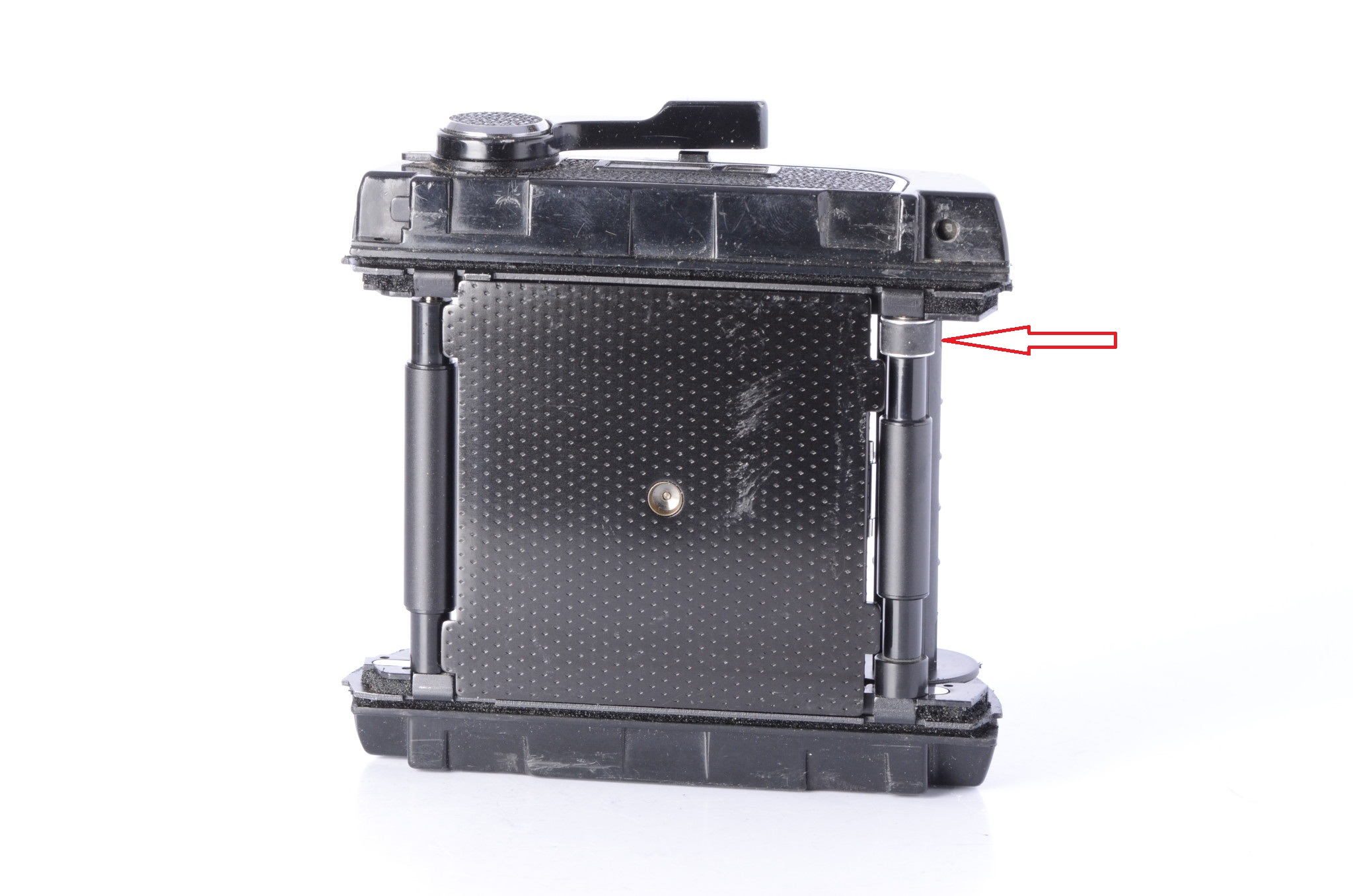

Good luck! For the 220 ProS back that I'm using, I made a slight modification so it would work perfectly with 35mm film. In this picture attached, there is a small wheel with rubber covering it that drives the shot counter. (to the left of the red arrow) It's not directly connected the cylinder below it that rides on the same metal pin. So when the 35mm film rolls over the cylinder its not driving the counter wheel like 120 film would. So I super-glued the two together so that the 35mm film drives the counter and I can keep track of how many shots I've taken. Without that step, you have to keep count in your head or on paper, until you get to about 17 (with a 36 shot 35mm roll). Much past that you run the risk of losing a shot or two. You could get more if you save some 120 backing paper and a spool and use that as a film leader to save on 35mm film. This is with the ProS back, so not certain if it applies to the RZ back. You'll just want to check.

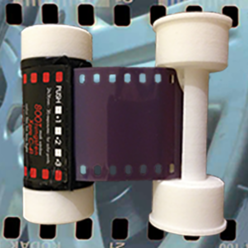

Just to be certain you understand, this is what the adapters look like. You treat the 35mm film like its 120 film - leave it in the canister to start and the take-up spool pulls it out of the canister as you shoot.
Some of the offerings on eBay don't include a take-up adapter, and expect you to use a 120/620 spool.
Some way of dealing with take-up is useful.
A re-loadable 35mm cassette with adapters will allow you to (in the dark) simply cut the film after the last exposure. An uncovered spool will require re-winding in the dark.
