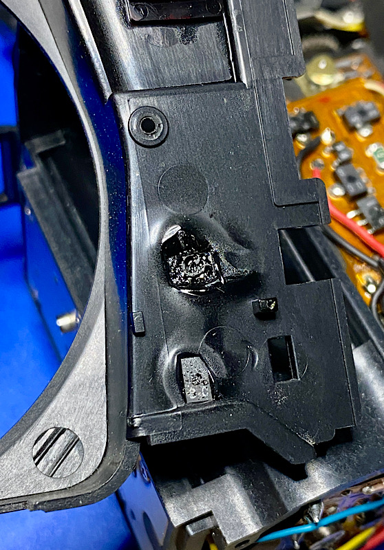

Only with the Minolta 7000 AF seems to have been a miscalculation in the dimensioning of the transistors in the motor control; even the service manual mentions this.
It looks like this:

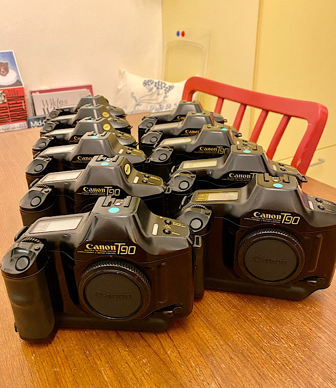

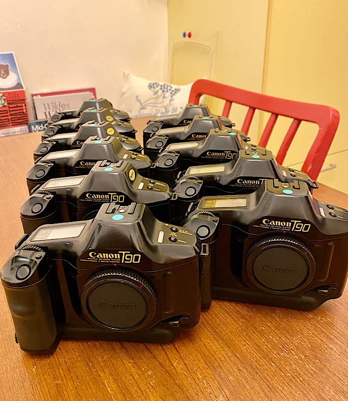

oh, it's you who bought all the T90's on the bay! Great collection! 😃😉
You must be a happy man indeed. Sorry for the other Canon T90 shooters out there...
