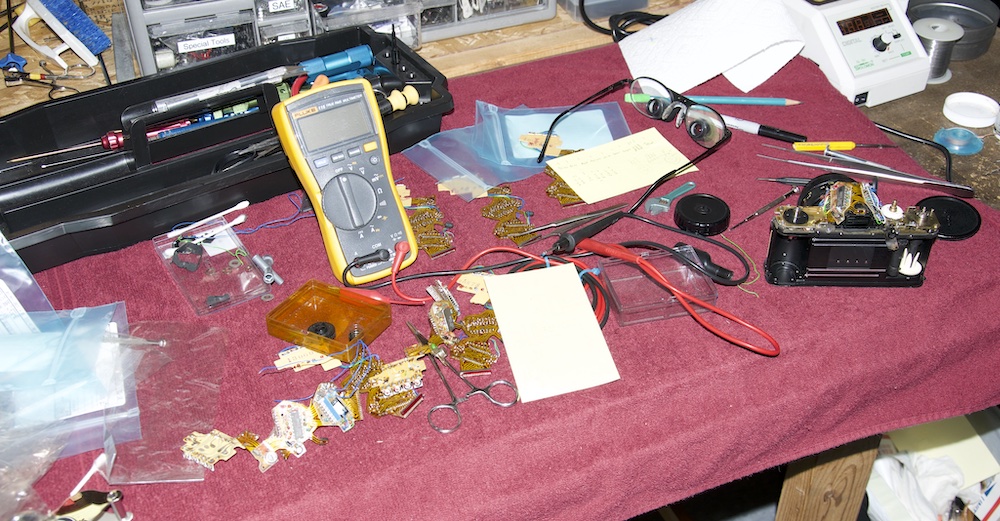

Even with a stash of NOS main boards, repairs can be futile if the NOS boards have developed the same faults as the ones in the cameras :sad:
What‘s wrong?
Not sure. The common fault with the camera is the auto exposure does not work, but in manual the correct LED lights up for the speed. This is associated with failure of the battery check light and failure of the self timer. The replacement boards seem to have the same faults. For example a camera with only one of the faults developed all 3 after it got the NOS board. Swapping back to the original board and only the original fault was present. So it was not something in the camera body. Board swaps were 6 hours each. After 4 times I gave up.
I also gave up on these SL35E because even the ones with working meters and battery check lights have high speeds that fire almost randomly. That is a separate issue that is not solved by total disassembly cleaning of the individual blades.
After hearing Koraks remarks about tantelum capacitors, I looked at it again, but the faulty area does not have them.
I'd gladly send to you one of the NOS boards if you want.
