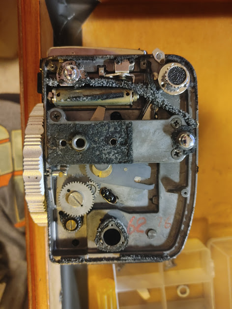

Hello! First time poster here, so please let me know if I'm posting in the wrong category or something :smile:
I'm a college student getting into medium format. I was looking for an SLR, so naturally I kept my eyes peeled for a Kowa Six. I got one that's in very good cosmetic condition, but has some kind of shutter issue. The lens comes off, the mirror is down, the shutter counter is at zero, and the winder doesn't budge. You can press in the shutter button, but it doesn't trigger anything (shown in the video).
I found an old forum post saying that you can try to manually move the mechanism the lens' pins go into with a screw driver, but I haven't had any success with that as it's stuck solid. I've takes both of the sides off the camera to expose the gears, and it looks like a gear that should have tension against the shutter button isn't coming into contact with the button. (I understand this is a common issue with Kowa Sixes.) If anyone has any suggestions or recommendations on steps I could take to troubleshoot this, help would be really appreciated.
Another question I have relates to the side of the camera without the winding crank. Under the metal cover, there is some pieces of foam that have deteriorated a lot over the years, including one segment that stretches horizontally across the camera.
I'm planning on cleaning it up and replacing the foam, but I want to make sure that this is just light sealing foam and that it doesn't serve some mechanical purpose.
Thank so much for the assistance!!

Welcome for posting and bravo for the Kowa 6, I was told that some repairman don’t accept this camera due the unreliability even after serving it...
Anyway I had no idea about it until I tried myself with one 6MM.
Here is the link for some photos and explanations, I had the camera in better shape, it could wind, cock the lens and fire, it only needed a good cleaning in the mirror side panel.
As yours, the foam was literally falling apart and it’s only for avoiding light leaks, you can get a thick new foam and replace the parts you remove.

I admire your ambition in trying to repair the camera, but reading thru the manual first would have been time well spent. You should never try to fire the shutter with the lens off. Because it is a leaf shutter mounted in the lens, as opposed to a focal plane shutter in the body, it is necessary that the body and the lens be kept "in sync".
From what I can see in the video, it appears the shutter mechanism is set. Try remounting the lens and then see if the shutter fires. You may need to make sure the the pins on the lens are rotated fully counter clockwise to align with the red dots. The manual does state that there is an interlock to prevent the lens from being removed if the shutter is not cocked. I don't see a mention of an interlock that prevents the shutter from firing if a lens is not on, and I'm not going to try to do that with mine.

I've repaired a few Kowa Sixes in the last few years ( with some shutter leaf parts from Ross) . On the bottom of the camera ,
where the tripod thread is , there is a plate with 4 screws . Under this plate is the main spring that assists in the firing of the
shutter . The spring in the lens is very weak and needs this assist spring . If the mechanism attached to this spring is possibly
seized , nothing will move . This mechanism works through a 90 degree gear set . Pm me , I think I still have some pics of what
to expect . Also the winding mechanism will work and fire without the lens attached . On the winding side there is the plate with 3
arms and the winder shaft , the gear that fails ( and sometimes jams ) is underneath that plate . I had to make a tooth from a carbide
table saw blade to repair mine . Hopefully yours isn't that bad . I own 3 and love them all , even if 2 of them drove me to drink ( not a
long drive :smile: ) to finally get them working properly . Peter

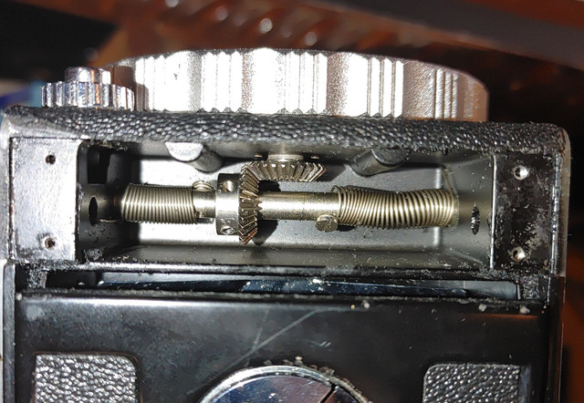

First, let me say that I am very glad you saw this thread! Just the other day I saw your post in a kowa related thread from a few years back, and I nearly pmed you directly but I wasn't able to since my account is brand new :getlost:
I went ahead and opened up the bottom of my camera and the mechanism in there is as stiff as can be-- I'm not getting any movement what so ever when I attempt to wiggle the gears a little bit. It's all greek to me though, so here's a photo.
Any suggestions you might have would be a huge help!

That's slightly different from the Super 66's . I'll try and remove the plate from my one Kowa six and get back in a day or so .
Weather here is great and the motorcycle is calling me :smile: . Peter
I'll check to see if there's any play with it cocked and uncocked .In your picture the top bevel gear has another straight cut gear on it that
drives the plate( the one with the 2 holes) that cocks the shutter in the lens . If any of these shafts are seized it'll prevent the
shutter from releasing

You won't believe this-- I fixed it. And all I had to do was pull this little lever.
Ozy6zREXPteRhzmZzxfxZfLHFkqXLROt4G5Ov3eO2s6vHFMmogKB51GeTSG8TmeBeVhieQAJtSN_IMs1aPuAta9eRbEPpAtbgwNqF9bRZpYq9NYbAV-4Hp9FuDfPVDuHeRXU5Ic2bIhKZ37bK0R-9DYmgmW8Oou_sCnn7RV3t1tQSyn_0Wpob-Xce-QKTgm2ZAFOtRKmbJEVffePRbFcUbYQSNEgPq3bH0oUoih53XInE0RIHqNEfGAVn6C70nYZ5cXl8S4ig7BVV6ihwYXUxu8_I6Zv0J62RYZRUTobQhZ-jagFV9RR9e-KAV0rmftYLv3zTbIkvQzswQsequ7DE5XGcwyEw20Bs31pxw4QXNyCE2f9yvKHnkXPsv0u0XY4XUpS28NKuS6eu2cIU9kEesWUXQ0DuGDtbMMa9R-IuTBUFeQWGYZej7jeXMsh4Doog5rrqRLMwbVan1mAsnFy8_OCFB_A9LFmyk_onDlxGzlLbSmtwcuPDG3rFD4mtgf8FeWjDu7EKU6A0BLDNncwzKrOeERt2U50531FLpNti06EuUmcxyUsj6jhQkM-DG1cbbn1BvAtSNMZ49DlNF3UAfe1fBrdM0XXqDKch4kNKzT8KYA04FwVS_J7itZdMSh5yiQg3LMPzj-_2tHZrEiaSrIzVF9PbDK-G_maZ0FoWbf8IEvstH_lRe7oB_HT400z0VYtm1h3CK4BjOb2ideHd1Bc5g=w952-h815-no
Seriously, that was the issue this hole time. It looks like it was stuck to the gear it couples with, preventing anything from moving. After I unstuck it, with a click everything else fell into place.
Thank you so much everyone for your help and assistance-- let's keep kowas alive! :smile:)

What do think cause the lever to jam in the first place?
I'm not sure, but it looks like there was something on the tip of the lever that was causing the trouble.
After putting everything back together, it froze up again! I ended up taking the cover off again, but it turns out opening up the film back fixed it! I had moved the 120/220 film lever after firing the shutter without even thinking, so that was my fault.
I'm going to try to track down some similarly sized screws so I don't have to deal with the originals, which are pretty roughed up at this point :D
