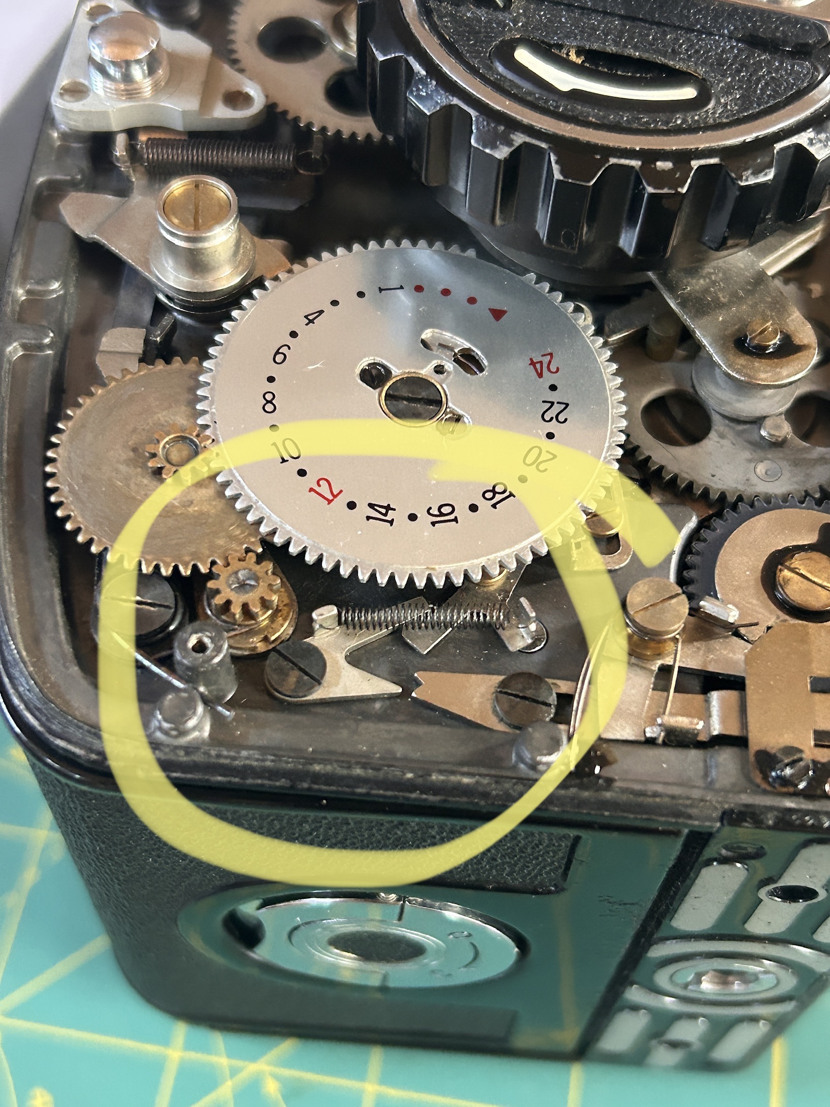

Thanks for all of your information Jeremy. I figured I'd give it a try. Hopefully I won't destroy the camera and at the least Ill learn something.
I was able to open the camera. Here are a few photos of what I found. The film counter does seem to jam. When it jams the shutter button actuator doesn't line up (see picture). If I spin the film counter (without film in the camera it recreates the jam as well).
Any next step suggestions. Thanks for your help.
Photo 1: Jamming position of shutter button actuator (yellow arrow)
Photo 2: Position of shutter button actuator aligned properly (green arrow)
Photo 3: The position of the film counter, springs, etc when it jams

Thanks Jeremy,
I haven't done that yet. Is there a write up already on how to get the lens on and off and fire it (ill look back in the thread but didn't see it first glance)? That would be good to check.
I think I may have just figure it out, not sure. But when I help this little spring along, the shutter button actuators fall into the correct position. I think the spring is just worn out.

Not certain if the lens is contributing or not, but ruling out possible causes is always good when trying to sort stuff like this out.
To remove the lens, its preferred to do so with the entire system in the cocked state.
There's a breach lever near the lens on the non-winder side. Pull that back. Then turn the silver collar on the camera that holds the lens on counter-clockwise (when looking at the front of the camera) until the red mark is at the top. The lens should then come off.
To fire it, there is a small pin you depress while gently giving the two rotating pens that are opposite each other a slight nudge. To cock it, move the rotating pins back to their original position. If any of that doesn't work or it has issues, that could be a culprit here.

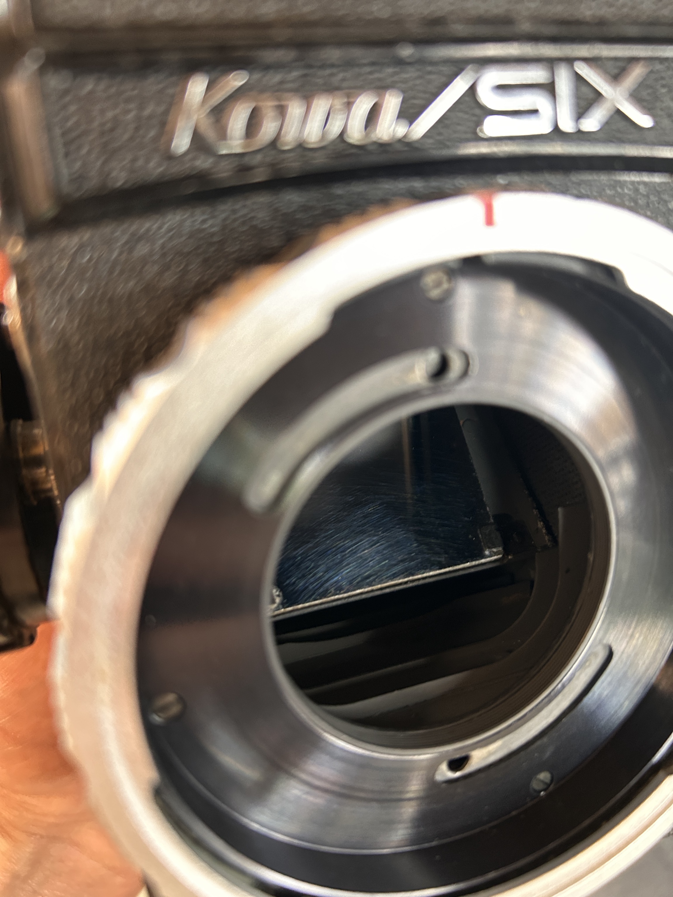

Hello! First time poster here, so please let me know if I'm posting in the wrong category or something :smile:
I'm a college student getting into medium format. I was looking for an SLR, so naturally I kept my eyes peeled for a Kowa Six. I got one that's in very good cosmetic condition, but has some kind of shutter issue. The lens comes off, the mirror is down, the shutter counter is at zero, and the winder doesn't budge. You can press in the shutter button, but it doesn't trigger anything (shown in the video).
I found an old forum post saying that you can try to manually move the mechanism the lens' pins go into with a screw driver, but I haven't had any success with that as it's stuck solid. I've takes both of the sides off the camera to expose the gears, and it looks like a gear that should have tension against the shutter button isn't coming into contact with the button. (I understand this is a common issue with Kowa Sixes.) If anyone has any suggestions or recommendations on steps I could take to troubleshoot this, help would be really appreciated.
Another question I have relates to the side of the camera without the winding crank. Under the metal cover, there is some pieces of foam that have deteriorated a lot over the years, including one segment that stretches horizontally across the camera.
I'm planning on cleaning it up and replacing the foam, but I want to make sure that this is just light sealing foam and that it doesn't serve some mechanical purpose.
Thank so much for the assistance!!

Next question would be, has anyone ever liberated the lens/shutter assemblies from their housings, and mounted them on a helicoid on a Graflok back, or some such. The 35mm and 40mm lenses especially would be cool, to say nothing of the 19mm. I have just enough Graflex rollholders left to make it worthwhile. Oh well, a guy can keep daydreaming.
Those Kowa lenses you mention above are super rare and not exactly easy to find, and when they do pop up, people want crazy money for them due to their "rarity".
I wouldn't pay the asking price.
