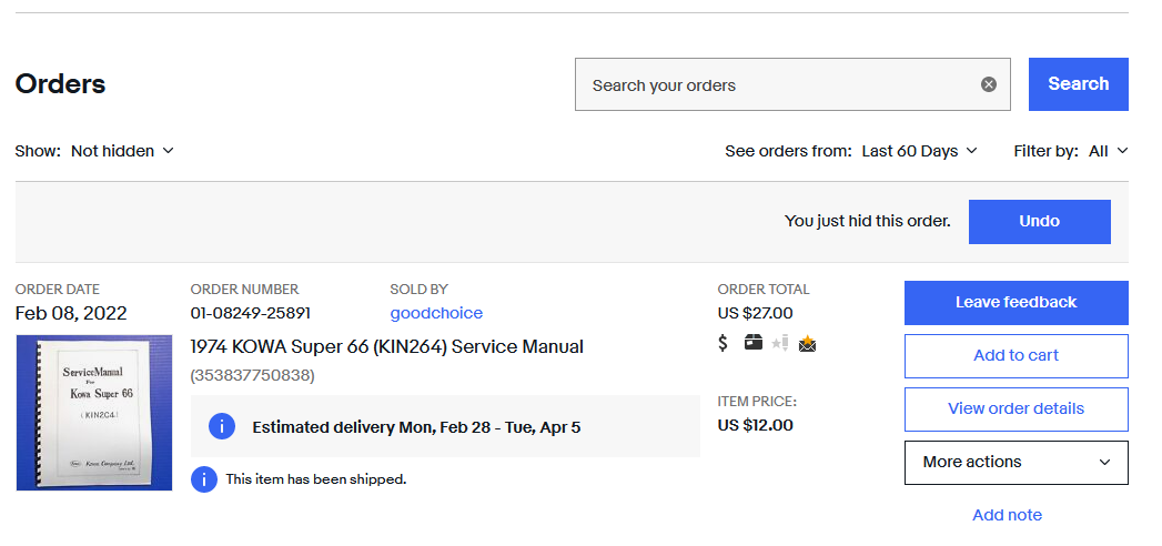

Jeremy, would you be so kind to send me a pdf of the manual? I already buyed this manual on Ebay but they refused to send me a pdf and now i should wait for the mail for 2-3 weeks
yeolde
Jul 1, 2019
36
Saint-Petersburg
Med. Format RF
Here is the proof ! We are hardly waiting for this book to come with my repairman, cause kowa not a simple camera... I asked you because there is a chance to start a lens repair after unlocking... is there a shutter explained in the sections?

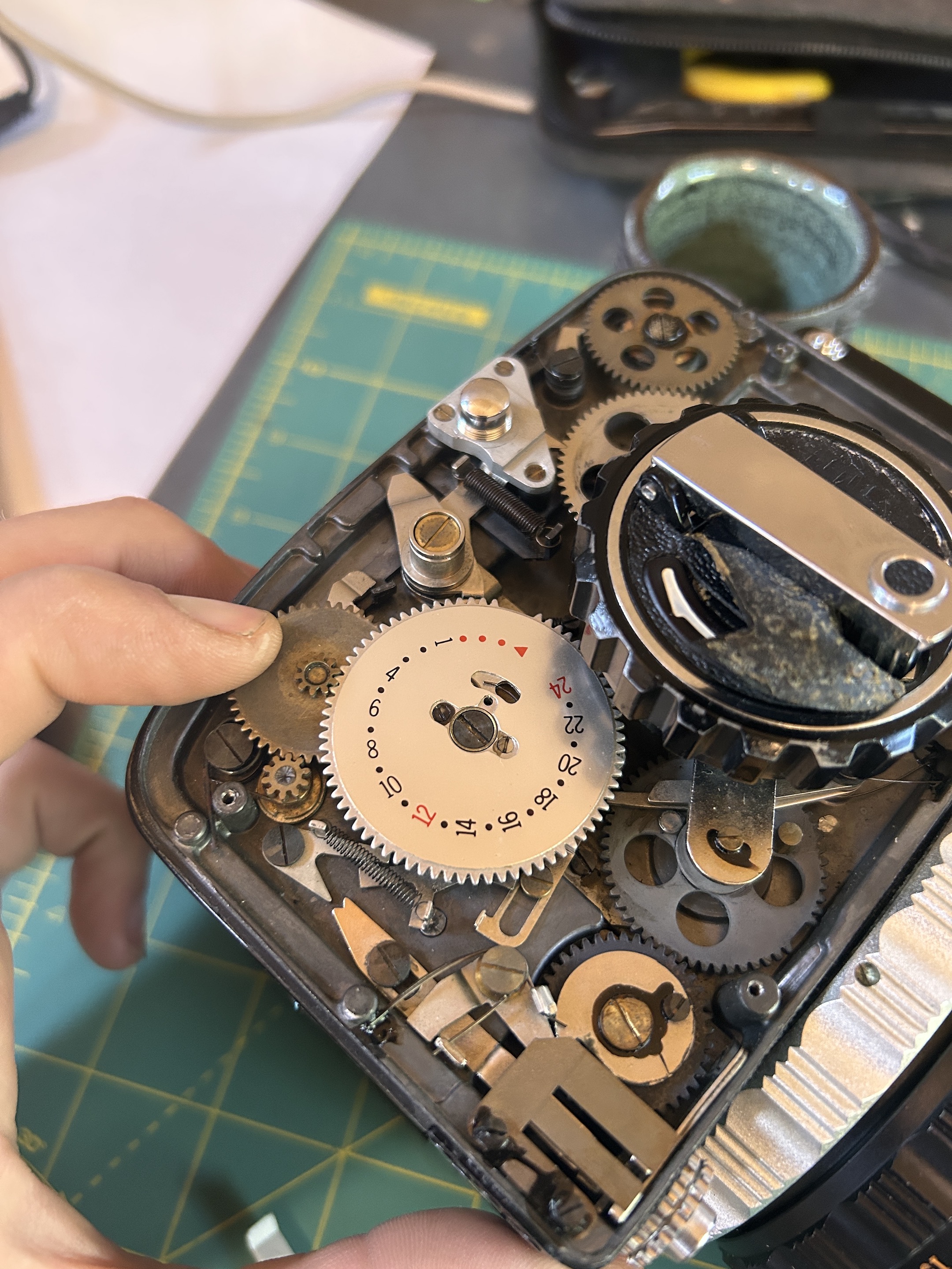

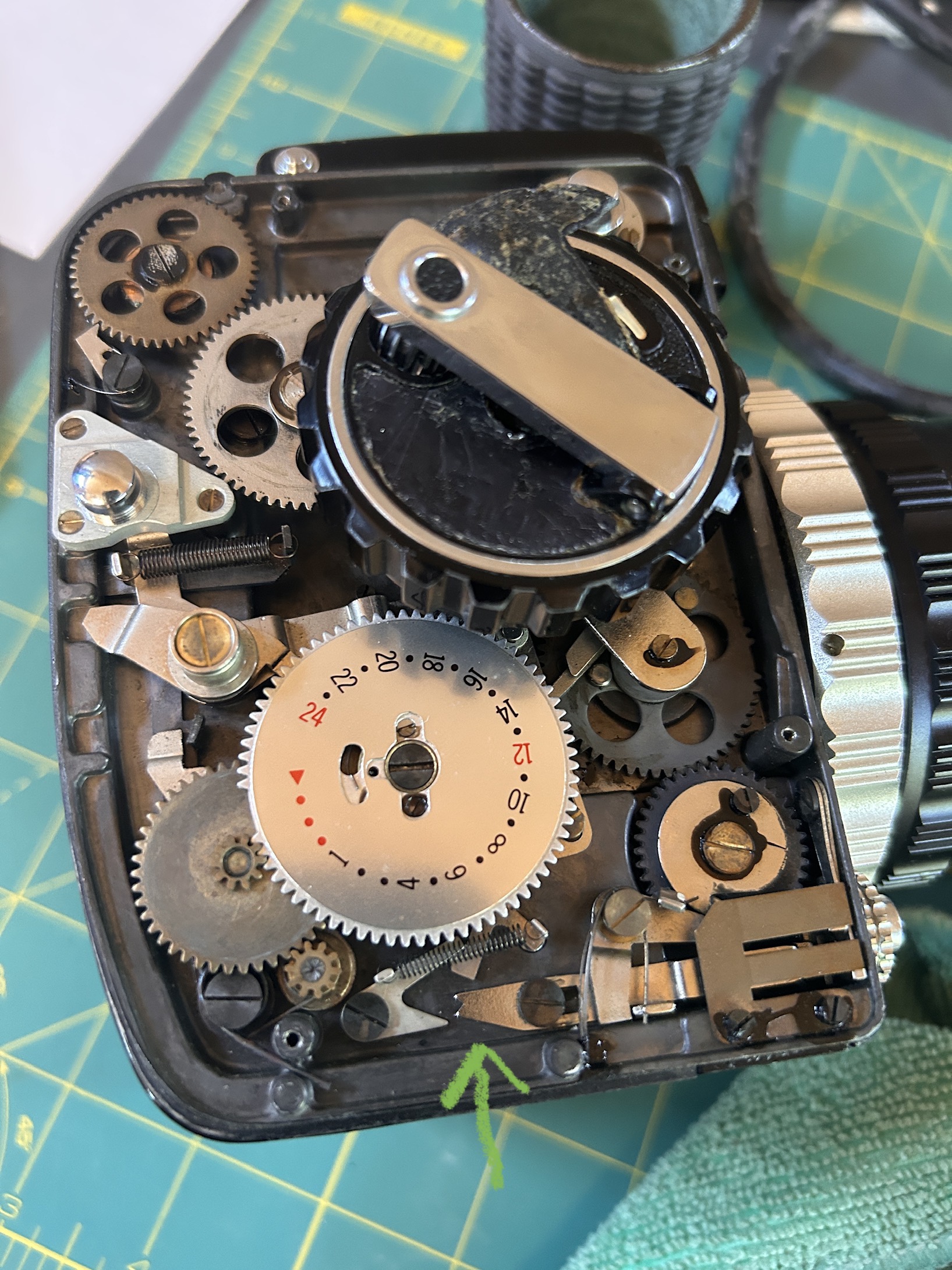

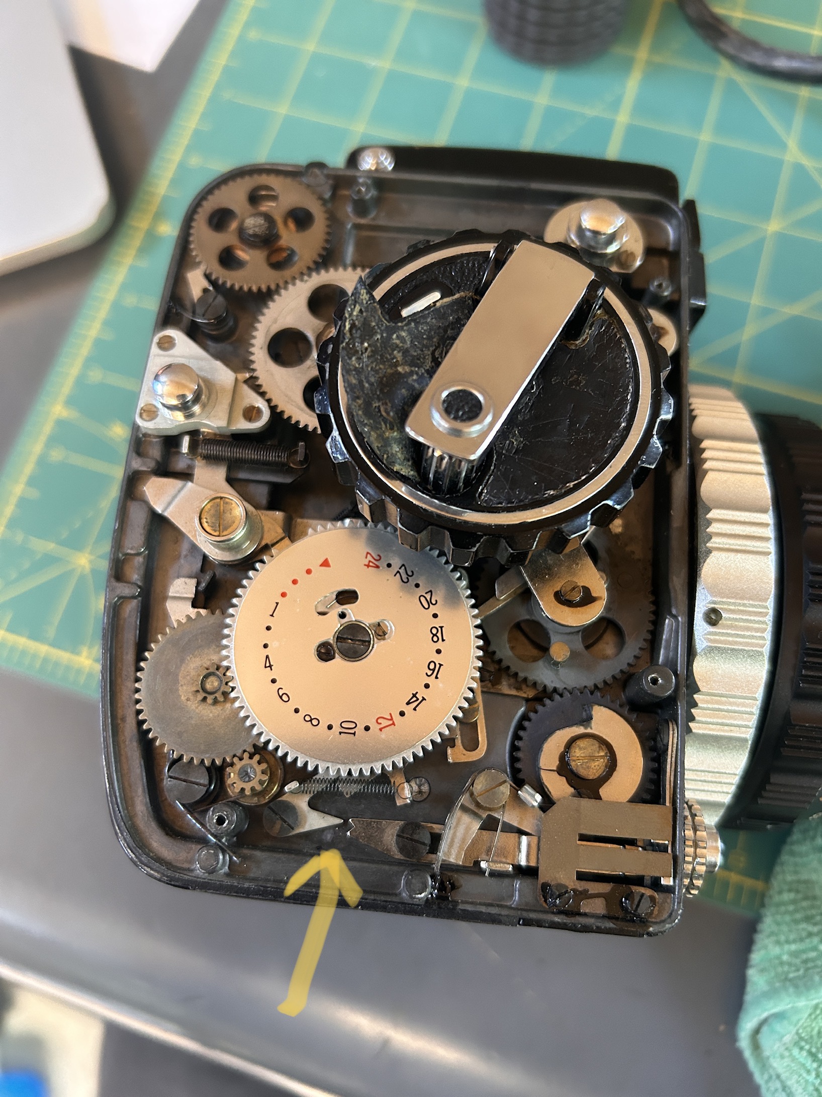

I was able to open the camera. Here are a few photos of what I found. The film counter does seem to jam. When it jams the shutter button actuator doesn't line up (see picture). If I spin the film counter (without film in the camera it recreates the jam as well).
Any next step suggestions. Thanks for your help.
Photo 1: Jamming position of shutter button actuator (yellow arrow)
Photo 2: Position of shutter button actuator aligned properly (green arrow)
Photo 3: The position of the film counter, springs, etc when it jams

You won't believe this-- I fixed it. And all I had to do was pull this little lever.
Ozy6zREXPteRhzmZzxfxZfLHFkqXLROt4G5Ov3eO2s6vHFMmogKB51GeTSG8TmeBeVhieQAJtSN_IMs1aPuAta9eRbEPpAtbgwNqF9bRZpYq9NYbAV-4Hp9FuDfPVDuHeRXU5Ic2bIhKZ37bK0R-9DYmgmW8Oou_sCnn7RV3t1tQSyn_0Wpob-Xce-QKTgm2ZAFOtRKmbJEVffePRbFcUbYQSNEgPq3bH0oUoih53XInE0RIHqNEfGAVn6C70nYZ5cXl8S4ig7BVV6ihwYXUxu8_I6Zv0J62RYZRUTobQhZ-jagFV9RR9e-KAV0rmftYLv3zTbIkvQzswQsequ7DE5XGcwyEw20Bs31pxw4QXNyCE2f9yvKHnkXPsv0u0XY4XUpS28NKuS6eu2cIU9kEesWUXQ0DuGDtbMMa9R-IuTBUFeQWGYZej7jeXMsh4Doog5rrqRLMwbVan1mAsnFy8_OCFB_A9LFmyk_onDlxGzlLbSmtwcuPDG3rFD4mtgf8FeWjDu7EKU6A0BLDNncwzKrOeERt2U50531FLpNti06EuUmcxyUsj6jhQkM-DG1cbbn1BvAtSNMZ49DlNF3UAfe1fBrdM0XXqDKch4kNKzT8KYA04FwVS_J7itZdMSh5yiQg3LMPzj-_2tHZrEiaSrIzVF9PbDK-G_maZ0FoWbf8IEvstH_lRe7oB_HT400z0VYtm1h3CK4BjOb2ideHd1Bc5g=w952-h815-no
Seriously, that was the issue this hole time. It looks like it was stuck to the gear it couples with, preventing anything from moving. After I unstuck it, with a click everything else fell into place.
