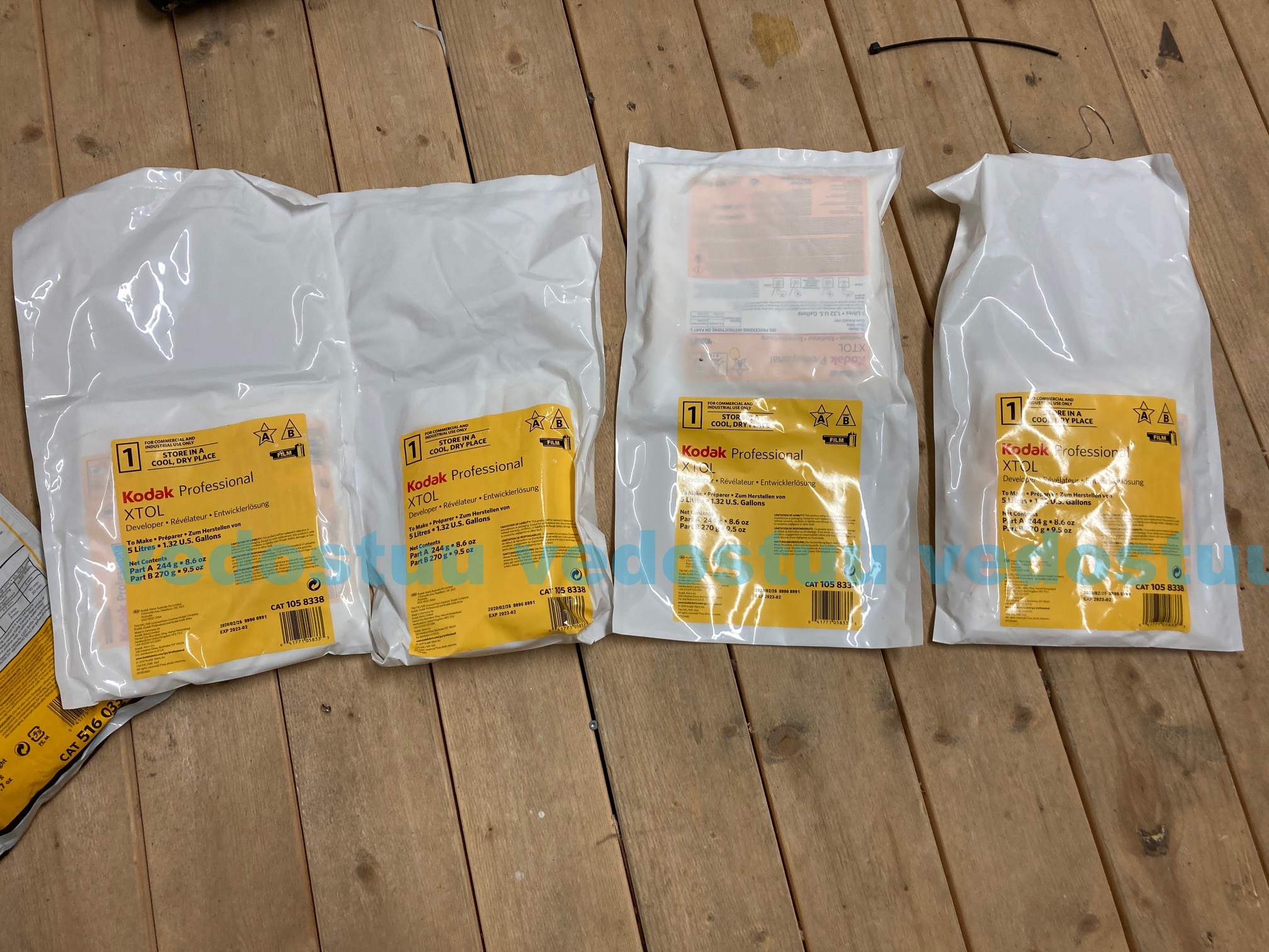

And now I have four bags within the "trade concerns" it starts to get a bit more serious. I have also almost 5l of mixed stock in bottles but I don't know what batch was it mixed from. Nice.
