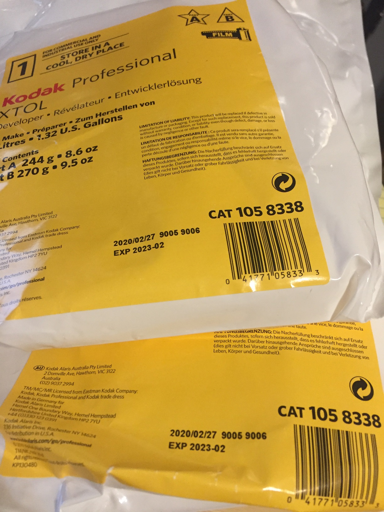

Great. Both bags. *Sigh*

I ordered two bags "to make 5 liters" as soon as I determined Xtol produced results I like (several months ago -- takes a while to get through five liters at 70ml replenishment per roll). Both bags are 2020/02/27 date code. I just sent an email.
