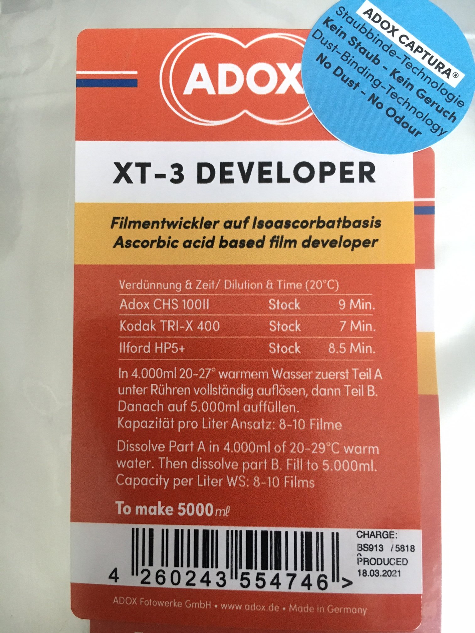

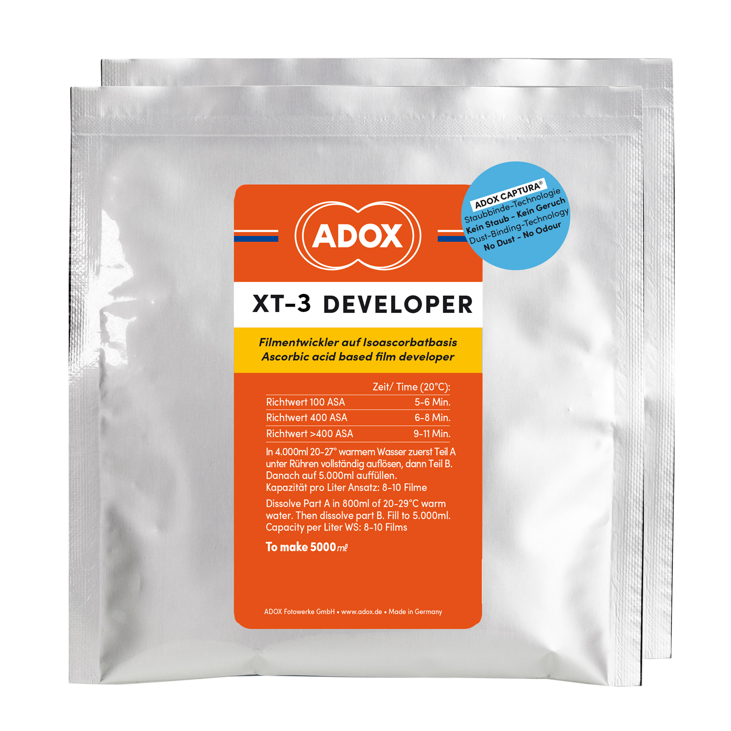

The label looks a little vague on times, showing only 3 sets of dev times with 2 mins margins. Is there an actual leaflet on more specific times and times with 1+1 dilutions as well?
Not a problem if in fact XT- III is very close to Xtol times as Kodak info can be used

"The developing times and resulting curves are identical with XTOL produced prior to 2019 and sold in aluminum compound bags."
https://www.fotoimpex.com/chemistry/adox-xt-developer-to-mix-1000-ml.html
Probably either a printing error, or having some of the powder undissolved when you make up to volume doesn't matter. I'm going for the latter; the reason to mix in a smaller amount and then make up to volume is because the volume increase due to solutes isn't easy to calculate (and depends to some extent on the water source/purity); as long as you don't expect an exact volume after mixing, and make up to the final figure, starting with a lot less won't do any harm (though you might be well advised to make up the final volume in steps when headed from 800 ml to 5 L).
Then again, the only things in D-76 or Mytol that require a lot of water are the sulfite and borax -- and Adox has eliminated the borax/borates, so it might well be that their 5L packet will fully dissolve in 800 ml of water. If so, storing it as 1L ought to extend its solution shelf life by a large margin (don't forget to dilute 1+4 before calculating other dilutions or replenishing).
The mixing instructions look strangely identical for 1L and 5L packages:
  • Mix part A and then part B in 800ml and add water to 1L
  • Mix part A and then part B in 800ml and add water to 5L
Either this is a mistake, or it really does dissolve exceptionally well.
They have already corrected the instructions. That's my bag of XT-3:

This package shot was a mockup from our graphics dept. before the actual product was made. QC inspected the labels before production and corrected the copy/paste typo from the 1 Liter stickers. Ofcourse you dissolve the standard way 800 --> 1.000 and 4.000 --> 5.000.
