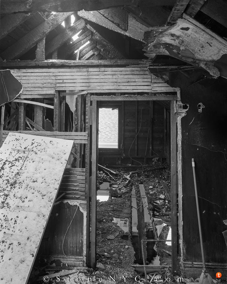

Sure I'll trade you for my 2 family house... It's still worth about $100,000 right now and just needs a little remodeling...

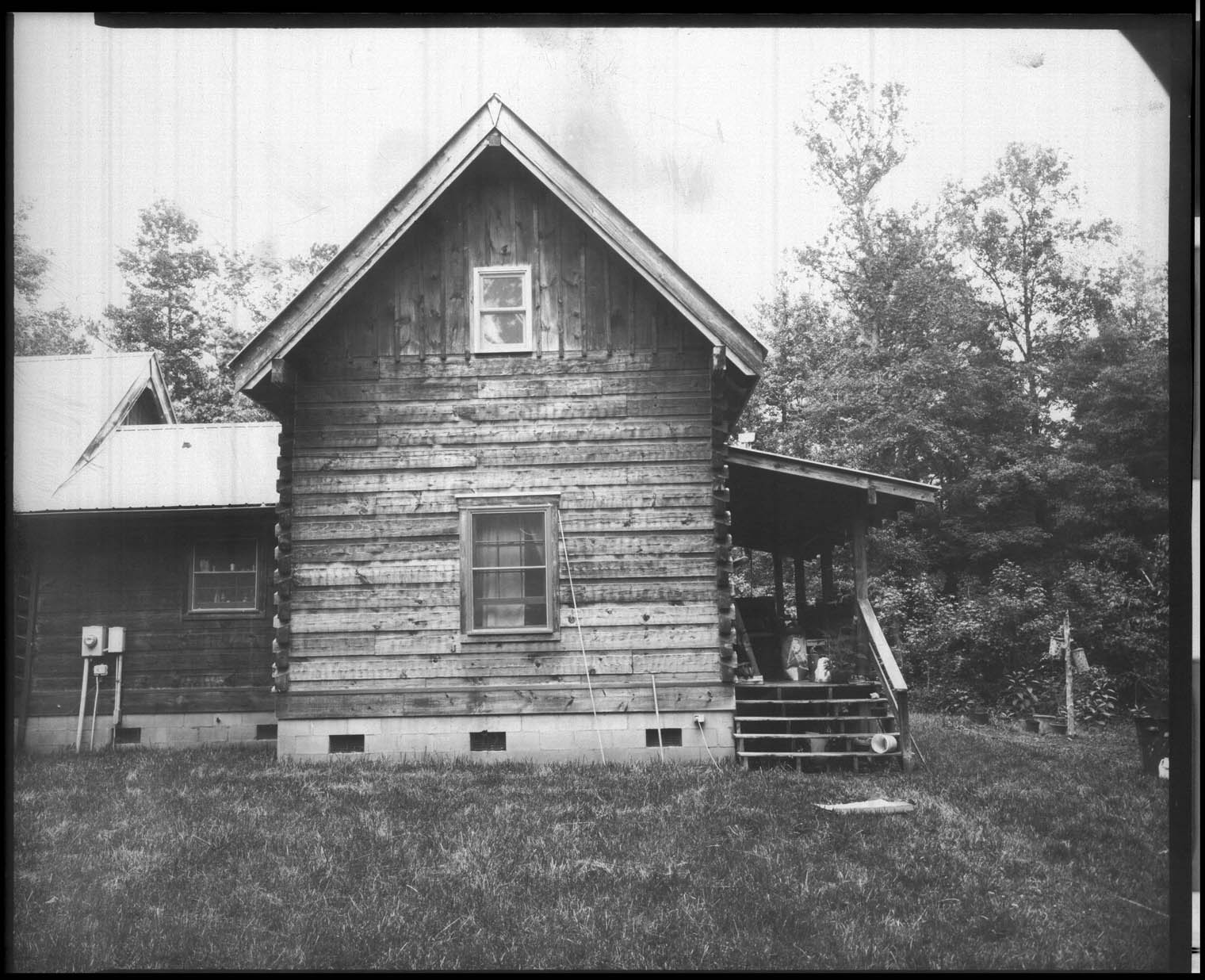

Bad 8x10 paper negative shot on a dreary day of a beautiful Bob Timberlake 16 year old cabin. As for moving up north, I don't think so. Northerners move down here every day, but when is the last time you heard of it happening in reverse? You people freeze your keisters off up there.8x10 copy.jpg

Wow, that could be from my collection. It instantly brought the smell back.

Bad 8x10 paper negative shot on a dreary day of a beautiful Bob Timberlake 16 year old cabin. As for moving up north, I don't think so. Northerners move down here every day, but when is the last time you heard of it happening in reverse? You people freeze your keisters off up there.View attachment 85187
Ok I accept let's trade :wink:
Yea I had to wash everything it was stinky...
No one was hurt and nothing important was lost. So all is well in my world despite, and I got some cool images at least.
