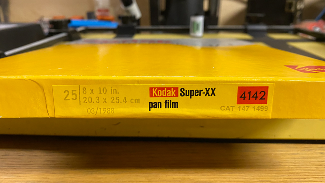

I recently bought some stock from a darkroom thaat was being closed out, and among the things was some Kodak Super XX dated 1989. What would be a good use for it? Is there something it particularly excels at? Would it make a good pictoral film? I think it was being used a duplicating/copy film.

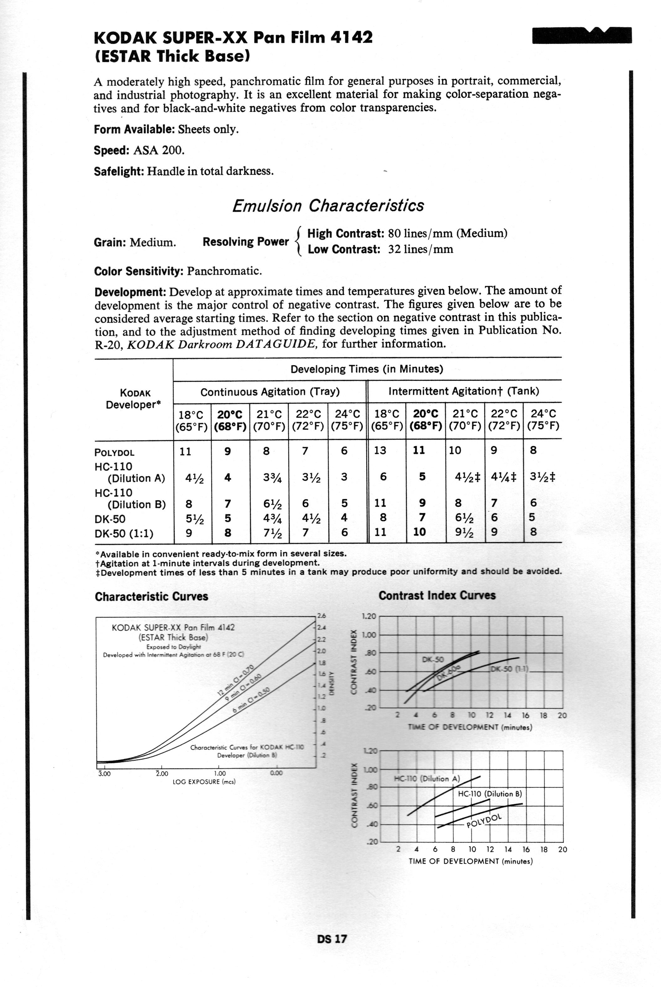

FWIW, my 1970 copy of the Kodak Darkroom Dataguide for Black and White lists Super XX as a continuous tone film with the same ASA 200 for daylight and tungsten illumination, offering fine grain and medium resolving power. The Dataguide recommends a number of common developers, including stock D-76, but not D-76 1:1 or Microdol-X. The development recommendations call for as much or more development as any other Kodak sheet film.

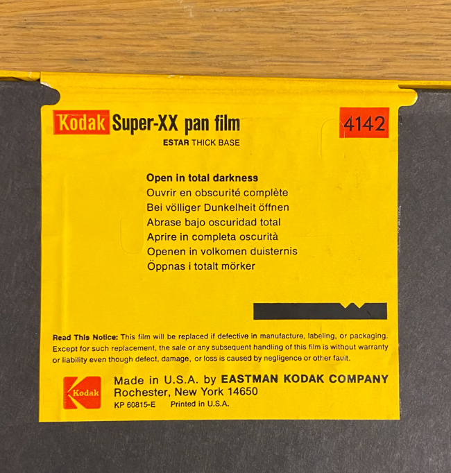

Is there a # on the box? For the sheet version it was 4142 (ESTAR thick base). I assume the 35mm had a thinner base.
T
Don't you think it's time to thaw it out?
There's numbers on one of the box flaps that shows "1-KPC 32652D"
This is the film I have. I'll have to test it.

At 8x10 and with a 1988 expiry date, I wouldn't worry much about it unless it was stored in blazing heat.
It came from a government lab, so I'm assuming it was stored properly. No more than 20-21°C I would expect.

All kinds of developers work with it. HC-110 and DK50 are specifically shown on the data sheet because those were the routine choices in commercial dye transfer labs.

I have 3 boxes, so I can always try some and keep the rest. 2 sheets came already loaded in a holder, I might as well try them first.

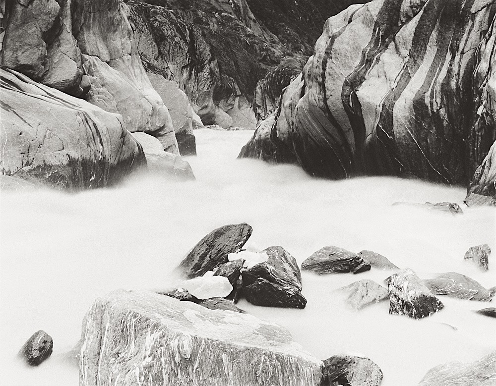

For some odd reason which I don't remember, I took a box of 4x5 Super-XX with me to New Zealand in 1986/87. I used it after I went thru my box of Royal Pan.
The vertical of the glacier face was on Royal Pan and the next day I took the horizontal looking down river from about the same spot on Super-XX. Same camera/lens. The horizontal (Super-XX) was taken with a red filter to extend the exposure time. Both prints on Ilford Gallerie glossy, grade 3, and a long time ago.

Not surprising, Vaughn, that the Super-XX version holds detail over a much longer scale. My brother pretty much used it for everything in his 4X5, except for color shots, of course. But to my taste, I found it too grainy for anything smaller than 8x10, and by that time, it was Bergger 200 I was shooting instead in 8x10. But one could sure do tricks with that thick emulsion of Super-XX, including water bath development.
