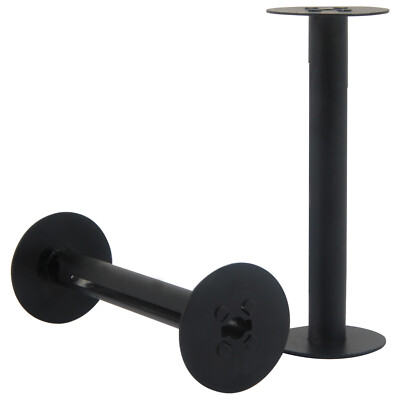

I have 620 take up spools, I only modify the film roll.
That's the way I did it too. I still had a much harder time turning my advance knob than when I use 620 spools in both chambers. I even sanded/filed down my 120 spool ends and it was still tight(and messy). It's so much easier and cleaner for me to just respool. Besides, I have plenty of 620 spools on hand. Now with Shanghai GP3 coming in 620 we'll see morew 620 spools free up.

Do watch for the current manufacture 620 spools, though -- both the ones from Shanghai and those FPP and B&H "pre-spooled" 620 come on. I've read that they're plastic, which means they need to have a thicker core (which could affect turns-counting frame counters) and the thin end flanges may have light transmission issues. If you have the option, my own preference would be for metal 620 spools for respooling or for takeup from a trimmed 120 supply. They're expensive these days (around ten bucks each on eBay, last I checked) but they last about forever if you take a little care with them.

Nice! One for ten bucks, but four for only $15 ("free" shipping is the cause, obviously). I've put those on my watch list, I'll get a batch or two when I get paid.

Yes, that sounds pretty good. Not super cheap, but like you say, metal should last near forever.
