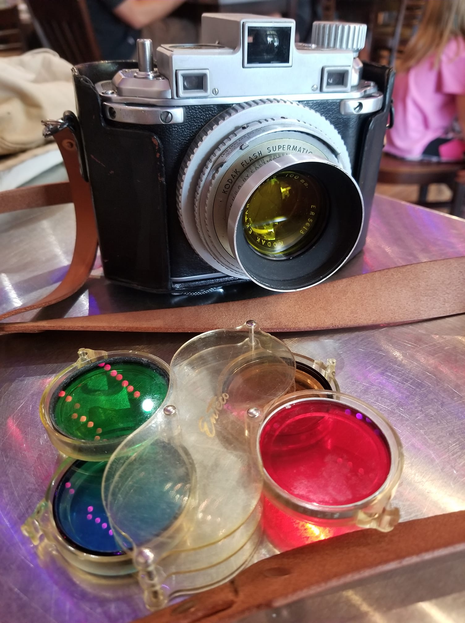

Mine has the case! Also found a full Wratten color filter kit for it and a lens hood that holds Wratten filters. Also copped a leather strap locally made.
