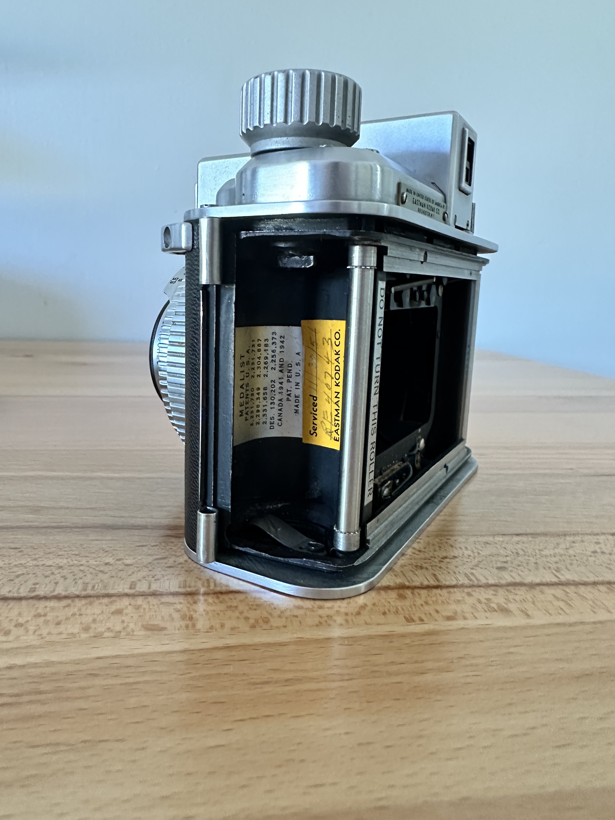

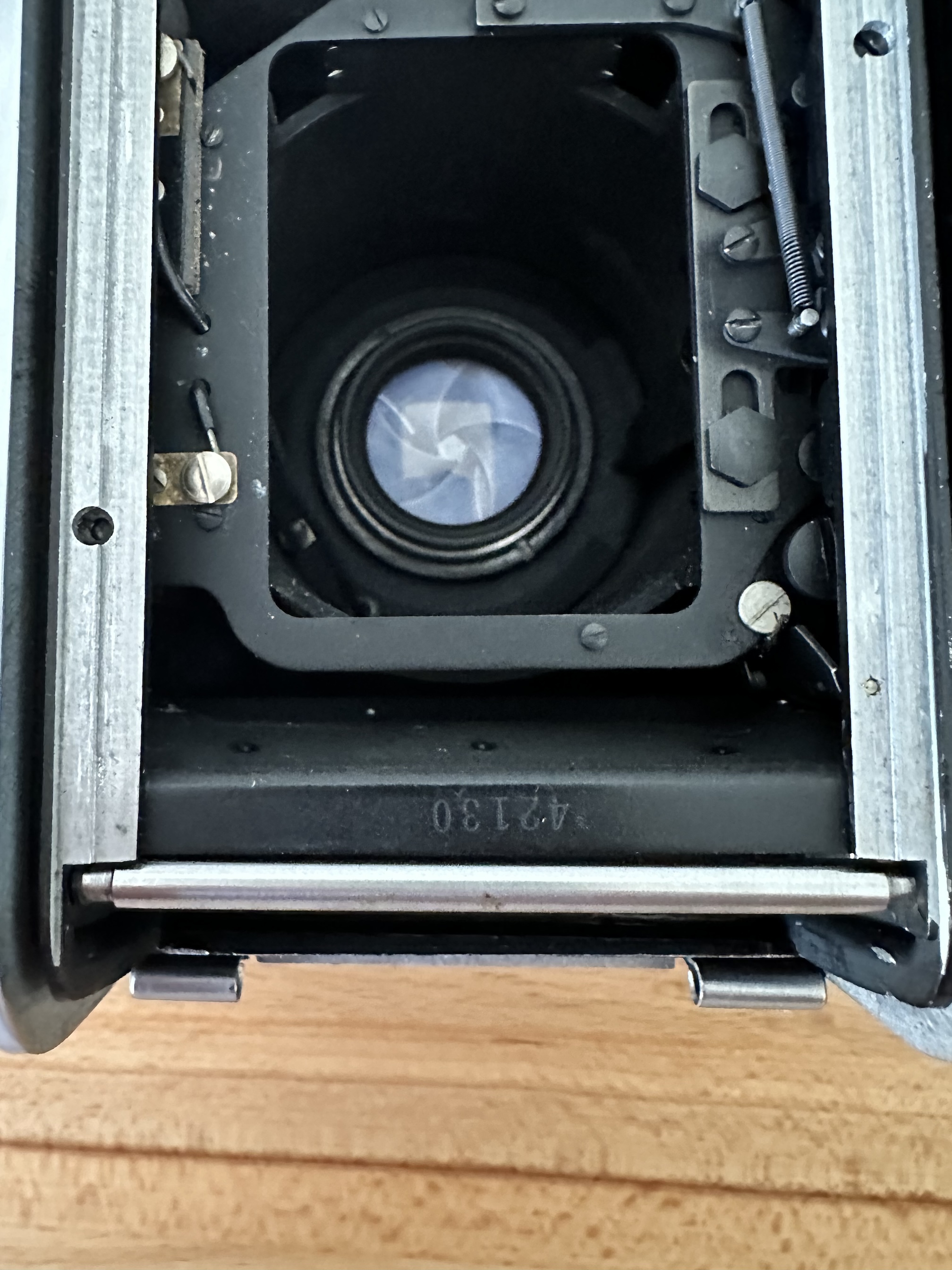

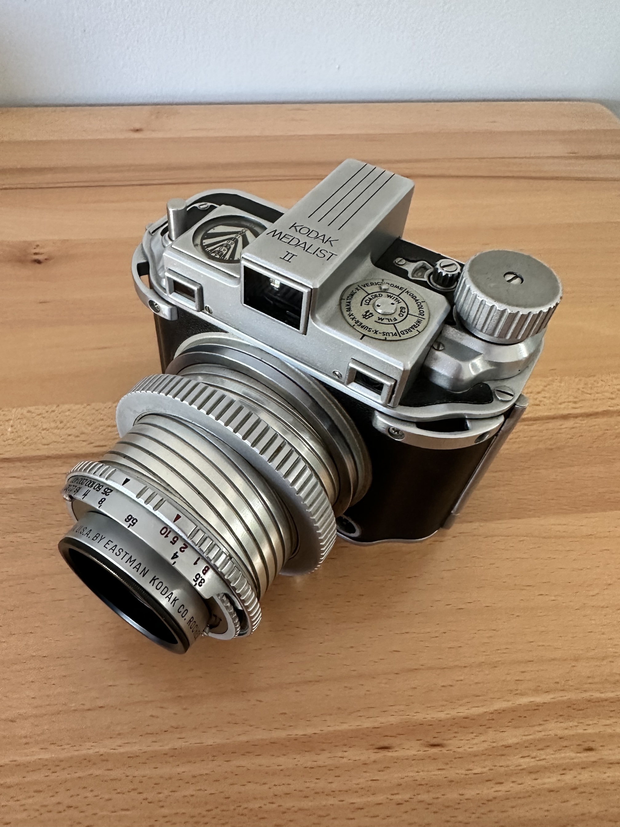

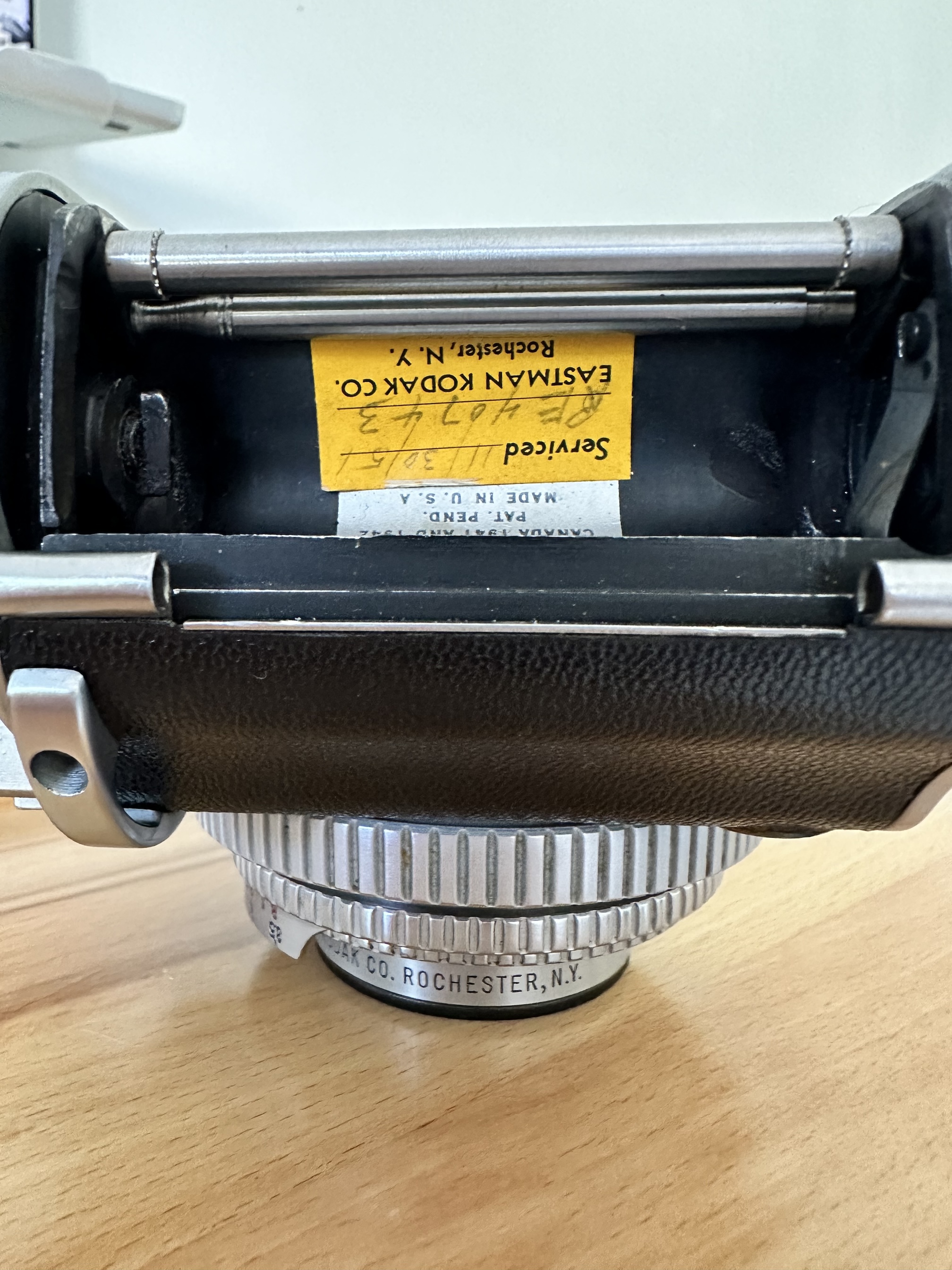

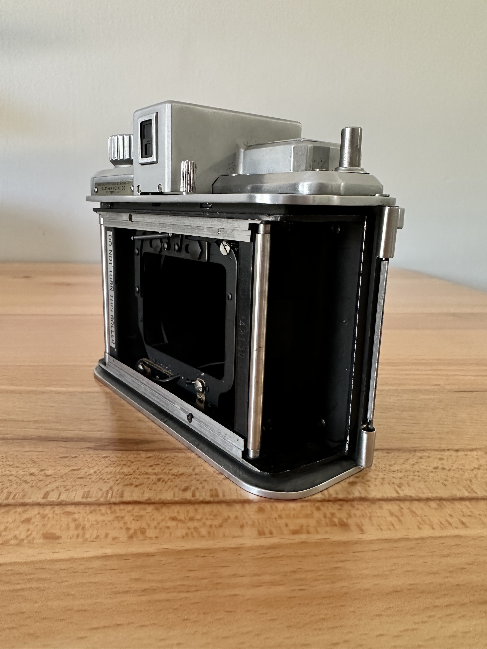

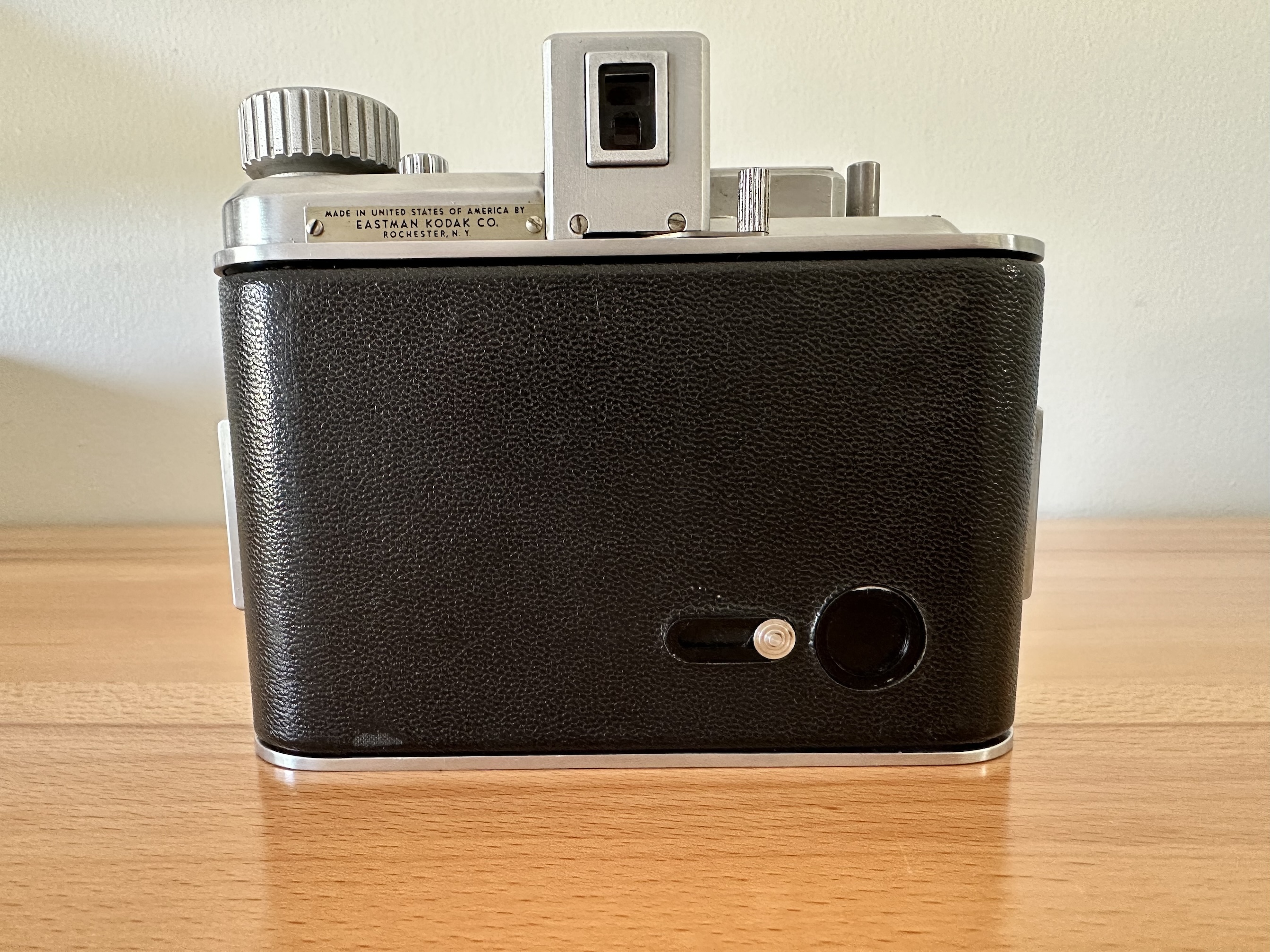

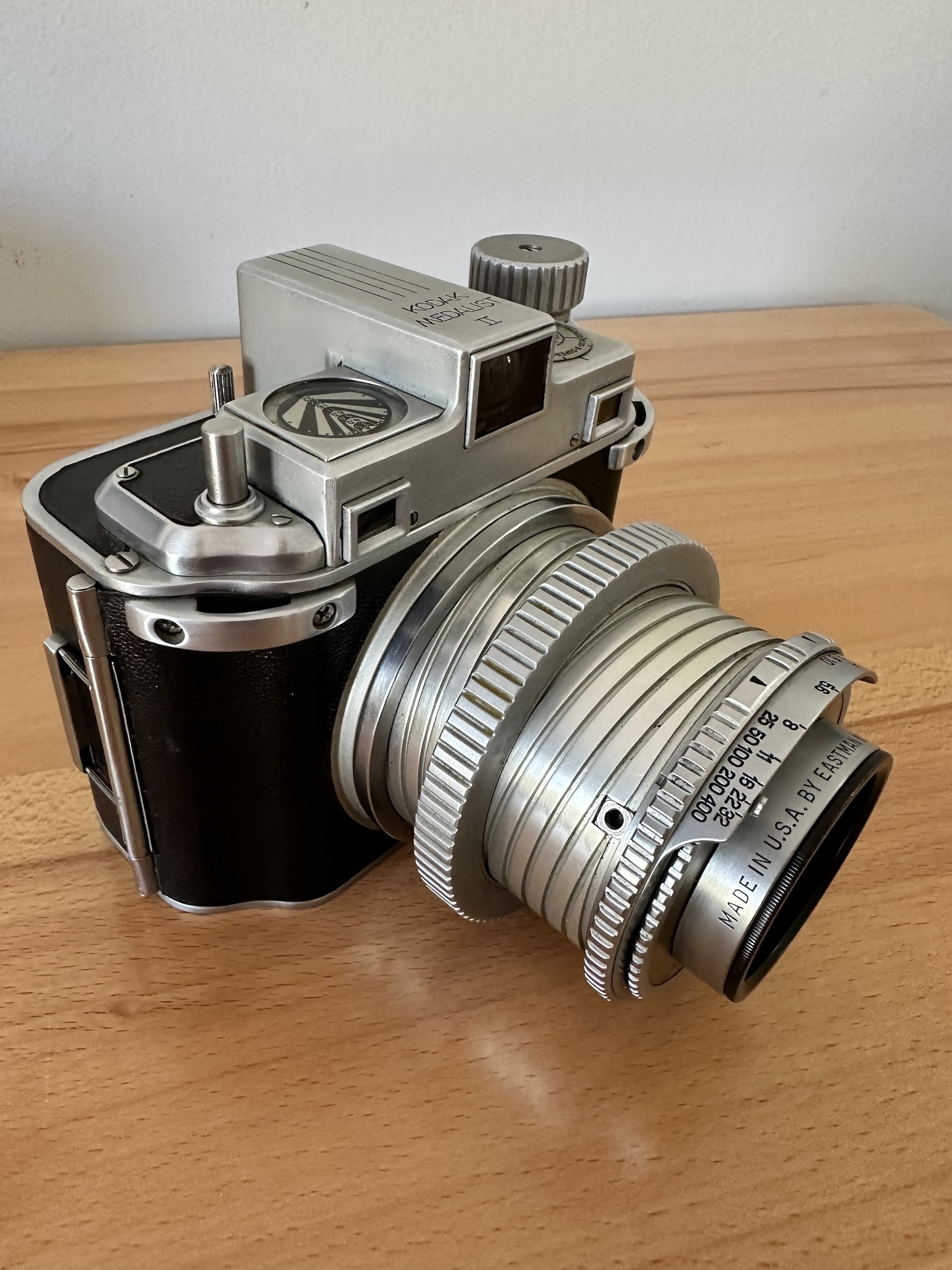

Got the Medalist II. 120 conversion is on both sides and seems to have been done well. Ran a roll through it yesterday and the film seems to sit flat, good tension on winding, though there is a little less space on the top side between the image and the edge of the film strip, a little more on the bottom, a little bit of a slant (take up spool sits a little higher because of the spring on that side?). All aperture and shutter speeds seem good. Attached are a couple of pics of the camera.

Looks like a Ken Ruth conversion. In the takeup spool chamber, is there a roller tucked behind the outer roller, with both ends narrowed down a bit?
It looks as if the feed side roller might be canted. Sight the roller (main body, not the little spinny bits at the ends) against the main body film rails, both 'height' and offset from the end of the film rails. But all in all, minor issue. Mr. Ruth sure knew how to clean up that rangefinder system! Enjoy.
$209? Sigh....
Dan, you have sharp eye - definitely a cant to the feed side roller and that would explain the slant to the image on the film strip... like you said, a minor issue. There is such a roller on the take-up side (see photo). Also I don't have any way to print or scan right now, but when the day comes that I do, I will post some images.
On another note, if I might bother you all some more... the camera came without a lens cap (or case). My thought was to buy a lens hood and then find a plastic push-on cap that covers that; I'll also grab some series VI filters as well. However, when I look search for "Kodak Series VI Lens hood" I see a lot that look like they screw into a sort of adapter ring that then is push-on... guess my question is what model/style screws directly in in place of the retaining ring that is on there?
Your advice is greatly appreciated.
