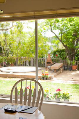

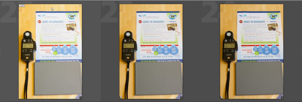

Ok since I have the flat disk and hemisphere...
Here is my 'flat art' on a table, lit by windowlight somewhat like an art reproduction might have light at 45 degrees to the art (but to both sides, not merely one)
The test scenario
  • Flat disk reading: ISO 400 1/60 f/4.0 +0.1EV from left of art (Minolta Autometer Vf).
    +0.2EV if taken from right of art rather than from left.
  • Grey card spot reading: ISO 400 1/60 f/4.0 +0.6EV (-0.5EV less exposure than indicated by flat disk) with Minolta Spotmeter F
Now the shot, at left as exposed per flat disk ISO 400 1/60 f/4.0 +0.0EV
and on the right, I cloned the photo and reduced exposure in LR postprocessing -0.5EV...the grey reads exactly 50-50-50 (rounding the decimal) with the eyedropper.
The spotmeter and grey card did better, more accurate tonal representation of inherent brightness in art and grey card!

I had not seen that referenced, but I did take measurement out of curiosity when I did my most recent testing with flat art,
  • flat disk parallel to flat art: ISO 400 1/60 f/4.0 +0.1EV
  • flat disk pointed at window source: ISO 400 1/60 f/5.6 +0.6EV
  • average of the forementioned: ISO 400 f/1/60 f/4.0 +0.85EV, which is about 0.75EV darker than the original exposure and 0.25EV darker than the grey card exposure (and rendering the grey card a touch dark)
Here is the earlier series, with third exposure added, as above (adjusted in LR postprocessing -0.75EV)

In this one case you can theoretically place a gray card specifically at the point you prefer, if the processing is pre defined.
That still doesn't mean it will fall dead center. 1 isn't the middle between 0 and 1.8.
Sure, and it's very possible to do.
The only things one needs to know to make any target work is how you use it normally and what the offset is to the speed point. It's not about middle gray, it's about the relationship between the target and the speed point.
As with any form of spot metering this comes with a little practice and testing.
