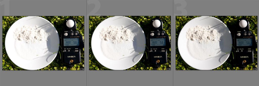

I just thought I'd do this as described, to see how 'infallible' the incident meter would be...
Subject: a bit of flour and a bit of sugar on a white plate
Sunlight late afternoon (4:45pm) meter pointed straight up to the sky (and at the lens)...
ISO 400, 1/1600 f/5.6 +0.3EV metered.
Shots at ISO 400 f/5.6, shutter speeds 1/1600 (0EV) 1/2000 (-0.33EV) 1/2500 (-0.66EV) (left to right)...
Sure enough, the exposure made at -0.66EV from incident metered resulted in the 'best' rendition of sugar and flour.
So then I angled the hemisphere and metered the result....
The best result, for incident meter which best matches the actual exposure in the above series, required the hemisphere to be pointed to the SUN, not pointed at the camera lens (contrary to popular opinion, but matching the aim-at-source technique which I believe to best protect highlights for transparencies or digital!) Yet even then the incident meter suggested +0.2EV more exposure than the right most shot was exposed in the series above.

Since the white plate and, umm, mysterious white powder are nearly 2-D... shouldn't you have used a flat disk diffuser instead of the dome?
Nice idea, here is the result...
  • Hemisphere at lens f/5.6 +0.3EV
  • Hemisphere at sun f/5.6 +0.8EV
  • Flat disk at lens (sun has lowered in a sky by 5:25pm): f/4 + 0.7EV
  • Flat disk at sun: f/8.0 +0.0EV
So the best result matching the actual exposure for best result was #4 aimed at the source, not parallel to the 'flat' subject!

Your conclusion does not surprise me, Pointing the meter at the main light protects the highlights.
In contrast though :wink: the furthest left shot protected the mid/lower tones better so...

The big difference between sphere and disk is angle of view. You can be more specific about what the meter sees.
For example "Flat disk at lens (sun has lowered in a sky by 5:25pm)" is seeing just the sky so it protects the shadow detail. While "Hemisphere at lens f/5.6 +0.3EV" at the same time is seeing the sky and some sun so it compromises between the two light sources. "Flat disk at sun" protects the highlights at the expense of mid and low tones.
There isn't a wrong choice here, you just apply an artistic bias by choosing one metering method over another.

The gray card and a spot meter can do the same thing. Just ask yourself what's the card seeing and what am I trying to protect?
The flour rendition is lacking detail in the first picture because it sits on the beginning of the toe (for slide or digital).
My approach would be, as stated, to just move the exposure so as to place the flour in a zone of better texture.
