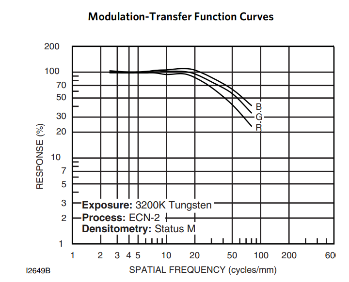

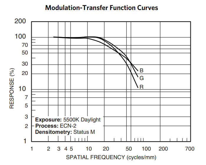

I've skimmed through this discussion so forgive me if some of these points have already been stated but to offer some potential insight.
Kodak Vision compared to the previous Kodak EXR stock primarily saw an improvement in sharpness for the cyan dye layer (red sensitive layer), aside from that they're mostly the same. But it must be noted that you can't trust all published stock specifications, the published specifications are a "customer aim" and in some cases smoke and mirrors. For example, below are the published MTF plots between EXR 500T 5298 and Kodak Vision 500T 5279. You'll see ridiculously high acutance for 5279.

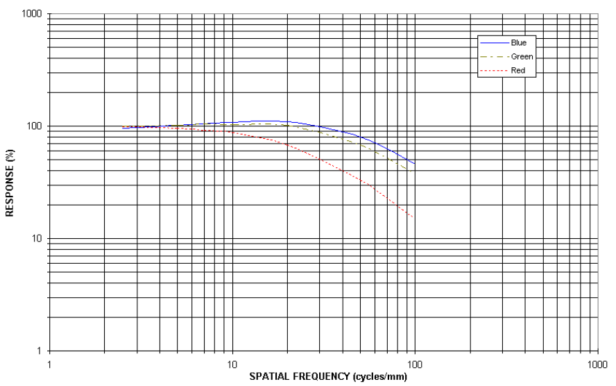

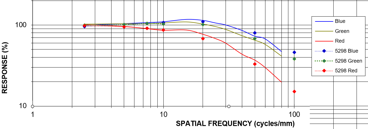

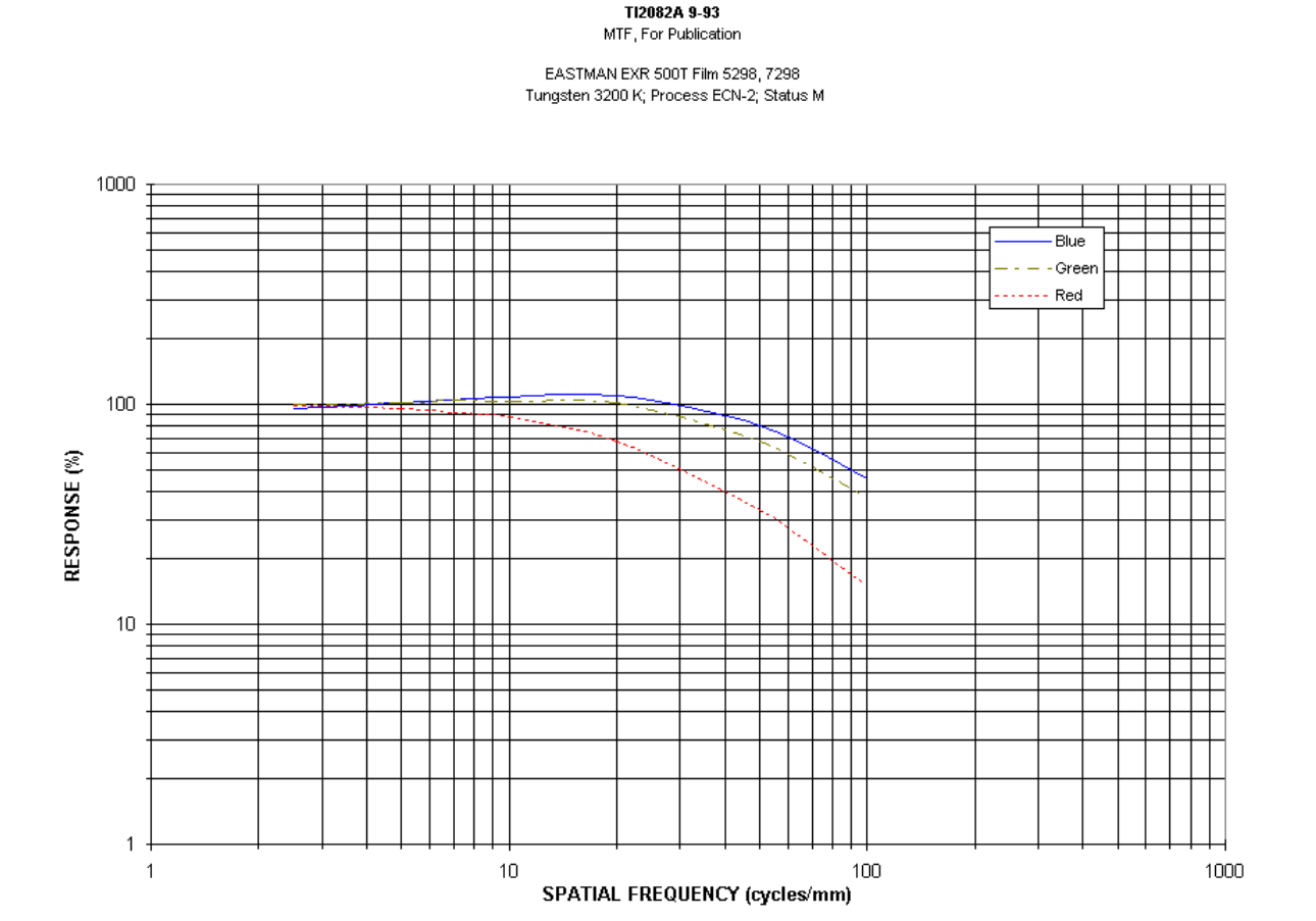

For comparison, below are real lab tests from a coating engineer at Kodak between 5298 and 5279 when they were in production. Modulation for 5279 and 5298 were in fact equivalent for the yellow and magenta layers, with improved sharpness for the cyan layer of 5279.

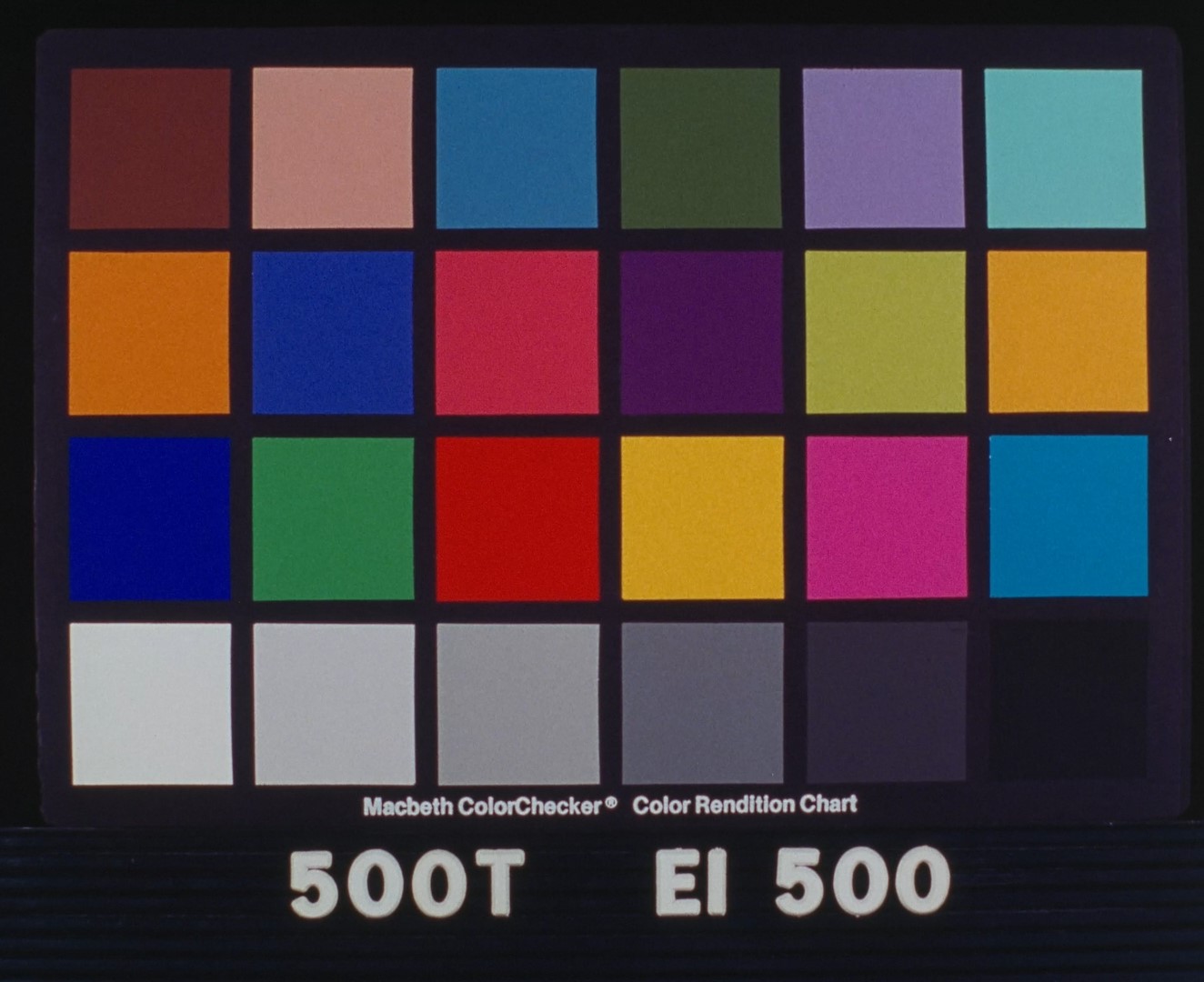

And for further confirmation, below are controlled tests of Macbeth charts for 5298 and 5279 from Kodak back in the late 90s, scanned back (downsampled to full hd).
John Sawyer employed more tabular grains in 5279 than 5298 (which utilized more polymorphic grains), this of course means decreased scattering in the emulsion during exposure. If you pay attention to the edges of various patches, you'll see greater density for both stock. This is due to development inhibitor archimeric releasing couplers, during development there is more oxidized color developer where density is formed near where density is not being formed (edges), this allows the DIAR couplers to further increase development for those areas and is the reason why modulation in various stock MTF specifications exceeds 100% for mid to low spatial frequencies. It's essentially equivalent to an unsharp mask. But keep in mind, since this takes place in development, the latent image captured prior still contains a resolution which is the product of the emulsions scattering and halation properties, meaning these DIAR couplers improve acutance of a lower resolution latent image.
-images-

Wow, that's a bunch for the elaborate reply! I was surprised to get a notification that someone was replying after this thread went dormant, heh!

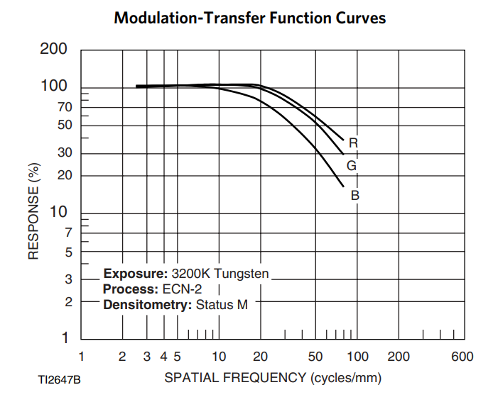

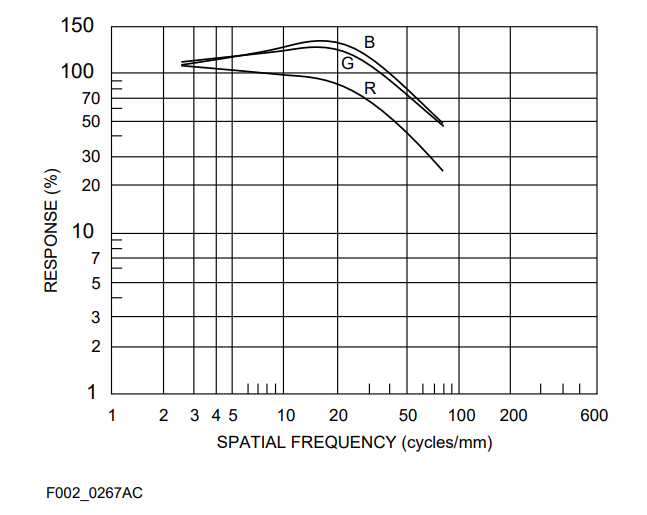

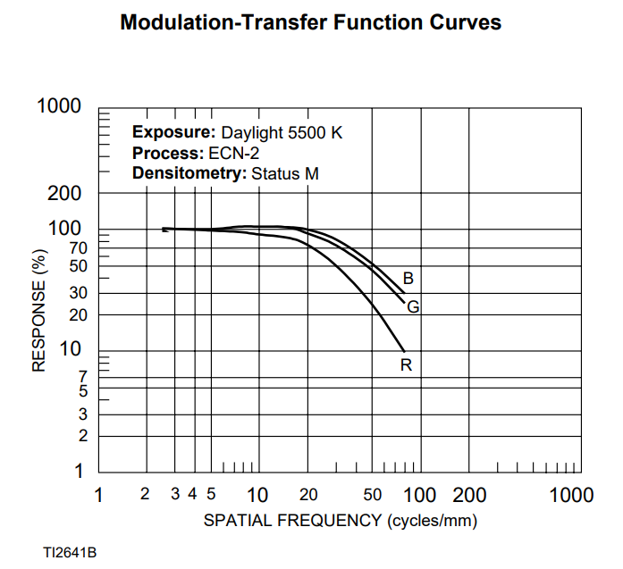

That's true, comparing the Vision 500T gives you a similarly wacky result with the gigantic accutance bump. However, it's not out of line with the other EXRs, rather it seems out of line with the subsequent Vision stocks in the line. But, from the other lab test you showed, it seems to differ from the values on the 5279 tech document while the 5298 seems to agree.
What does this mean? Was the Vision 500T 5279 MTF improperly drawn on the technical document? Then what does that mean for the EXR stocks? They seem to mostly agree with each other, extending far without the giant boost.
50D: EXR_50D.PNG 200T: EXR_200T.PNG
It's strange they sometimes have the plots with bounds that are way too far for the data... I tried emailing someone about it because I noticed a bunch of errors on their sellsheets and tech docs but I had no idea who to contact.
Was John Sawyer one of the designers? Hm, from your images the effect looks a bit more subtle than I've seen in other stocks that have this edge-sharpening-development effect.
It stands to reason that reducing the scattering would improve these performance, then I imagine at some level the DIAR would become overwhelming. Funnily, I don't see it so heavily in that example! Because I have seen those edge-effects on photos though they're usually in B&W cases.
But, it's good that you introduce color charts because I was curious if low-contrast performance would be better visible on transitions between different colors than small grayscale changes.

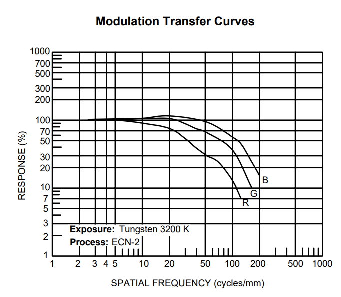

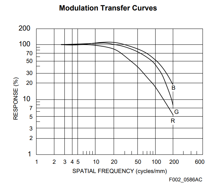

Only when reviewing all the different versions do I get an idea of how chaotic things were. Stocks being introduces then discontinued after less than 2 years. Both lines being present at the same time (there's no Vision 50D, but there is Vision2)
Here is a jumble of them (attached), please note each by the filename. So I'll include some odd ones. The EXR 500T is plotted differently, I suppose because it is the oldest technical document that was not revised to the new style. Mostly 50D and 500T:
EXR 50D: EXR_50D.PNG
EXR 200T: EXR_200T.PNG
EXR 500T: EXR_500T.PNG
Vision 500T (5279): Vision_500T_5279.PNG
Vision2 50D: Vision2_50D.PNG
Vision2 500T: Vision2_500T.PNG
Vision3 50D: Vision3_50D.PNG
Vision3 500T: Vision3_500T.PNG
The source of these docs is Tim Gray's archive to the Kodak Technical Docs.

Interesting. I know the sensitometer at Kodak Rochester for testing MTF exposes the film with line pairs between 2 cycles/mm to 100 cycles/mm, so modulation past 100 cycles/mm for those EXR plots would be extrapolated. As mentioned prior, stock specifications published by Kodak are "customer aims", I can't say for sure what the history is for those extreme cases like the MTF plot for Vision 500T, but I would assume clash between the marketing department or aims from earlier in development that never came to fruition.
The customer aims are typically cleaned up for publishing, not via averaging multiple samples but by artistically making the plots smoother, you can also see this for characteristic curves. I've ran heaps of ecn-2 control strips for Vision3 stock and have never seen results as clean as the published characteristic curves, from lab tests I've seen from Kodak, neither have they. So in general, take the spec sheets with a grain of salt, if you're looking for accuracy you'd be better off to contact one of the engineers for historical records.
Yeah, here's the original demo from John when they introduced the first line of Vision stock. Hope this helps.
Sorry for sitting on this for a while!
Hm, that's interesting. There are quite a few other stocks (such as B&W stocks) that have been measured past 100 cycles. Would all of these have been extrapolated?
And if these figures are showing themselves to be unreliable, what's causing it and what can we concretely deduce at all? Do I just need to buy some leftover EXR stock and confirm it for myself?
Something like the H-D plots being tweaked makes some sense, but I can only imagine that this occurs to only some degree. Smoothing the plots out and the plots arbitrarily implying twice the performance are very different changes to be made by the editorial department in charge of making the technical datasheets.
Just curious, what results do you typically see in your tests?
Also, what are you referencing for the results of Kodak's internals tests, their instruments, techniques, etc? Is there some reference for this stuff? Do you know someone?
