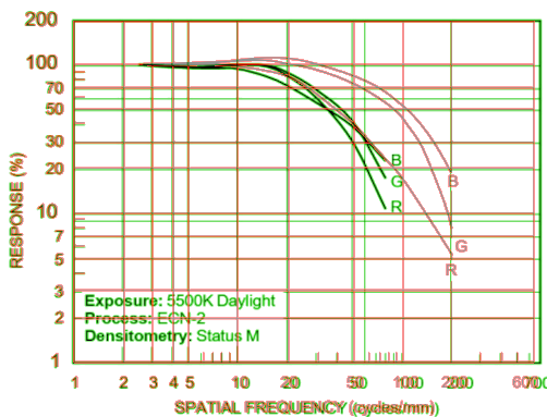

I think the OP was referring to the 50D, for which the MTF of the EXR seems to be quite a bit higher.
PS: I also just looked at the 500T and the same thing is true there. Grain on the other hand is much smaller on the (500T) Vision3 emulsion (as is to be expected).
50D:
500T:
Oh yeah, that's an odd one:
Green is Vision3 50D, red is EXR 50D.
Looks like something was changed that affected acutance; maybe DIR-related.

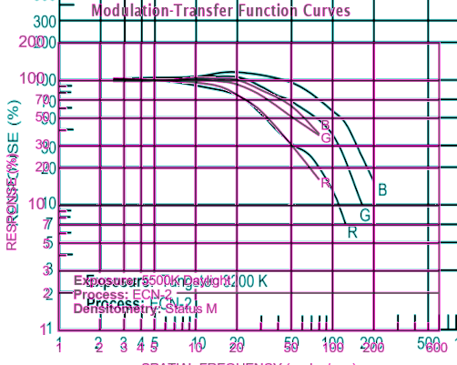

Vision 500T 5263:
Vision3 500T 5219:
Regardless, I am curious: I see many people tune their development process and choice of film in B&W by a lot. Achieving certain grain, acutance, mixing up special "recipes" to improve various aspects of the negative. All in development, not printing. Color doesn't seem to have a fraction of that flexibility. There's no fancy developers for each use case with color. So while aspects like the acutance might be formulated into the stock, is there no way to improve acutance during development?
I'm no expert on this, but I suspect it would be possible to change the chemistry to affect acutance somewhat.
The main problem is likely that it would probably also affect color rendering, which is usually a bigger concern than minor changes in sharpness and grain texture.
Also, color is mainly done in commercial labs, where keeping at standarised procedures is more important than tinkering. rather few labs offer custom tailored b/w processing either.
yes, as you mention, in the first generation, the main purpose was to get less apparent grain in the higher speed films. In fact, as far as I can remember there wasn't a first generation 50D and 100T Vision emulsion and they skipped that until Vision2 was introduced.
the data sheet suggests that they did manage to improve MTF slightly from first to third generation while lowering grain even further:
Vision 500T 5263:
Vision3 500T 5219:
Oddly, with the layers in the reverse order. Everything went up but red and blue swapped.

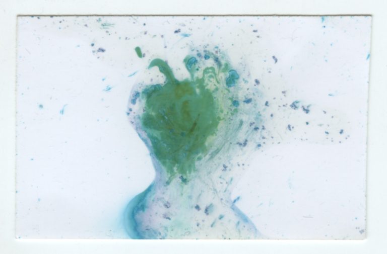

This is a small snippet of RA4 paper (similar dyes to ECN2 and E6 film) which was blixed out and washed. Then afterwards I added some developer and silver chloride (made in-situ by combining silver nitrate and sodium chloride), which developed out instantly and the oxidized developer coupled with the dye couplers. While I used silver chloride here to get things going, you could (at least theoretically) also use something else.
So all considered, yes, you could form (colorful) dyes from the colorless dye couplers in a CN material through different routes than the normal development process. However, if you want the film/paper to work more or less intended, i.e. as a material that responds to light (and different colors of it, at that), I don't really see why you'd want to skip over the silver halide already embedded in the emulsion and sensitized specifically to work where it is.
Because doesn't that use separate B&W and color developers?
Yes, it does.
Yes, it does.
