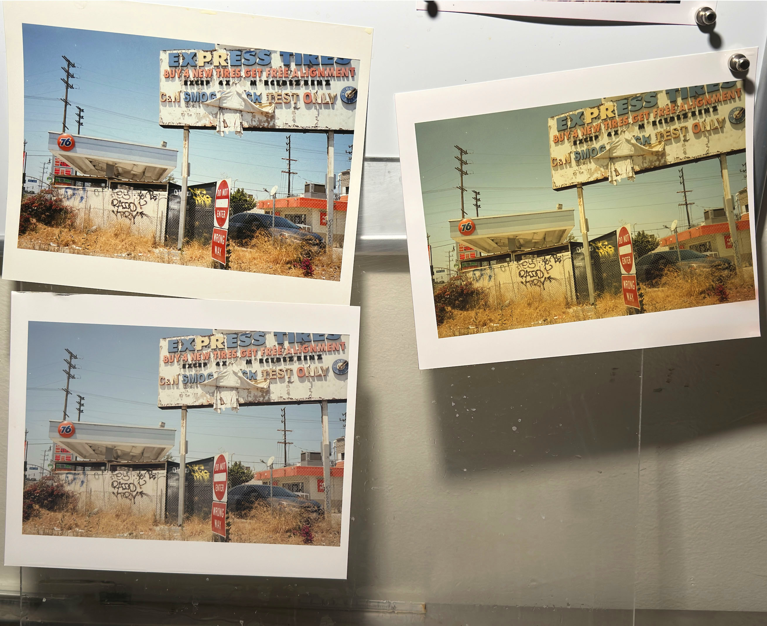

For the past 3 years I have been buying Fuji CAII paper rolls and chopping them down for RA-4 printing in my darkroom. It's been fine, but I've never really felt satisfied - mottled and weak black point, thin paper, weak contrast, etc. But it was the only paper that was available so I kept at it. Until today! A few months ago I saw that Kodak Endura Premier was available via Unique Photo so I ordered a roll. Today I was running low on CAII so I chopped of a few sheets of Endura Premier and gave it a go. Immediately I was blown away by the increased contrast, cleaner black point, and overall quality improvement compared to the CAII I had been working with.
Here's a look at all 3 up on inspection board. They're all mostly dried off, at least enough to where the blue veiling is dried down and the paper has visible Dmax. This is from a Fuji Pro 400H negative shot with a Fuji Klasse S. I'm going to miss that film, I wish I shot more of it while it was around. The prints were made with an LPL 4500II, Nikkor 105mm lens, and processed with fresh Fuji RA-4 chemistry in my Durst RCP 20.
Top Left - Kodak Endura Premier Lustre. Top Right - Fuji Crystal Archive II with the same exact enlarger settings as the Kodak print. Bottom Left - Fuji Crystal Archive II balanced to match the Kodak print.
The paper before processing is tan vs Fuji's blue. The paper base after processing is a little bit warmer than Fuji, which is not a problem for me as I still think the highlights print and feel neutral. I don't have the filtration settings on hand, but they were around 30-50cc points different. Fuji was about a stop faster than the Kodak.
Overall I am seriously impressed and will be buying more in the future. I expect this will become my main RA-4 paper though I will keep a box of CAII around for very contrasty scenes. Anyone else have any experiences with these 2 papers in recent years?

I like the saturated colors.:Top Left - Kodak Endura Premier Lustre.
Washed out colors. Blah.: Top Right - Fuji Crystal Archive II .
Second best, needs a little more pop: Bottom Left - Fuji Crystal Archive II
Standard Fuji CAII is a very bad paper, the only good thing is the price. My condolencies if it is the only thing you can use. I have an opened box 100 sheets of 18x24 cm untouched since many years, it has around 97 sheets left.

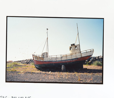

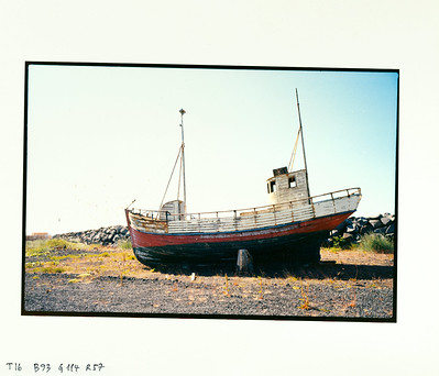

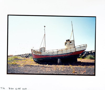

My test of the CAII, Maxima, Endura (I've posted this before on Photrio):
