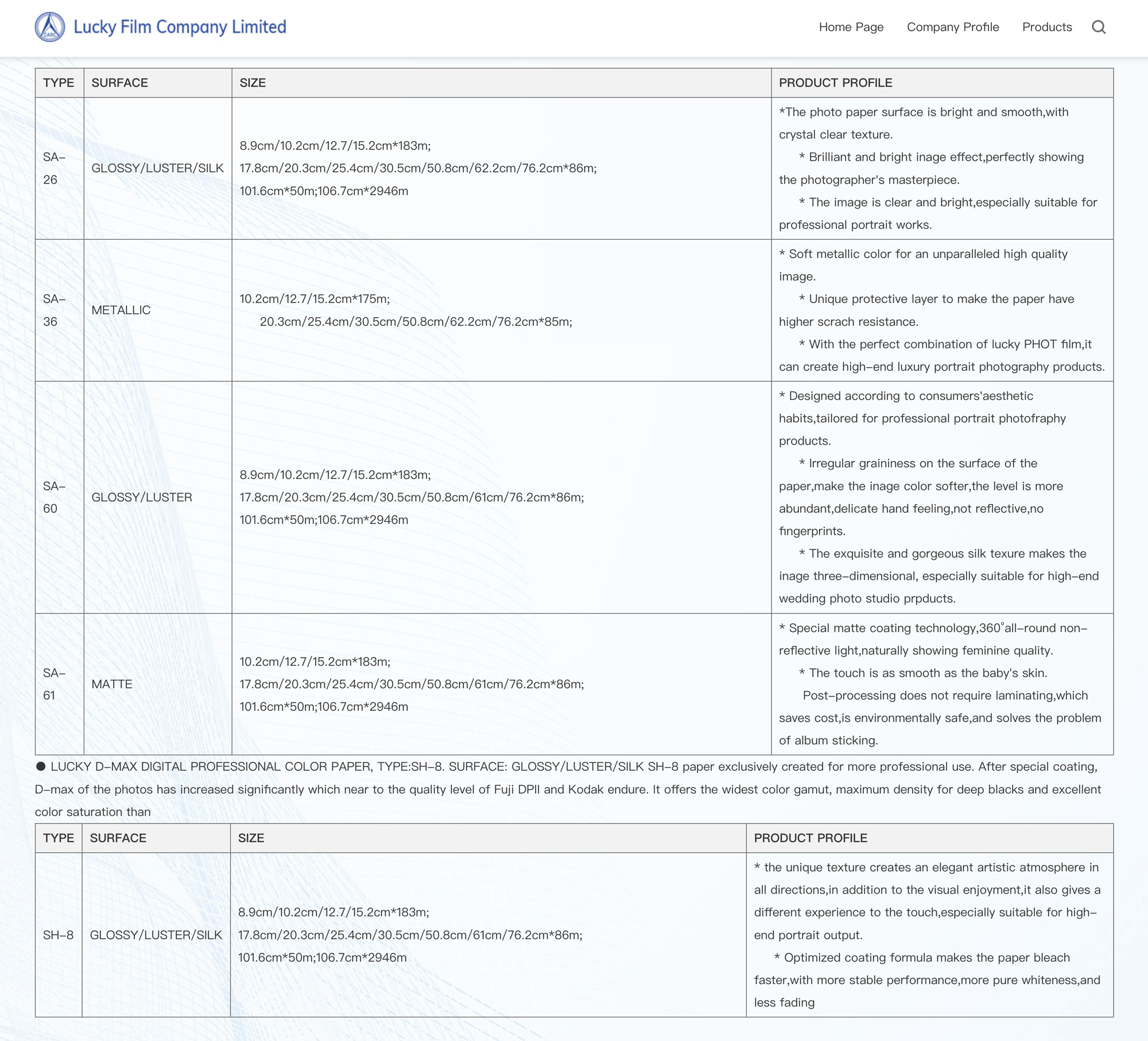

By checking Lucky's official website, I found that Lucky's professional product paper SH-8 is described as "optimized coating formula, more stable performance, less fading"
and even confidently claims that "near to the quality level of Fuji DPII and Kodak endure". "It offers the widest color gamut, maximum density for deep blacks and excellent color saturation"
I'm not sure if this paper Lucky is still available, but I'm very interested.
