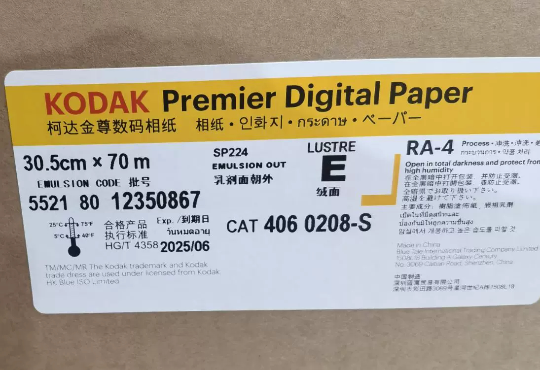

I saw a new batch of Kodak premier digital paper being sold on a Chinese shopping website, with an expiration date of 2025/06!
I saw that it no longer has any Sinopromise production mark, but is produced by a company called "Blue Taie International Company".
Very happy to see kodak premier digital paper back in production! And look forward to the re-release of ENDURA Premier and ENDURA Premier Metallic.
I thought I would never see this again...
I'm most intrigued by the licensing reference - "Kodak HK Blue ISO Limited"
wonder if Eastman Kodak's Licensing department has been extra busy? or did the paper buisness get sold from the ruins of Sino-Promise.

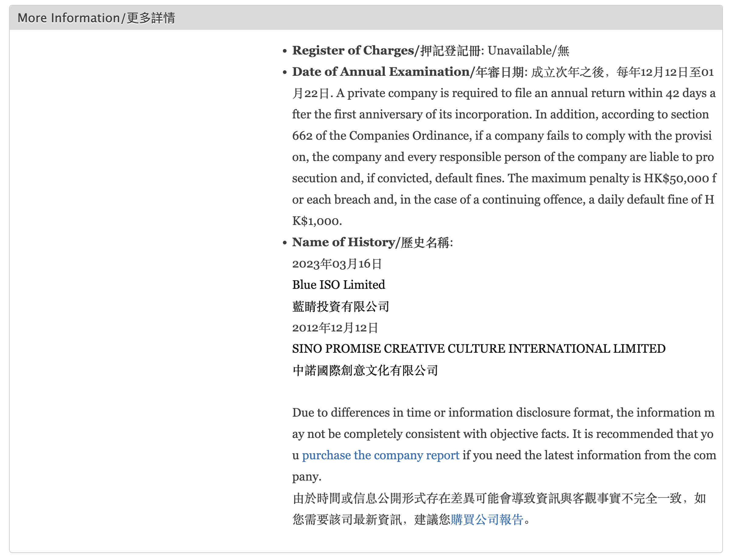

Through searching, I surprisingly discovered that "Blue ISO Limited" is SinoPromise!
Well, that makes a clear connection with SinoPromise and apparently, this new/other entity acquired the rights to the use of the Kodak name from SinoPromise. It all seems very plausible.

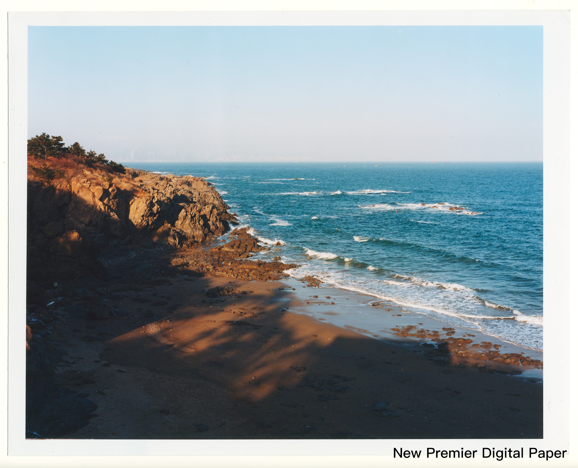

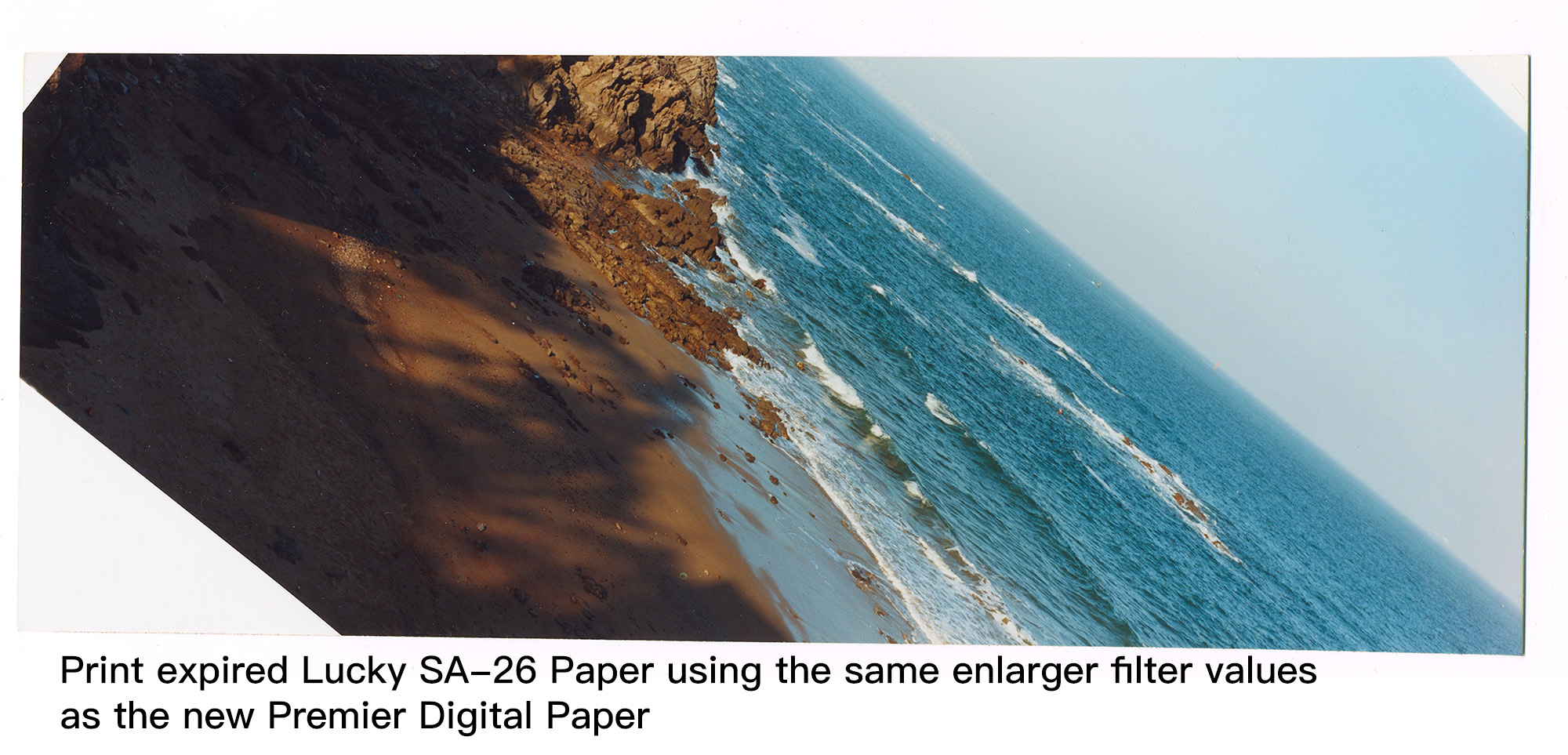

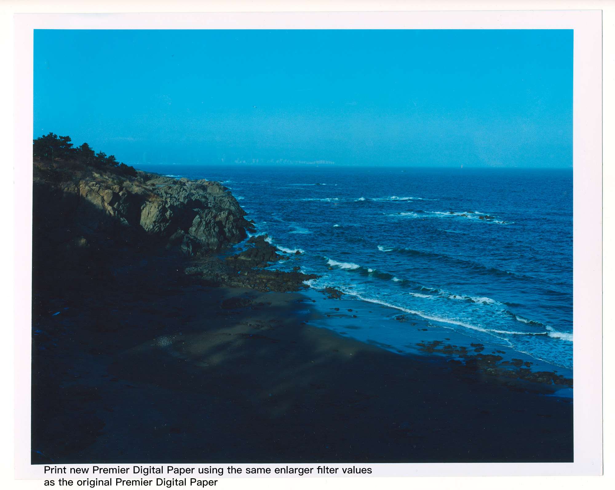

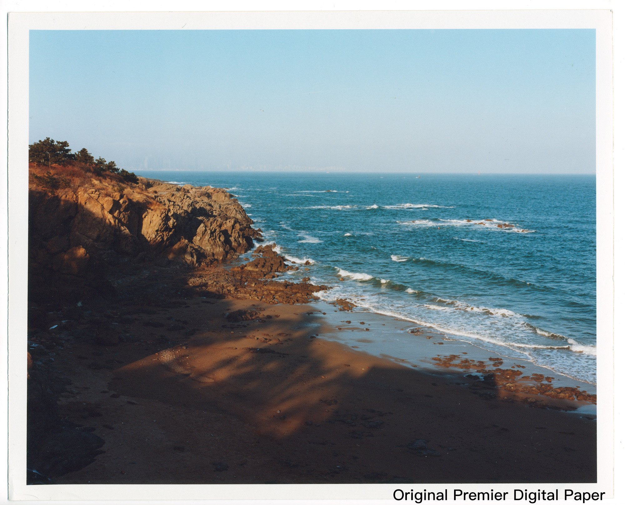

I recently got some for testing.
To be precise, it is completely different from the original KODAK Premier Digital Paper and is not the same product. I printed the new paper using original KODAK Premier Digital Paper color filter value, which gave a color cast result.
By use new color filter value, I printed a color as close to the original KODAK Premier Digital Paper as possible, but there are still some differences.
Finally, I printed the Lucky SA-26 Paper using the same color filter values I used to print the new KODAK Premier Digital Paper, and their colors are very close!
So I guess, it comes from lucky manufacturing.
