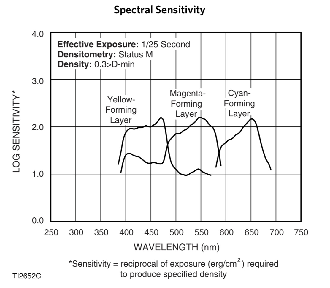

I've wanted to shoot Aerocolor with a didymium filter for some time now. It would seem the nudge in the didymium filter could potentially lessen or cure the yellow streak of the Aerocolor.
Looking at the spectral graph of the Aerocolor, has anyone tried shooting this through a dark red filter? You could do a double exposure with a deep blue and get something not miles off from Aerochrome? Or maybe just a deep purple filter, if such a thing exists (Congo Blue with optical qualities).
The chart you included is a dye density chart. It doesn't say anything about the film's spectral sensitivity and ability to render hues. You'd have to look at the spectral sensitivity chart instead. I assume it's also included in the datasheet.
You’re absolutely right. That was a faux pas. Corrected.
Still looks interesting with the correct curves.

Yes, certainly. There is something interesting going on around 600nm with this film. It's decidedly less sensitive there than e.g. Portra. This also underlines my earlier caution about scanning; while the conclusion of @blee1996 is that reds render very yellow, the datasheet suggests the exact opposite. However, since color correction takes place in digital post processing, a lack of yellow sensitivity can end up being overcompensated.
The portrait correction filter whose transmission curves you posted @Helge will further emphasize (not correct!) this effect. One might say that this film already has the filter built into it. Which is of course rather informal and haphazard to put it this way, but it sort of looks like it.
That would be up to an experiment (that I’ll do soonish, just need some sunshine and time). The Hoya curve I posted was mainly for the strong didymium filter. The portrait one is the weak sauce version for well, portraits.
Didymium corrects exactly for yellow casts. Hence the light purple colour. Question is how well the curves line up IRL.
Also the type of filter pulls out the blue in the sky so together with a polarizer it can work more or less like IR does for B&W skies.

Note that the filter you suggested cuts yellow. The Aerocolor sensitivity curve also cuts yellow. As I pointed out, the yellow rendition of the scans shown above seems like a digital/post processing artefact as it does not conform with the film's sensitivity. You'd need the opposite of your suggested filter to correct for this aspect of the film's response.
That might be. The cyan curve is certainly shaped differently than most other CN film and ”skewed” further to red.
But the developed film still has an overall yellow cast in all scans I’ve seen. Whether it’s actual response or how the dyes reacts in development is hard to say.
Aerocolor might actually be a good astrophotography film?
