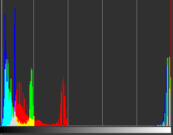

I scan with a digital camera. I found that I can extend the dynamic range of the scan by increasing the color temperature of the light source to the maximum (more blue) and then using custom white balance on the camera to compensate for the orange mask. I set the exposure such that the mask is scanned as very light grey (1 to 1/3 stop below clipping).
There is probably a typo in the sentence starting with "I can then now the information in the histogram".

Remember, if you are going by the histogram on live view screen, that is not a true representation of raw sensor data that you will be working with.
That explains why I need to decrease the exposure usually by 1/2 stops. Otherwise the highlights are clipped in the scanned image even though the histogram looks correct on the screen.

Possibly, although for the corrections based on the actual image data, you'd have to automate the histogram creation and parsing process. I'm sure there are plenty of libraries out there that will make this easier, but I never looked into it.
the first histogram in your post looks somewhat strange. I assume the peaks at the right are from the light source shining through the sprocket holes.
This one:
Yes, the peak on the right is the sprockets and the empty area around the film. It's not really a concern because there's no real haze or fog associated with it. Just clip off that part in processing. Scanning in 16 bit per channel is important, though. I didn't do it for this example and it results in pretty bad posterization in the final image:
And yes, especially when using a digital camera, you have lots of control over the process by adjusting camera settings and light source.
Thanks, I'm going to fix that!
