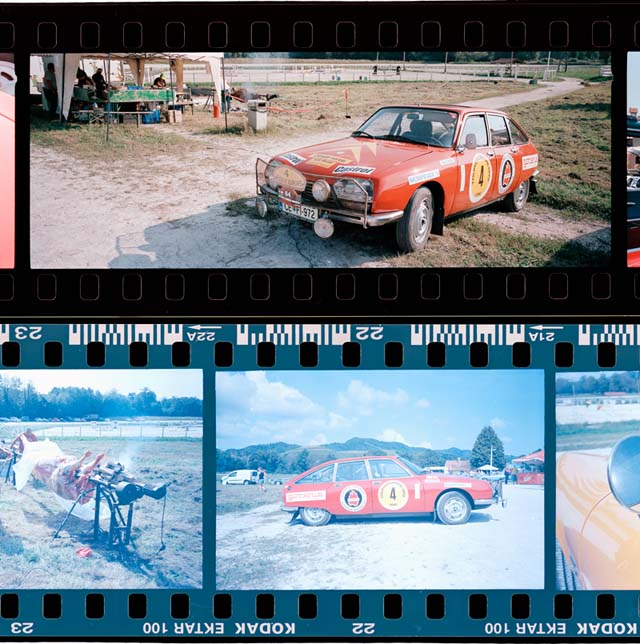

Now I'm intrigued. Obviously not exactly the same lens and same time of day, but I really wonder what conclusions you can draw from applying "standardised inversion algorithm" on a scan of Aerocolor + Ektar 100.
koraks
Nov 29, 2018
22,799
Europe
I know this probably sounds sour, but at this point I'm always out and go do something else:

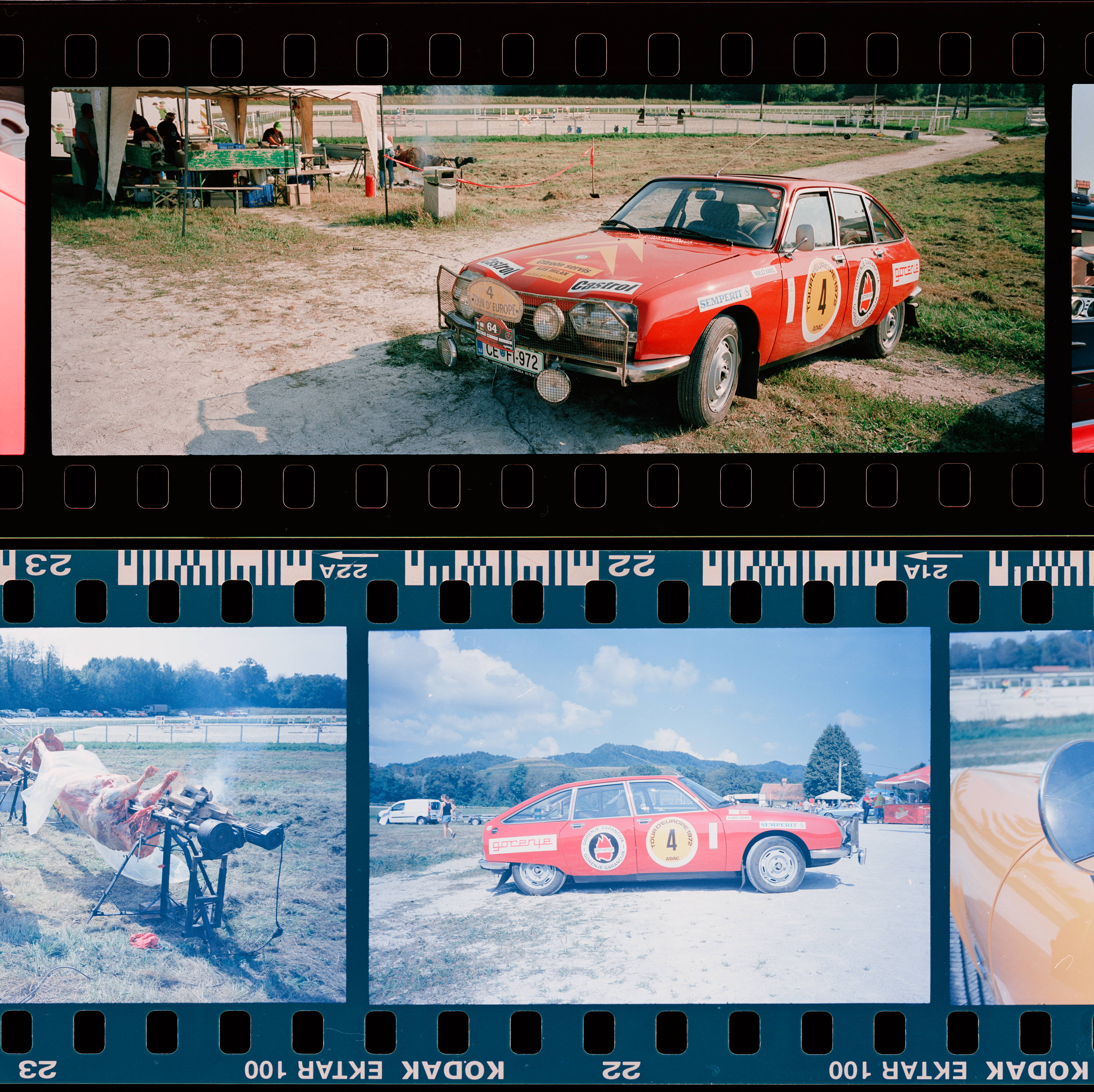

koraks
Nov 29, 2018
22,799
Europe
So this is balanced for the Aerocolor:
This for Ektar:
Side by side:
It's all debatable of course how punchy it should be and how exactly you determine which color balance is 'correct'. I did this in a seat-of-the-pants way. I balanced the Ektar more contrasty than I normally would; you could take this in any of a million directions.
What this mostly demonstrates, at least for me, is that the inversion is still a manual process and especially the direct comparison between a masked and an unmasked film is really tricky.
The Aerocolor scan was certainly easier to balance than the one I briefly played with earlier in this thread. It helps to have the actual source before inversion etc. And it's really not a difficult scan to work on, IMO. The Ektar is a lot more challenging.
I'm sure if someone ran these through any of the nifty inversion tools they'd get nice results, too.
PS I just took a screenshot instead of downloading the tiff, so I worked with the low-res 8 bit version. You can tell from the Ektar shot which posterizes pretty horribly, but that's just a fluke. This would come out better if you work on the actual 16 bit original.
