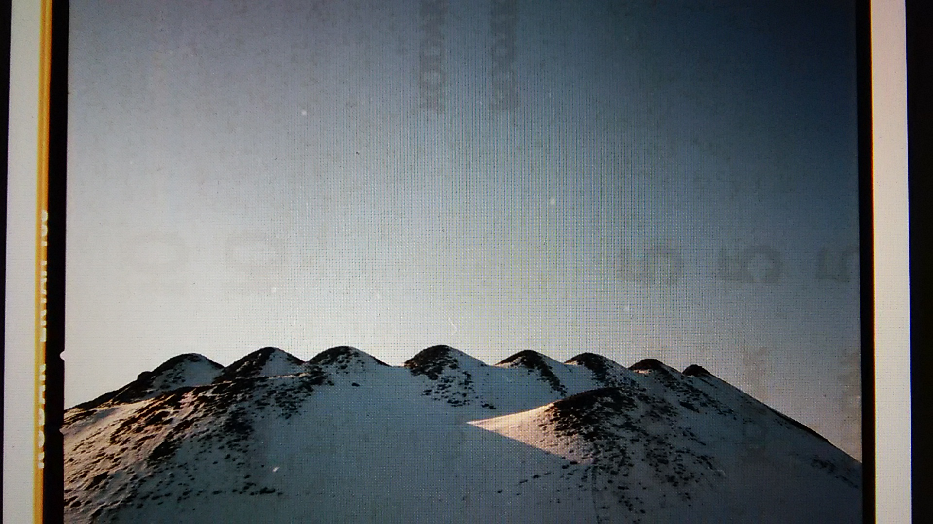

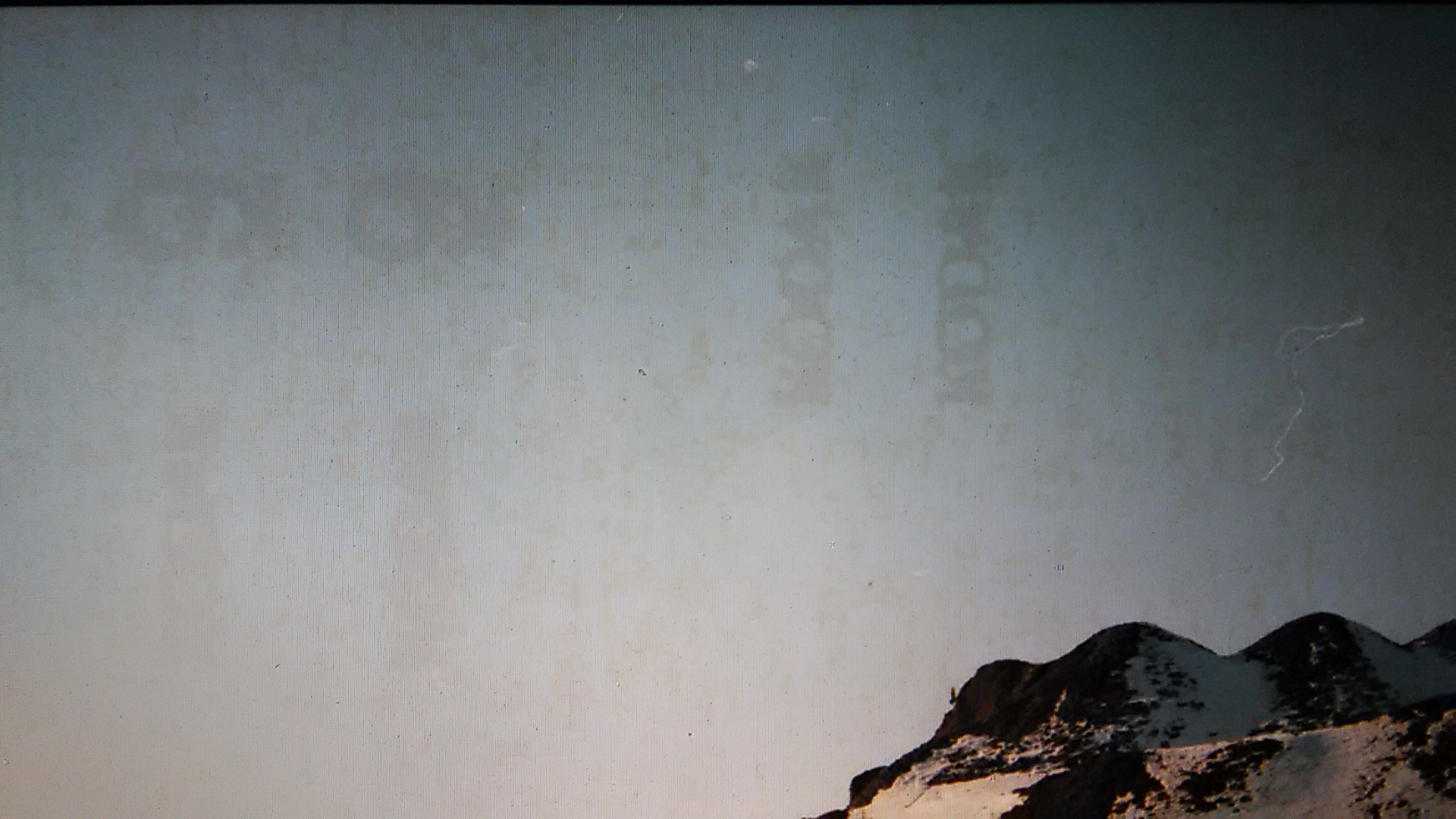

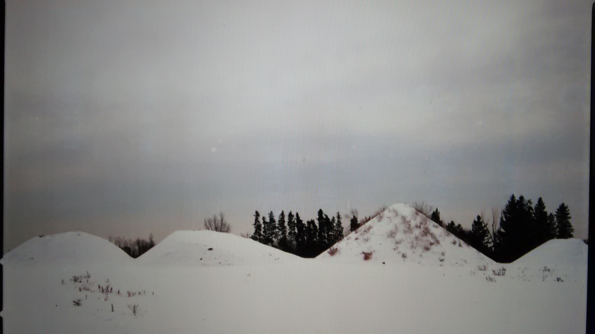

I purchased 60 rolls of Kodak Ektar 100, number is CAT8314098. I found almost every roll has back number when I shot ten rolls.
I contacted to Kodak company. I was replied with reason of over warmed during delivery.
I was angry but have no idea.
