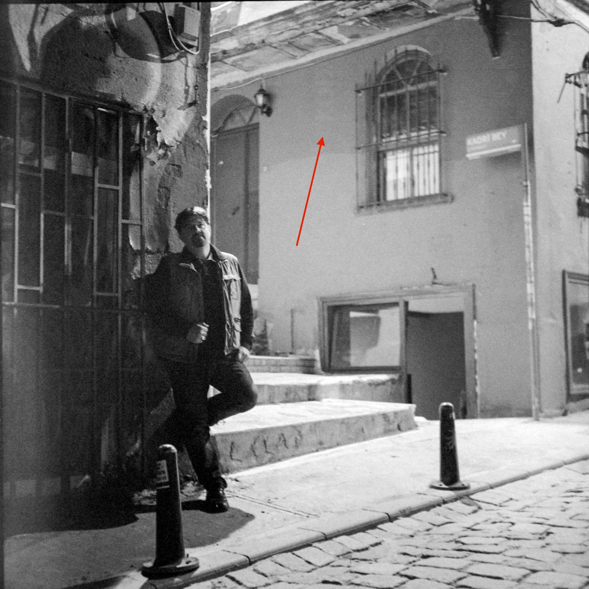

As a proof I have scanned yesterday many photos but the worst is this
Also I have already send a photo from the boxes with their part number (that are not included at the paper problem ones)

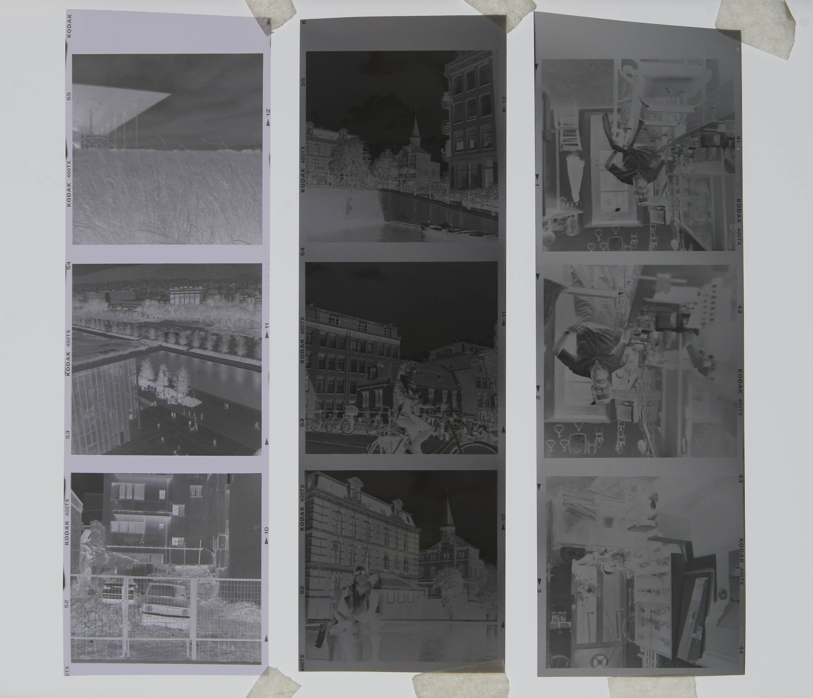

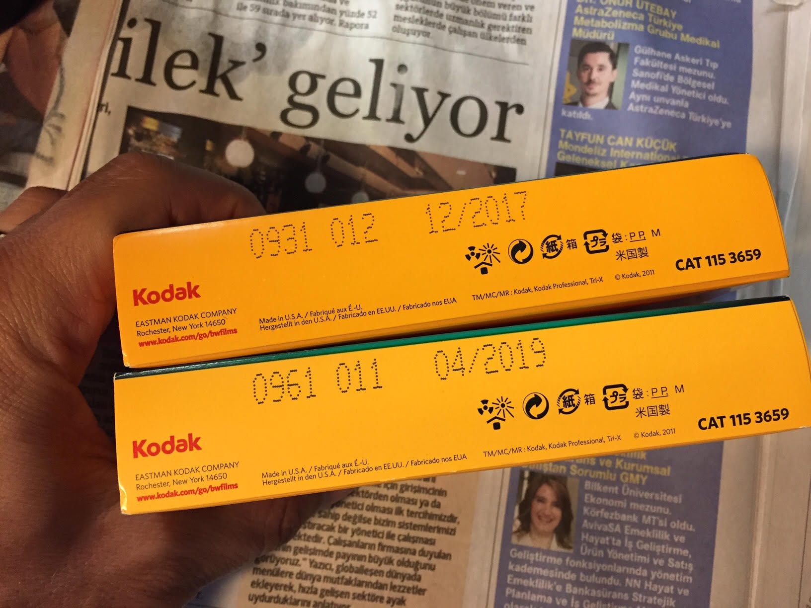

Hi all,
I'm posting some photos from the film boxes I used.One is old but not expired and the other very fresh.
From total 10 films I have problem at 7.
2 of the films are ok and 1 I will never know because I gave it as a present to a friend non photographer.
At the second picture you can see negatives from 3 different films.
One is good and the other 2 defective.
All at the same package.
Now I opened the other fresh package and load one film.If there is a problem to this also I will contact them again

1.I contacted KA a tprofilm@kodakalaris.com.Someone called Thomas j.Mooney reply to me telling me "I will ask my colleague in the UK to follow up with you directly"
Andrew Church follow.
I described my problem that my films have light leak or better its like there is light to all the surface even BEFORE placing to my camera.At spaces between the shots and also in the beginning and the end of film all along.This is impossible to happen inside my Rolleiflex 1.5B MVS camera because I'm shooting also slides,color films etc.To convince him I gave my Instagram account to go to see that my camera doesn't have any kind of problem.
My films are NOT at the bad batch numbers mentioned at this thread.
2.Before scanning this photo with the "kodak" logo I told him that I have problem with 7 from 10 films that are DIFFERENT from the affected batches and I have 10 more films at fridge.
I told him that I must shoot some from these films to see what is going on and he said this "Would you let me know your address and I will send you a new pack of film to help with your test."
I reply negative until to shoot more films.
3.I mentioned this but I'm saying again the numbers of batch is different than these that described here at this thread.
4.I didn't ask for new films yet.I told him that I will shoot some from the films that I have and see If are good.I believe that also there are affected.
Bought the first 5 from Turkey (from a store that is like the bigger film supplier ) and the next 15 films from a supplier in Greece).Both are affected.
5.No he didn't say anything
Now what I'm thinking of all this situation.
My problem started when I bought the first 5 films from Turkey.
After some days I went for a 4 days trip in Amsterdam with my wife.I took with me color Lomography redscale films expired.Found many at very cheap price in Istanbul.
Also took with me 2 B/W Kodak Trix films.There I shoot all the films including 1 B/W Kodak Trix.I didn't shoot the other.I came back and when I developed the film with Rodinal R09 developer I noticed the light problem.In the beginning I thought that this was fog from the airport.No other color film affected thought.
Then I shot the film that it was not exposed in Amsterdam.
The same problem.
Then I shot some others that was at my fridge and never traveled in Amsterdam :smile:)))
The same problem.
I made search at internet.Found this thread and some others for specific batch numbers.Looked at mine and were not these.But the problem is still here.
Only some days before after developing 5 films found this photo with Kodaks logo on it.
Thats all.
