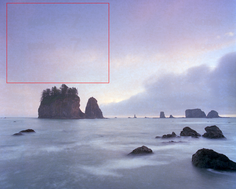

I am new to this post but I am glad that I have found it due to having the exact same problem recently with 3 rolls of 120 Kodak Ektar 100 about a month ago. All images have the imprinted backing paper wording on them, some more noticeable than others but will be contacting Kodak. I am glad that it is not just me and some mistake I made because previously I never had a problem with Ektar.

Can you share the "Best Before" date and the batch number?

I currently have two 5 pack boxes, but the one that I have had problems with are from batch 1231 011, Best Before Dates are 11/2017. I am attaching an example form the rolls. I highlighted the area where the imprinting can be seen best in red. Along with the imprinting, these rolls also have a very strange pattern throughout. The clumping pattern seen in this image are not present on any other scanned negative that I have done.

Yes this is the same issue. Sorry to hear. I had the same issue with Tmax400
Follow the procedure listed in the thread for contacting Kodak and I'm sure they will replace the film.

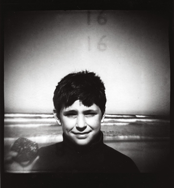

killing it with that photo too :sad: rotten luck
oddly i just saw a photo book today where it seems the guy was using this defect to great effect in his work. at least thats what i thought was happening.
It would have been perfect if Alex had actually been 16! (Diana camera, out-dated Tech Pan -- scanned silver gelatin print)
i like that one with numbers in - complements the lomo style vignette.

That's quite a nice image indeed (Iceland? That pointy islet in the middle distance reminds me of an offshore feature). I was not aware at all the backing problem could also manifest on Kodak's colour films. To see it like this is quite disturbing. I occasionally use Portra 160 but nothing else of colour in the Kodak line-up.
Note the defect as seen in message #1 in this message thread results in WHITE numbers on a positive print and NOT black numbers as seen on your attachment!
My numbers could have come from too much light getting through the red window while advancing the film (but one would think one would see the image of the window, also.. I'd have to track down that roll of negatives to see if any other numbers showed up. But it was film that expired a few decades before being used with an unknown storage history.
Josh's example in post 103 seems to be darker than the background sky.

Josh's example does appear to be different than the problems seen recently. It does appear to be much more like the classic problem with a red window or other source of unwanted illumination through the backing paper.
