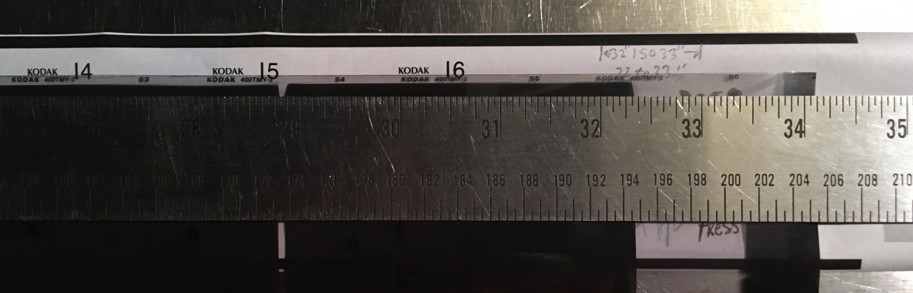

I stretched out a backing paper and marked where my Bessa II would position each frame. Then I oriented affected frames over their imprint (emulsion to corresponding ink image).
Rolled the film and paper together a bit and lo and behold. I have an alignment.
Image is where ink touches emulsion after it’s been shot and rolled on.
Three different affected rolls align this way.
So the image forms after the film is shot in all my cases. Where ink touches emulsion (and where a visible image develops), the film develops to less density than where plain paper touches emulsion.

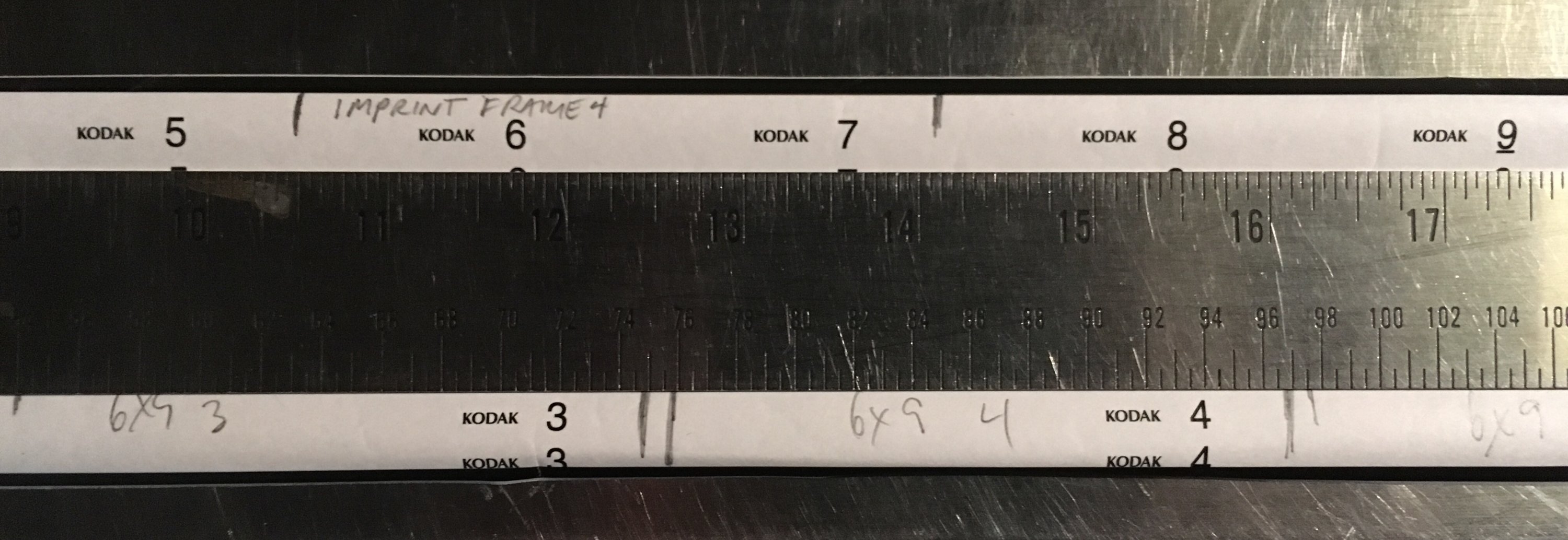

Check the frame imprints positioning.
If the frame numbers are less than the actual frame... it’s after shooting. If the frame numbers are greater than the actual frame then it’s pre-shooting.

Right, that’s what I meant. When it’s fresh, the backing paper of the upcoming frame(s) was touching the emulsion of the frame you are revealing. On the take-up side of the camera, the backing paper from the just finished shot(s) will roll under and touch the emulsion. The shift can be about two inches. The direction of the shift tells whether image formation occurred before or after camera exposure.
In a post from September 2017, I reported that I had a roll where I wasn’t able to visualize how the alignment related to the obvious ink imprints. I went back to my notes today. The notes identify the roll in question. I found the film and aligned it to my stretched out backing paper.
I found the shift. The shift is to the right. In this case the image formed before the roll entered the camera. This roll was impacted by poor storage before I shot it.
