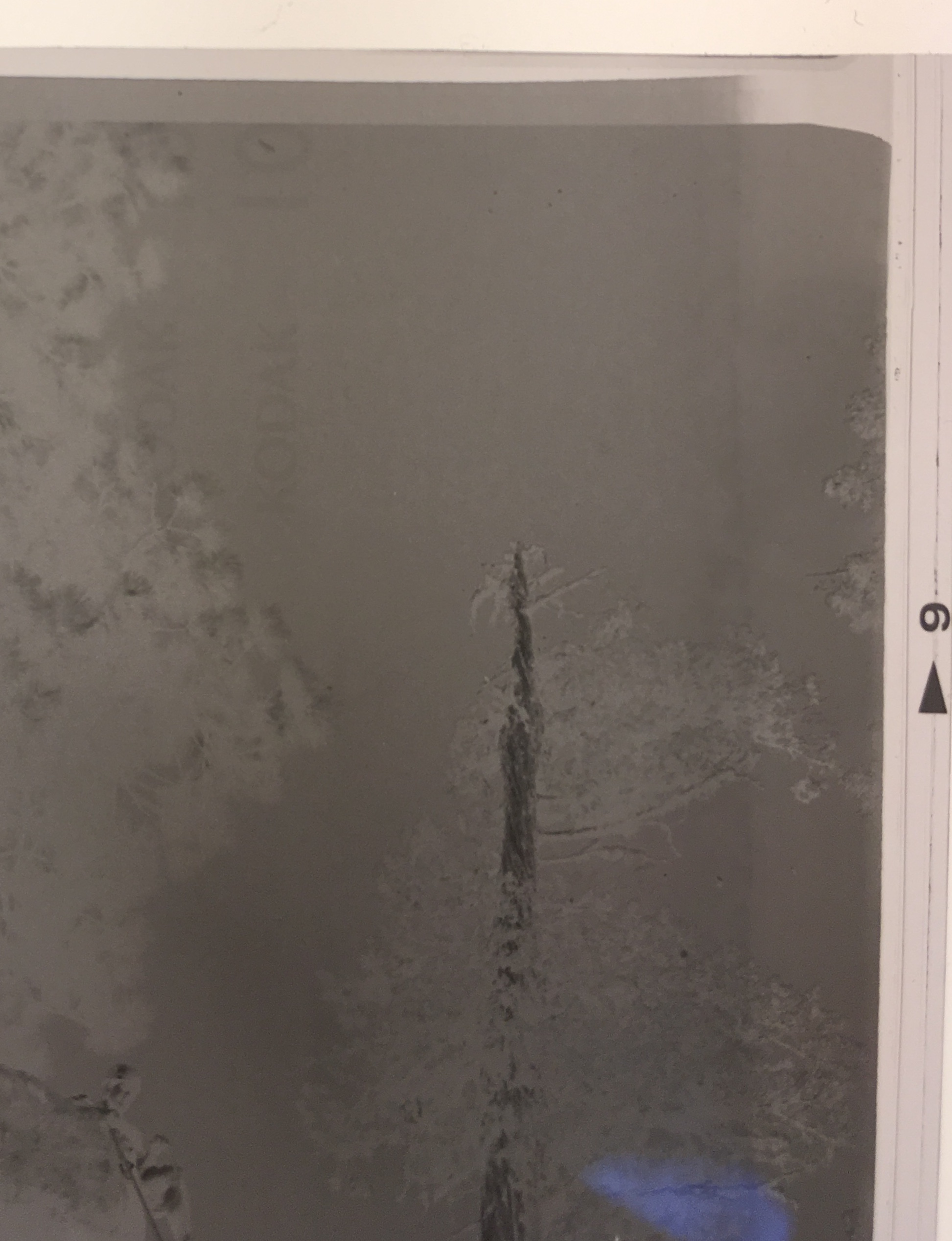

Went back to check my post from Jan 2018. In the example I show a frame with imprints from both before and after the exposure (vertical lines / #2). Film was opened right before the exposure was made.

6x9 frame 6. Numbers occurred "before" exposure. It's possible they occurred "in camera" - I went rappelling on the last full day of camp. It was really hot out there.
