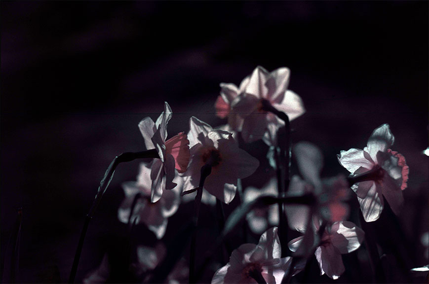

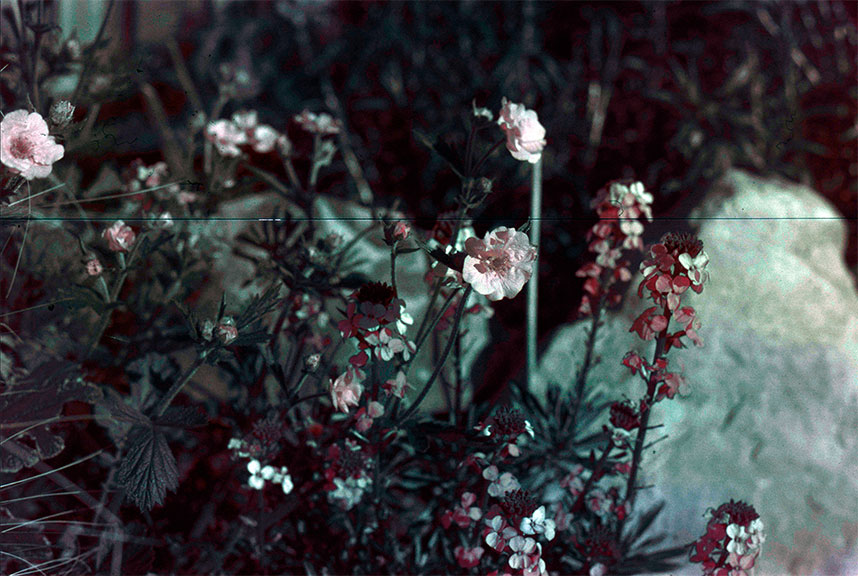

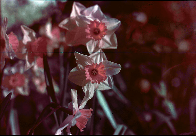

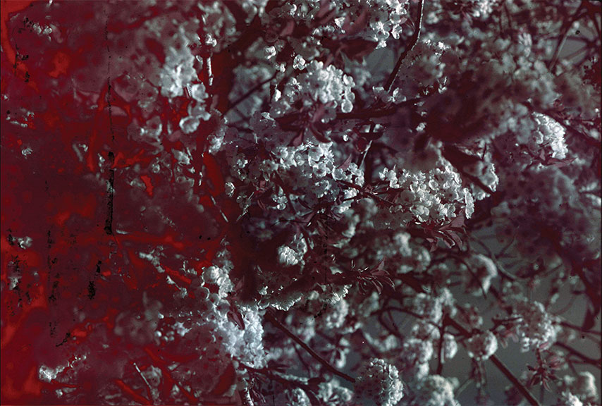

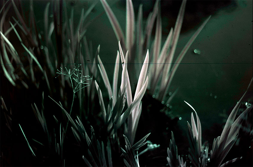

Kodachrome 25, 35mm, expired 2000, storage unknown (am willing to bet it wasn't kept in a fridge though!). Exposed as 20ASA, processed using the Mannes & Godowsky colour developers and the Bent & Mowrey patent first developer. I quite like some of the results, despite the missing yellow - if you don't overexpose sufficiently you have to extend first development time - which should normally be about 3:40 - 3:50 mins, in this case I extended it to 4:40 (which was still not enough), which I think basically wipes out most of the yellow, shifting the colours to the lower layers (thus causing a heavy cyan cast). I've also discovered that I need to extend the reversal bath time too, otherwise you get strange solarisation effects (like when your E6 colour developer is exhausted). More to come this week - K64 (unknown storage) exposed at 32ASA.
