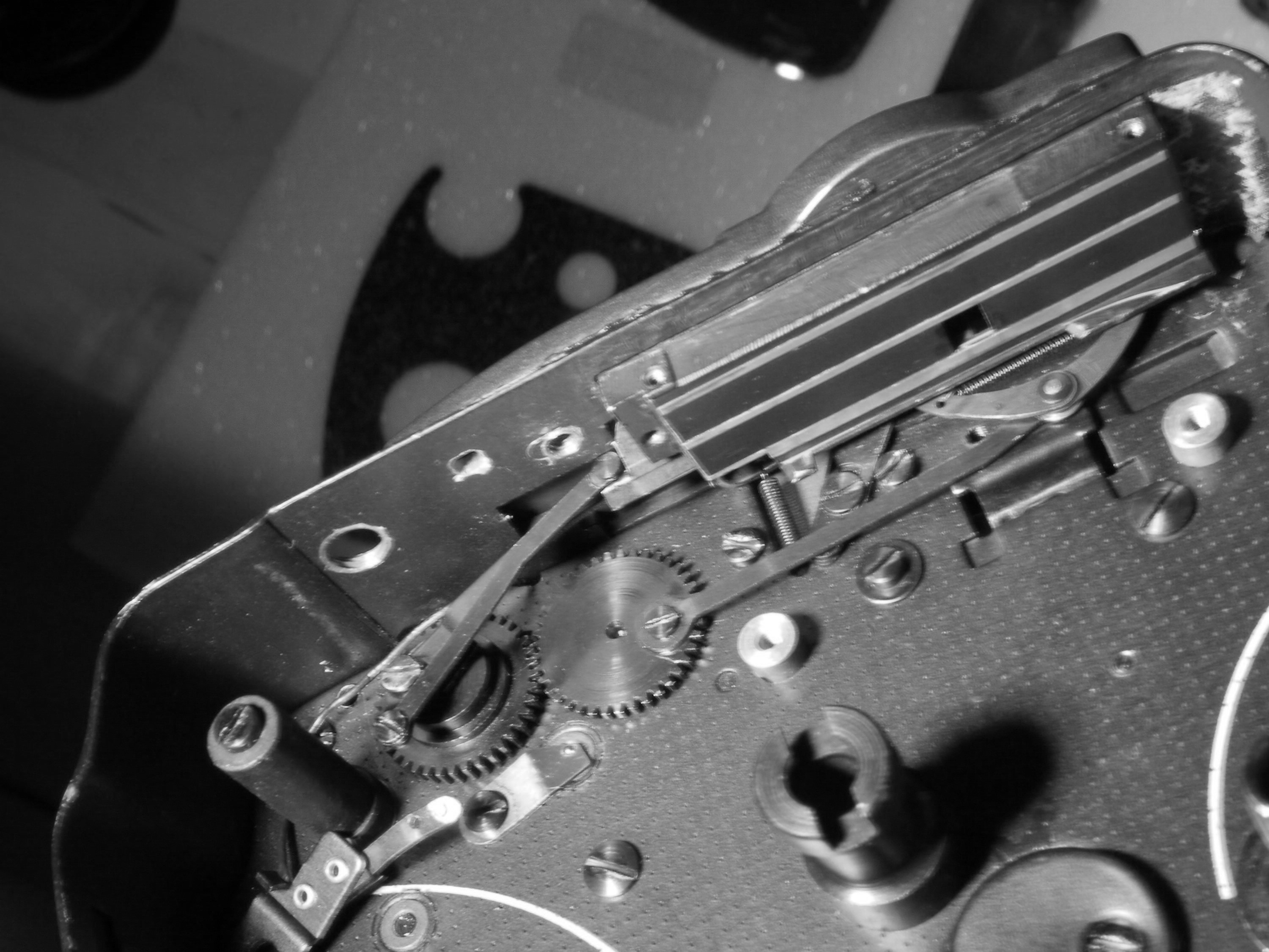

Here is a pic of a Beaulieu MR8. You can see the movement, how the claw and the shutter slides are actuated.
...Do you swim to and fro or do you have a little rubber boat for moving?
Icelandair is more efficient.
Nice. Thank you.
