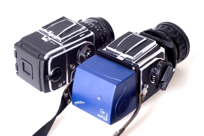

This was my Eyelike M11. I love the color from this back. Later on I also tried Sinar eMotion 75LV. But it didn't synch with the Hartblei. Currently I use P45+. I may upgrade to a full frame CCD back (P65+ or IQ180) later.

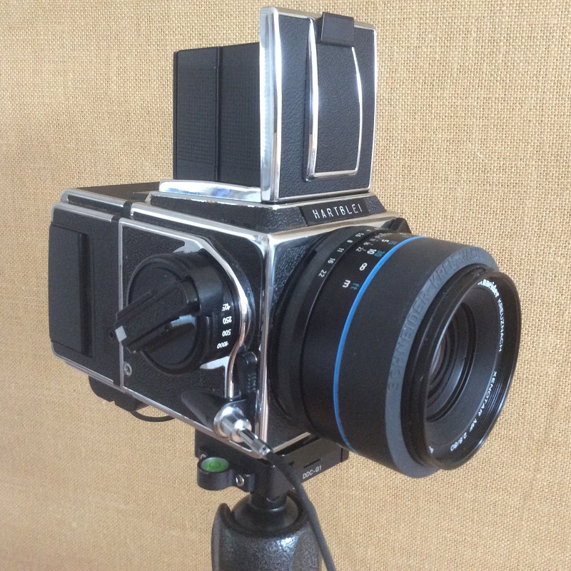

Attached is the front which says Hartblei. I am also curious because your lens shows a blue ring. Is that a Schneider lens for Kiev 88?
I see. So you have got the fake Hartblei from the former sales manager of Hartblei who is still running fraudulent hartblei com domain.
He was using old parts, out of which his technicians did some modifications.
The genuine Hartblei is under hartbleilens com.
Yes, this is Schneider Kreuznach lens but with Carl Zeiss Jena Biometar.
I got it from the USA seller for only about $250, so no big deal. But indeed the camera (shutter) is not reliable therefore I decided to remove the shutter.
Since your camera is a Kiev 88, did you modify the lens mount in order to take P6 lenses?
My camera was heavily modified by Hartblei:
the P6 mount is twist&lock (in your case it is breach lock). Additionally my Master 688 has mirror lock-up and modified long exposure mechanism.
My Studio Master I kept with Kiev-88 mount. This camera has mirror control mechanism allowing to cock down the mirror any time as well as to completely switch off the mirror movement.
Despite being more than 25 years old, both cameras are still fully functional. They both have black metal curtain shutters. As the chief of Hartblei told me, the camera was actually not designed to be used with a cloth curtain shutter. I took his advice and asked him to blacken the original brass curtain.

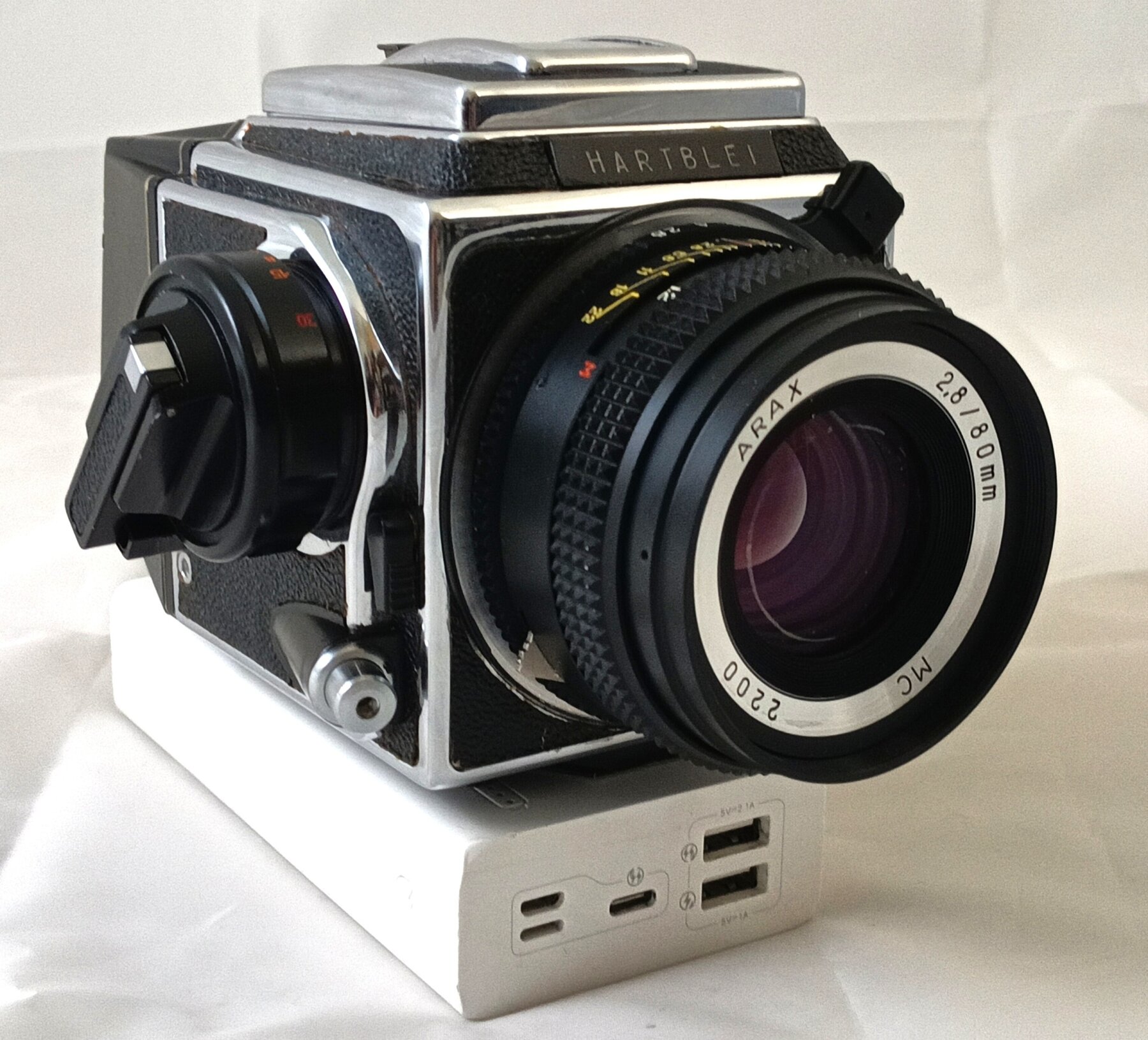

Ok, now I fully understand the background. Glad that you got the real Hartblei to modify the camera and it's been working fine. In my case, my camera soon got into shutter problem again after Arax's shutter replacement. So this 2nd time, I asked Arax to just remove it.
This time, I also bought an 80mm lens from Arax, but the front glass has been scratched in a circle (see photo).... So I am done with with this Kiev body route. In future, I will try to DIY some plate camera with P6 mount, and just use digital back's live view.
