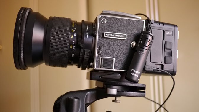

3. I have the Hartblei + Phase P25+. The Phase back can't be directly mounted - you would have to file the film gate etc on the body. Even then, the connectivity may not be secured - please use tape as insurance.
4. Sinar back may not work due to its wake up method. I bought a Sinar Emotion 75 and tried, it didn't work. I didn't do much further test / workaround and just sold it.
5. The Hartblei can synch under 1/30 with CFV back; For Phase, you can use a shutter button - after all, it is a switch button. So don't need to think too much about synch method. Think about evenness of shutter travel and reliability - this is its Achilles heel.
6. For the "button" switch, you can buy Canon rs60-e3, or use the Phase synch cable that have a small wake-up button built in the wake up cable. Of course, there are 1 shot vs 2 shots (latency) settings on Phase. But once we know it is all about switch "contact" for 1 time or 2 times, we will figure something out according to the situation. Leaf shutter or X synch method is just convenience, not necessity.
7. I contacted Arax about the "digital back modification" many years ago. They could not convert X to FP synch, but the technician was able to add a contact point on the mirror - so when you do the mirror lockup, the back will be waked up, then you can press the shutter to capture the image. As long as the mirror is up (and touching the mirror contact point), the back is always active. It will go back to sleep only after you advance the film knob and lower the mirror (the total back's active time may be 3-5 seconds). So you can ask Arax to cheaply add this contact point on the mirror - tell him that Yongfei's Hartblei got this modification about 10 years ago, maybe he will remember:smile:
Here are some photos. The Hartblei is mine (you can see the tiny button on the synch cable). I use this Hasselblad 2000 found online to show how the Canon switch works - it will wake up the Phase back upon pressing the button, no need for shutter or X synch. I took the Hartblei and Schneider 60mm F3.5 on a trip, and it can take beautiful photos. But sometimes the shutter travel was uneven and unreliable.

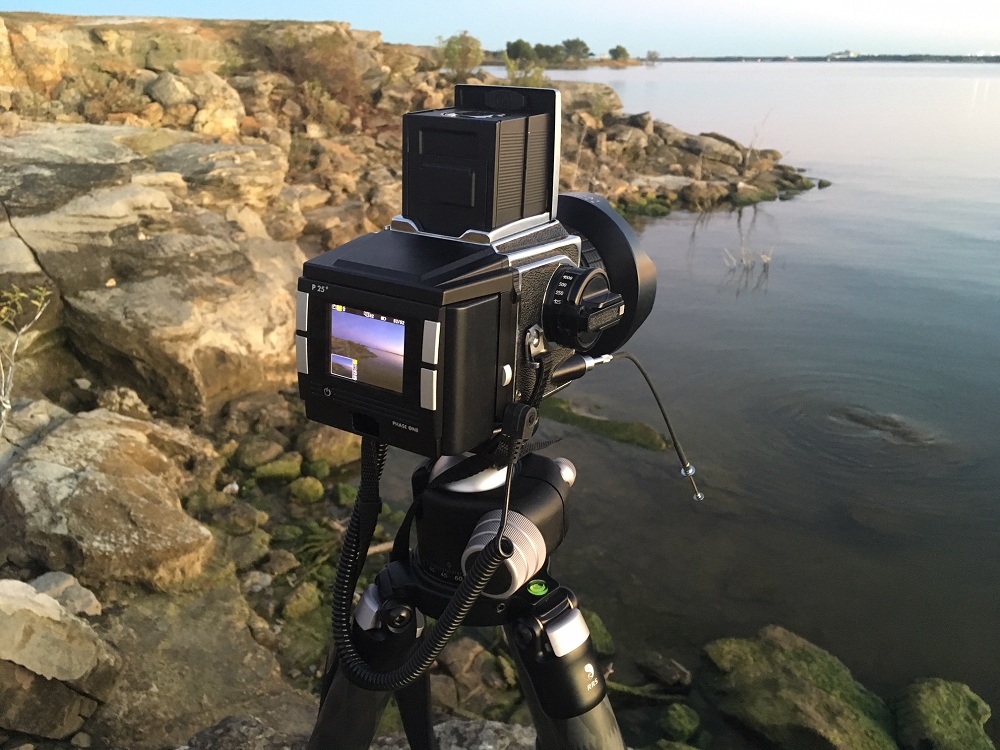

Eyelike M22 (22Mp medium format sensor) on Kiev-88 (I purchased it for 300 Euro at EBay). An iMac or MacBook Pro with Snow Leopard is need to operate the digital back.

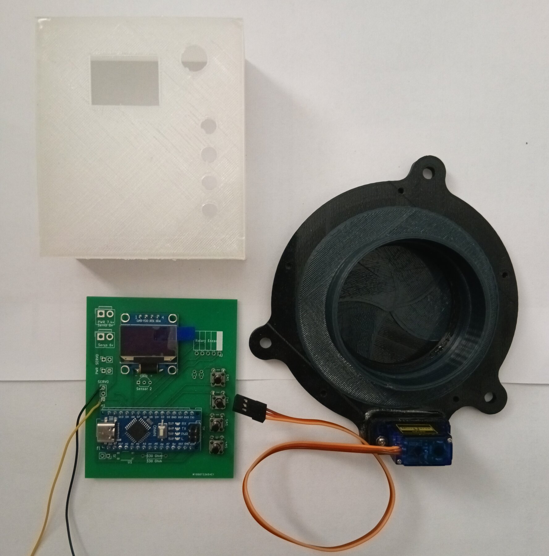

I have my Hartblei (Kiev 88CM)'s shutter removed. I plan to build a "3D printed large format shutter" and put it in front of the lens (check YouTube). Then use Arduino Nano (ESP32 S3) to control the shutter release. The speed will be under 1/15, but it will be more reliable and user replaceable.

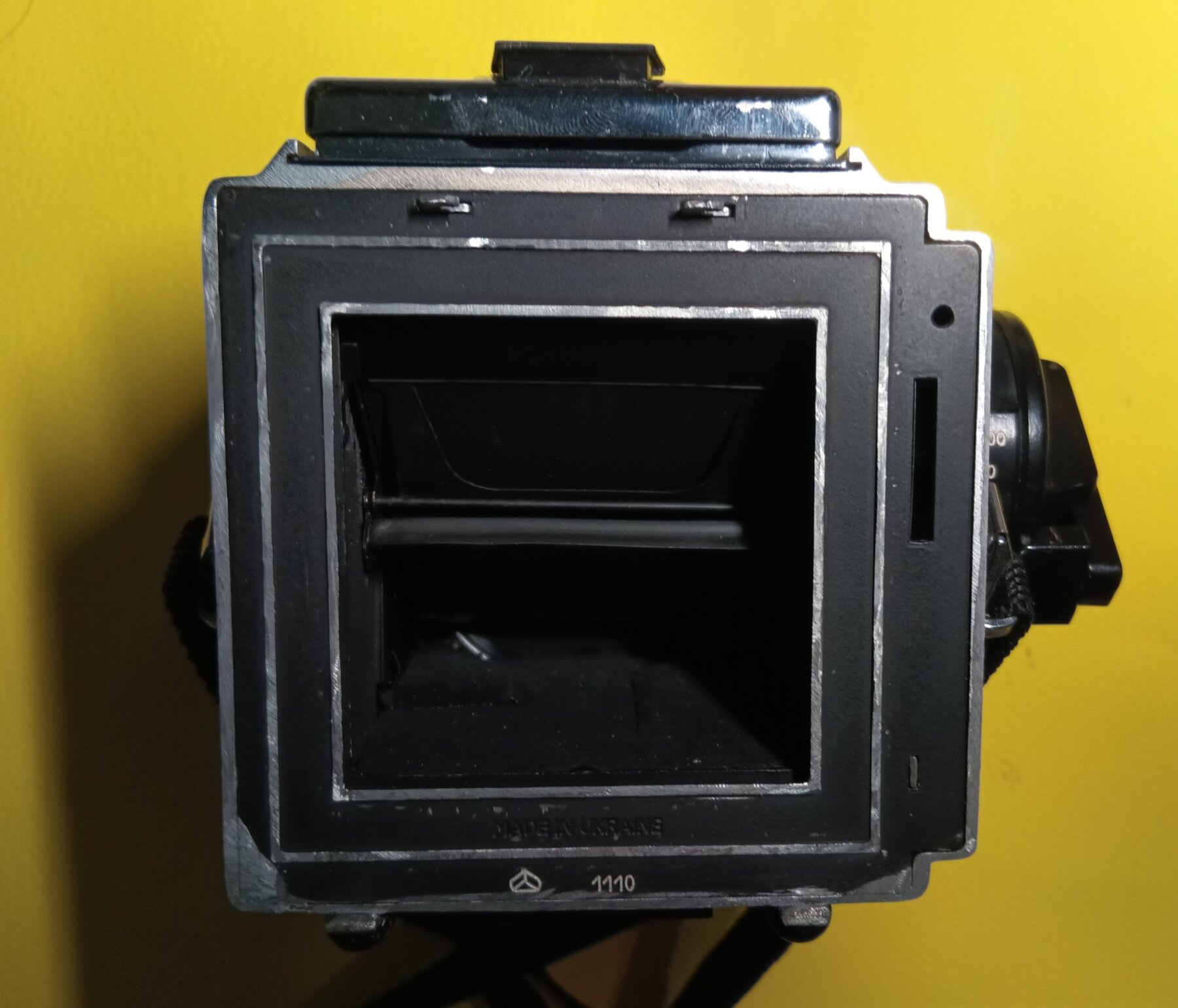

I think if you use a power tool to grind off the inner silver line (gate), the digital back will fit. And with digital back usage only, it is very easy to check the light tightness and fix the leakage. If the back has E Shutter, the shutter can be optional. That's the direction I will be going.
Well, I have a strong feeling that it won't work. I don't know of any back that works without synchronizing contact and the shutter. The only E-shutter that works is the one inside the Fuji GFX, but its electronics control it after the button is pushed.
In your scenario, if you can make the body (by grinding its interface) and back fit together, you can then just use the flash sync cable. With Phase P45+, I can use the flash synch cable (with an activation wake up button) and capture photos within 1/30. But my Hartblei got some shutter movement issue, so I had the shutter totally removed. I am not sure if it is going to work directly with the e shutter on CFV 100c - I can push the mirror lockup to have the clear light path. My current plan is to just use some in-front-of lens 3D print shutter and experiment with the old CCD back. The Arduino / ESP 32 S3 is very powerful because it can wake up the back and then make the exposure, trigger the flash etc in a pre-defined program sequence.
