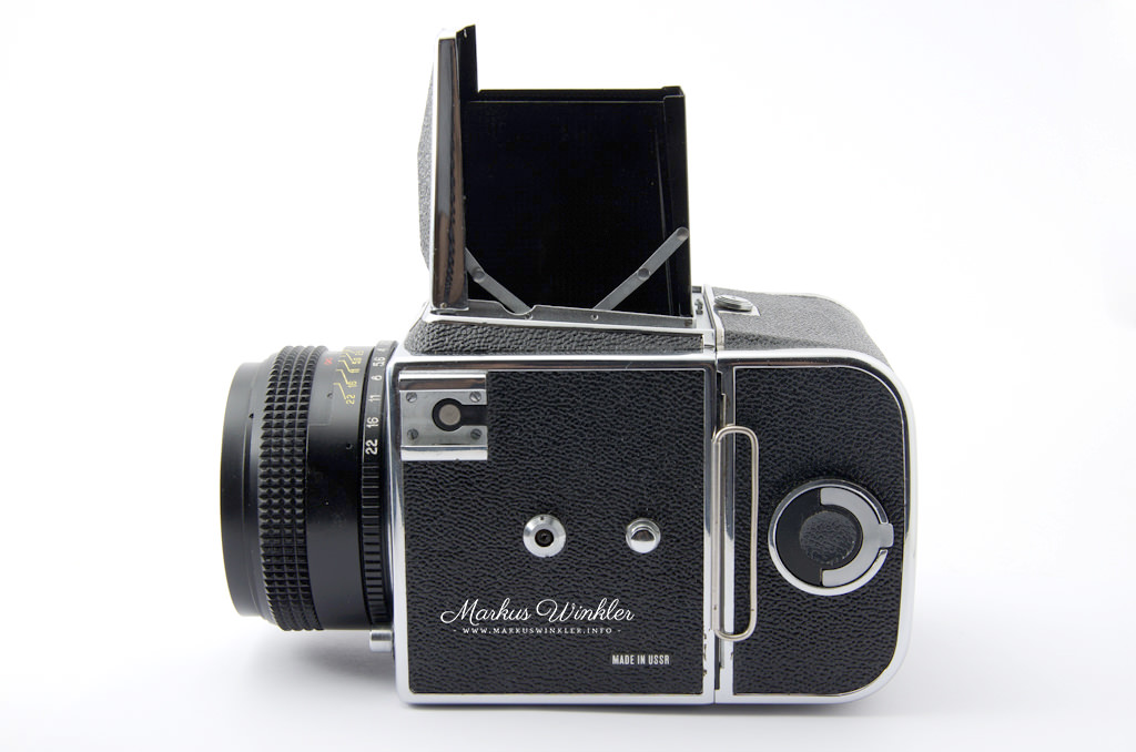

Hi everyone,
almost a month ago I saw, almost by chance, the "new" Hasselblad CFV system, which can also be used with analog cameras. My passion for technology and my vintage soul were thrilled to discover the union of medium format and digital photography. Since we're talking about Hasselblad, the cost of this plug-and-play system is high and out of my budget, but I didn't give up, and by searching here and there, I learned about Arsenal and Kiev 88.
I won't deny that from that fateful day until today, it's been a real roller coaster of emotions for me, because on alternate days I thought I had everything figured out and on others, nothing seemed to fit, combined with the fact that it takes me forever to make a final decision on the subject.
I'm therefore opening this thread to ask for help from those familiar with the Kiev 88 and digital backs to plan and complete this project, particularly @itsdoable who I understand has done something similar.
I should point out that I don't have any materials yet because I want to be sure of the compatibility of the various parts and their availability on the used market, and I don't know how quickly I'll be able to proceed.
Essentially, I'd like to connect the body of a Kiev 88, chosen for its affordability and the various lenses, its Hassy-chic look, and its robustness (at least once repaired), to a digital back. Since Phase One P45 or P65 backs with a Hasselblad V mount aren't available anywhere in Europe, I've opted for the Sinar Sinarback eVolution 75+ (Sinar backs are generally more readily available and more affordable) with the appropriate adapter.
Since I don't even own a Kiev 88, I've been looking at various offers, and now I have two options:
- the first is to buy a complete kit consisting of a camera body, two film magazines, a TTL pentaprism viewfinder, a waist-level viewfinder, Volna, Kaleinar, Zodiak, and Mir-26, 28, and 36 lenses for the super price of €500. This would be the perfect choice, except that it only has X-sync and no FP;
- the second option is to buy a camera body that doesn't work with both X-sync and FP, send it to Arax, and essentially upgrade it to an Arax CM: the entire deal costs about €680. This is in the price range of a Hasselblad 500C, but obviously you can save some money by purchasing Arsenal lenses (I'm not sure if Zeiss Jena lenses are cheap, to be honest).
So I ask @itsdoable : is FP sync really necessary for the digital back to work (I don't think there's any difference between Sinar and Phase One)? In theory, you can't set shutter speeds faster than 1/30, since that's the maximum shutter speed the shutter can be fully open.
Perhaps it's used to send the wake signal to the digital back?
In that case, can't a wake-up cable connected to a standard x-sync cable be used?

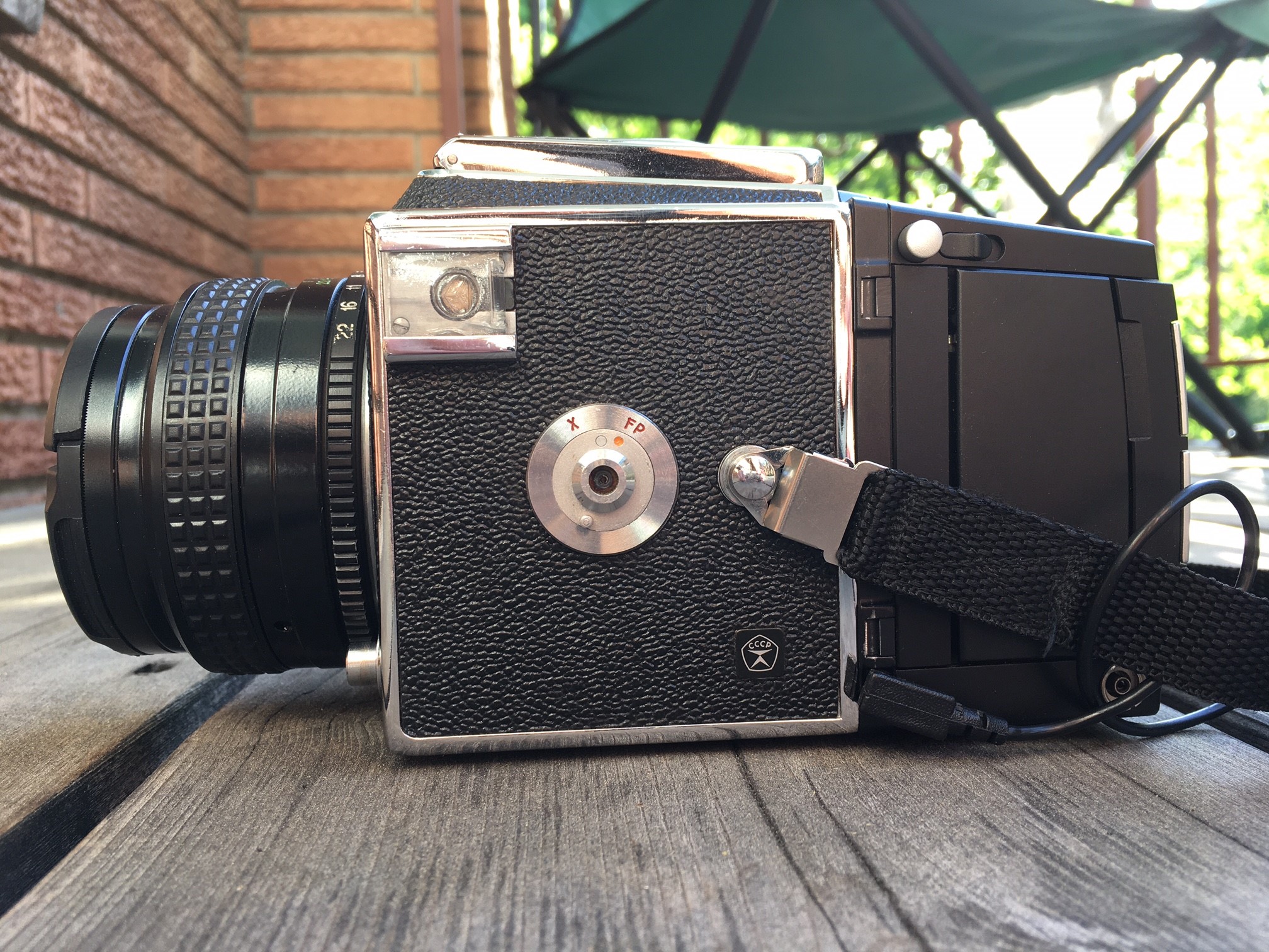

So it depends from one digital back to another if it syncs with the flash? What do you mean to use barrel lenses?
Since you said you have Sinars with a Hasselblad V adapter, I assume you connected the digital back to an analog Hasselblad. What are your thoughts on this? How did you make the connections?
I was using the backs on Sinar cameras. I've never used Hasselblad cameras.
Digital backs need a flash sync cord from the back to the flash sync port on the lens. Some cameras have electronic contacts on the body itself. For example, Mamiya 645 cameras have focal plane shutters and contacts on the body that mate with the contacts on the back.
If the Kiev has a regular flash sync port, you should be able to connect it to the back.
Barrel lenses are those lenses that have no shutter. Older lenses can give a very different rendering compared to newer lenses.
Kumar
Yes, in the late Kiev 88 (those most commonly found) have a X-sync port on the left side of the body, as show in the picture below
However the first production of the Kiev 88 had also a FP-sync module, so through a switch you could select both the old contact for the bulb flashes and the more "modern" one, as shown in the picture below (it's the Kiev of itsdoable)

Summary: basically I suspect you need a box that sits in front of the back and holds a lens, and provides X sync. Whether the box is a Kiev 88, Hasselblad, or a Graphic is likely up to you.
First, you need to understand how the body and back communicate about the exposure start. I believe with these backs, the flash sync contact is used to tell the back to start the exposure. I don't know how you set the exposure length on the Sinarback - I even looked at the manual, but it was not very informative. I think you need to tether a computer to do that (I also would not assume the software runs on a current tablet). I don't think it gets an exposure-end signal from the flash sync contact. The back was originally designed to work with X-sync (I think leaf shutter), which usually contacts at the start of the exposure, but it doesn't stay closed for the duration of the exposure. So I doubt you actually need to worry about having FP sync.
Next, let's assume you have a working Kiev 88 body with X-sync. You should be able to trigger the back and the body somehow (I dunno, a double cable release)? If you set the back to an exposure that is longer than the X-sync speed of the camera, then the CCD should integrate while the shutter slit travels across the focal plane. The effective exposure will be the camera shutter speed. That's exactly how film or a DSLR works.
Last, even if for some reason you were limited to the X-sync speed of the camera, which is 1/30 on the Kiev, then the additional speed you get by putting a big leaf shutter and barrel lens on the front is 1/100 or maybe 1/150. (Large leaf shutters are often slow at top speed.) Which is only two stops of exposure, and not worth the extra complexity. Just use the lenses that fit to the Kiev or can be easily adapted.
