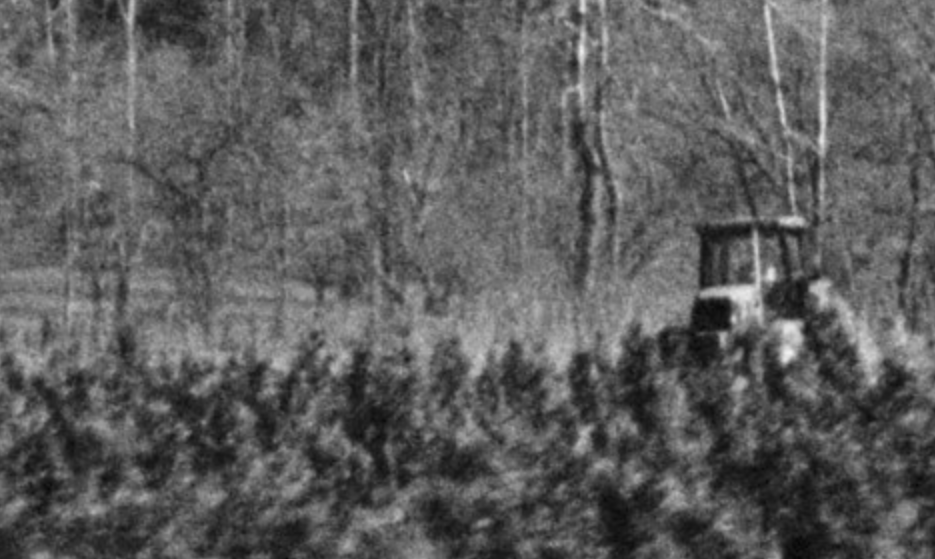

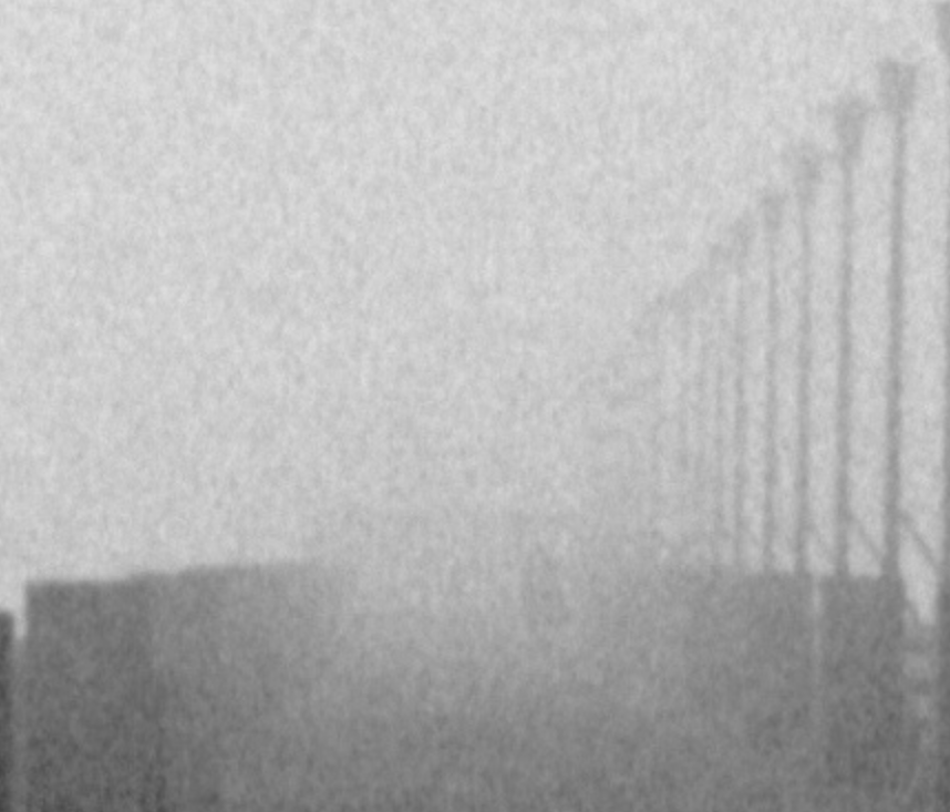

I actually have a quick question that just popped into my mind : is it possible, on the images of that roll of HP5 at 3200 in Rodinal that the grain appears not overwhelming (at least to my taste) because they were scanned on an Epson V600 ? Would that grain appear much more prominent if "digitized" with a DSLR and macro lens ??
Even modern film like HP5+ TriX, and even Kentmere are much more fine grained than films from the 70 and 60s, when pushed to 3200 a three stop push. I don't if the manner in which you scanned it made that much of difference.
The way the film is digitized does make a difference and a flatbed tend to smooth things out a bit.
The grain will be blurrier at a lower resolution. How contrasty the grain is largely depends on how much you or your scanner's software increased the contrast. Also, the last thing you want to do is use a sharpening radius setting that primarily sharpens the grain. I don't sharpen at all. These are Tri-X in HC-110.
I'm not very well versed in how much films that have existed for a long time, like Tri-X or Ilford films, have evolved over time, but yes, they usually look less grainy to me than old photographs. I suppose I'll see for myself when I try to digitize them if it looks really different.

Thank you for your answers !
I scanned them at 2400dpi (which, as far as I can tell, is the maximum realistic resolution of the V600). As for the contrast, I think I tried to make them quite flat (I don't remember exactly, that was like... in 2021, maybe). I don't remember either if the V600 does some sharpening or not. The results I've shared have not been sharpened in Lightroom, at all. And they looked like straight from the scanner.
