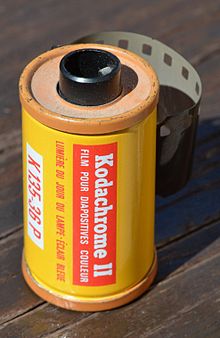

Can undeveloped K II still be developed as B&W today?
What is likelihood of there being an image after 40 years?
Probably - it is black and white film (until processed).
I was able to get images from 70 year old roll film: https://www.photrio.com/forum/threa...year-old-verichrome-and-super-xx-film.136477/
I would be most concerned about the physical issues - how permanently curled the film would be, how difficult it would be to handle the film - including removing the remjet - without damaging it beyond use.
As it is movie film, it wouldn't help you much to have it come out in pieces.
If it goes about the rolls of film never saw a lab - you reported this issue before : From my point I would have no great hope to get nice pictures ever from this rolls. The max. time you can store latent images from exposed Kodachrome should be in the near of 8 years.
(within this time it should make sense to see a chance to get nearly normal colors)
It seams to be min. the double of stable E6 colors (long time undeveloped but still exposed)
To proceed the bw step from developement is a total diferent issue.
But real good bw negatives are also not possible (after 20years). You might see this term from historic context. That might make sense.

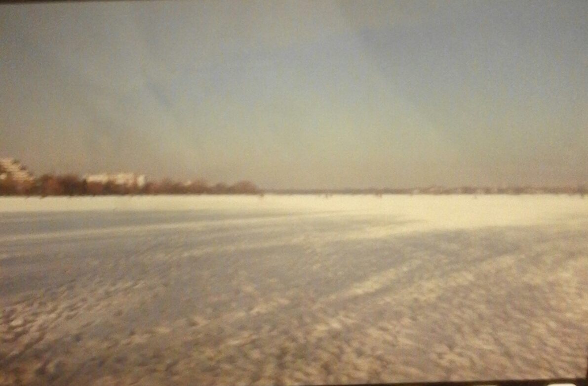

By the way : The most stable E6 film in concern of latent images and in concern of long time stability of colors (I hope) after developement is Fuji Astia.
I just recived one of my last (forgotten) films back from a lab.
I can't belive the date of exposure (2009).....?
The special characteristic is a lost of saturation - but without a noticable shift of colors. See :
Notice : The shift in direction of yellow is just coming from a thungsten light in a restaurant here. (I shot the film a little unsharp with cellphone) just to document the colors.
[the snow on the lake is nearly white from the original Astia slide]
That's remarcable - but Kodachrome is the all time champion in that special discipline.
