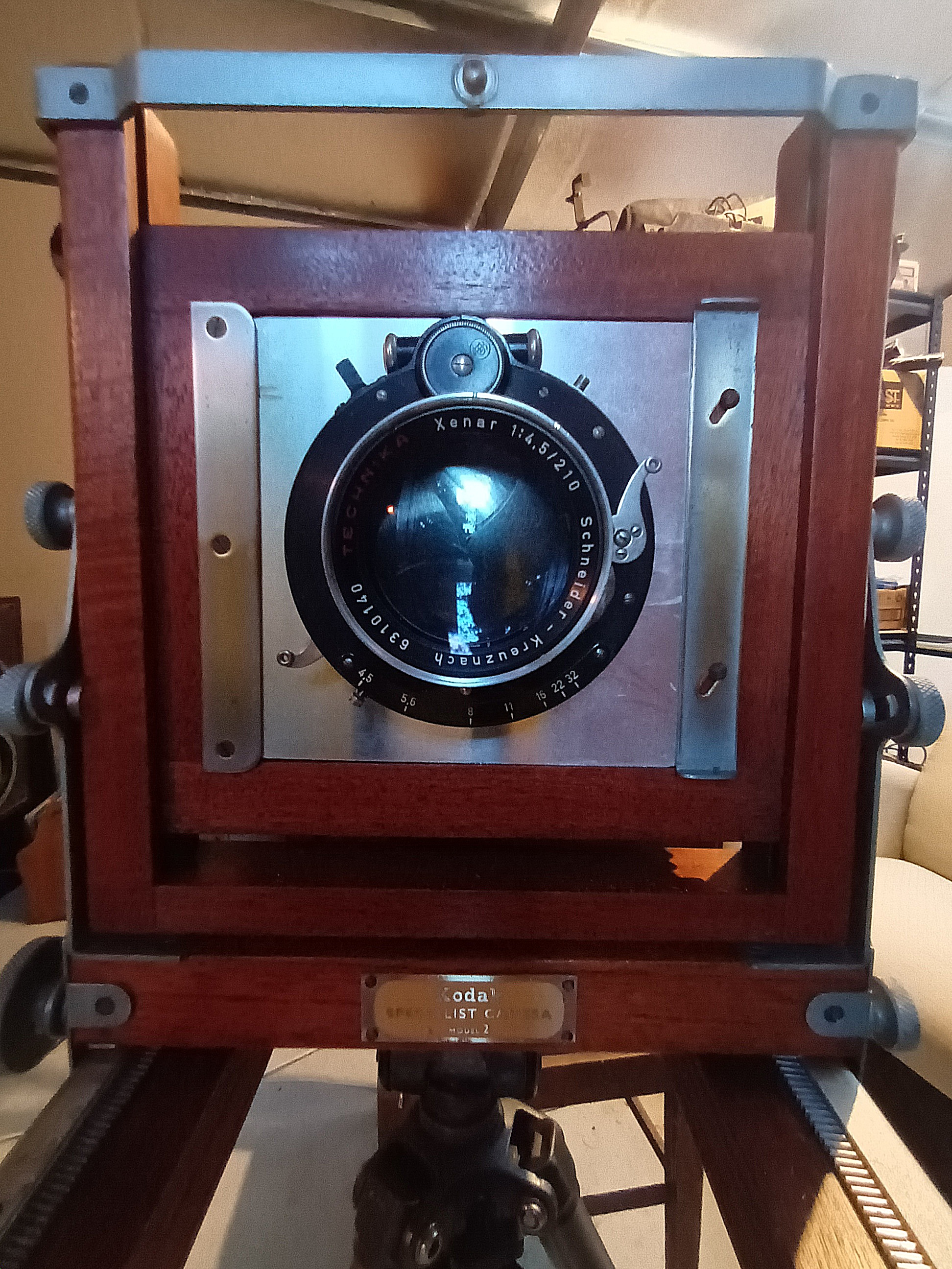

While I mull that over it needs a good clean otherwise it's a good solid camera. Bellows look original and solid, all the knobs are there, timbers beautiful.
Lens is clean, shutter needs a clean.

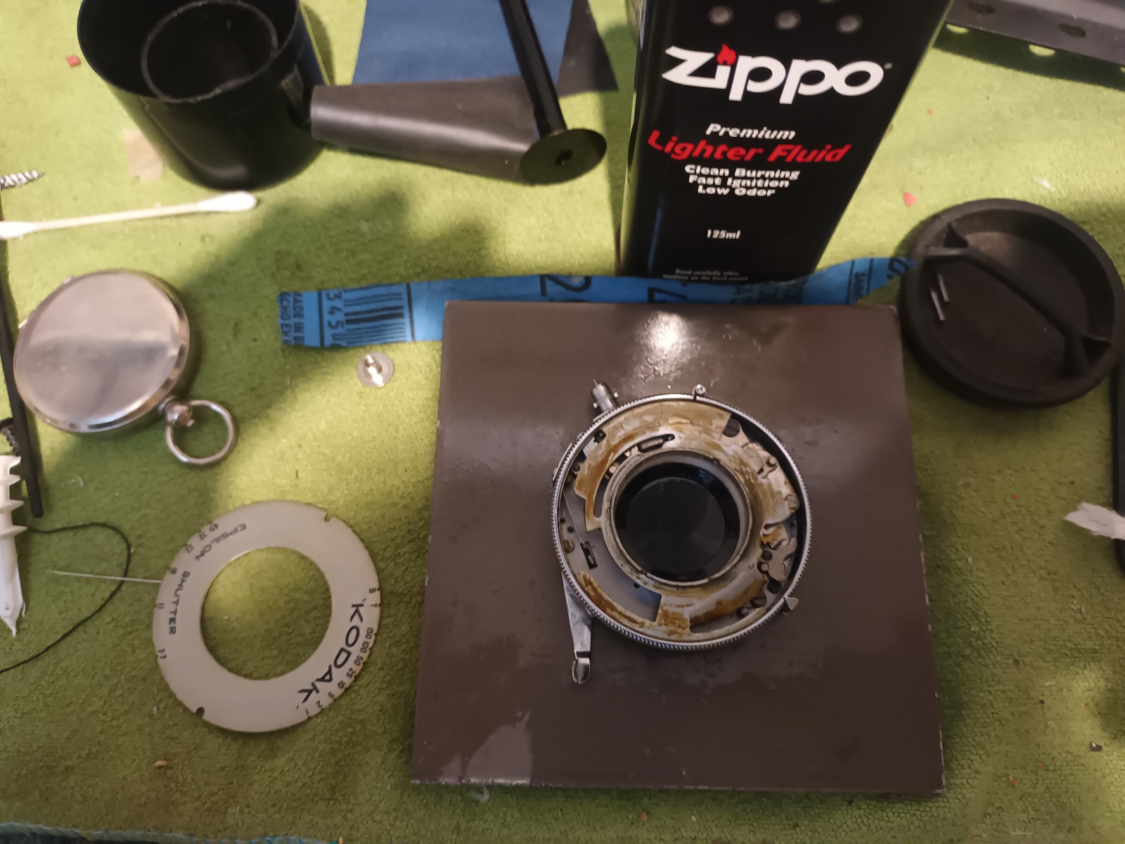

Did a basic clean and lube on the shutter, all speeds are working again. Glass is clean.

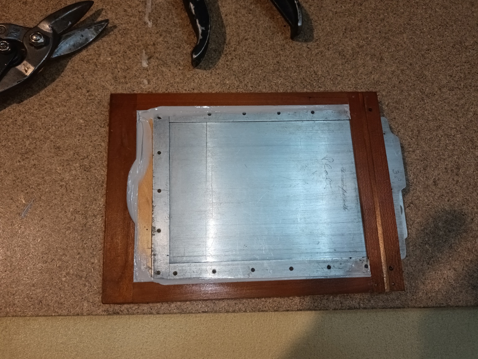

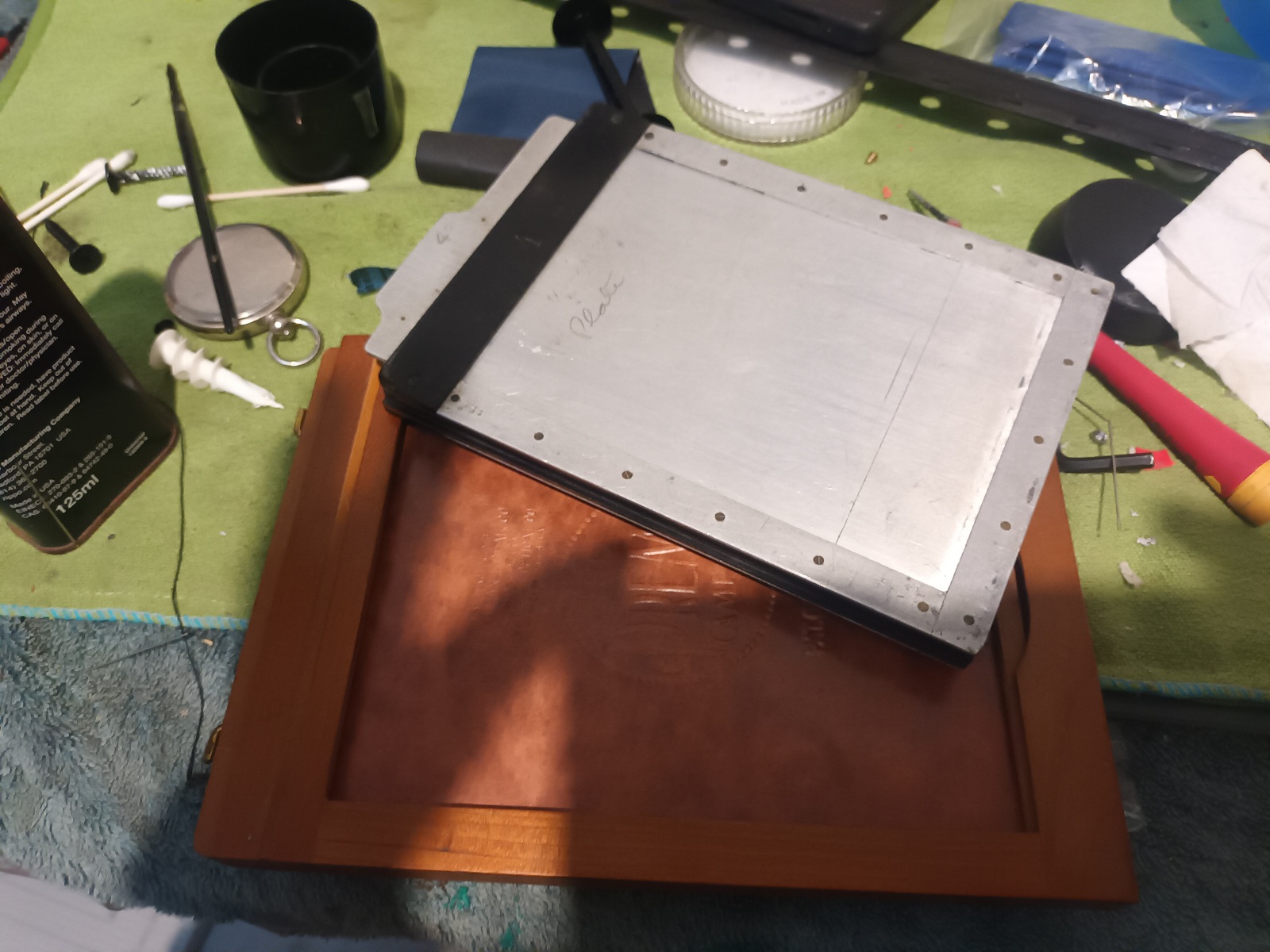

Decided to convert a half plate holder to a 4x5 wet plate holder, merged two together.
Modified (butchered) a Kodak half plate to take 5x7 plate, till I can get the real thing, now I can tell the difference.

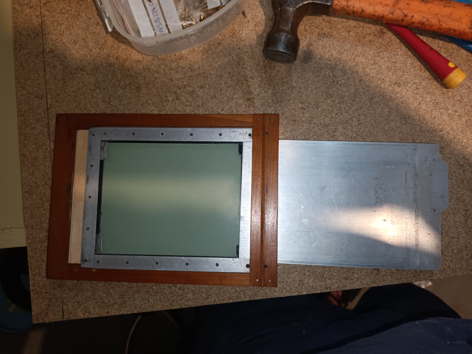

View attachment 324163View attachment 324164View attachment 324165

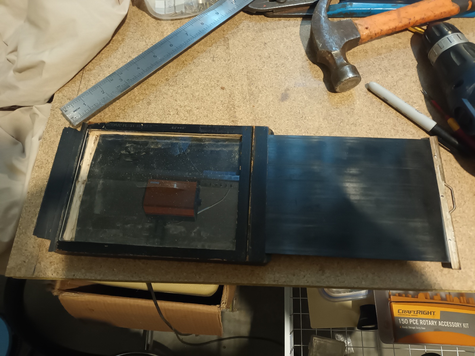

I'm going to try an adapt a 8x10 film holder, have one I made for another 1/2 plate, just need to make some more modifications. Have a Orbit C-1, but that requires a crane to move it.

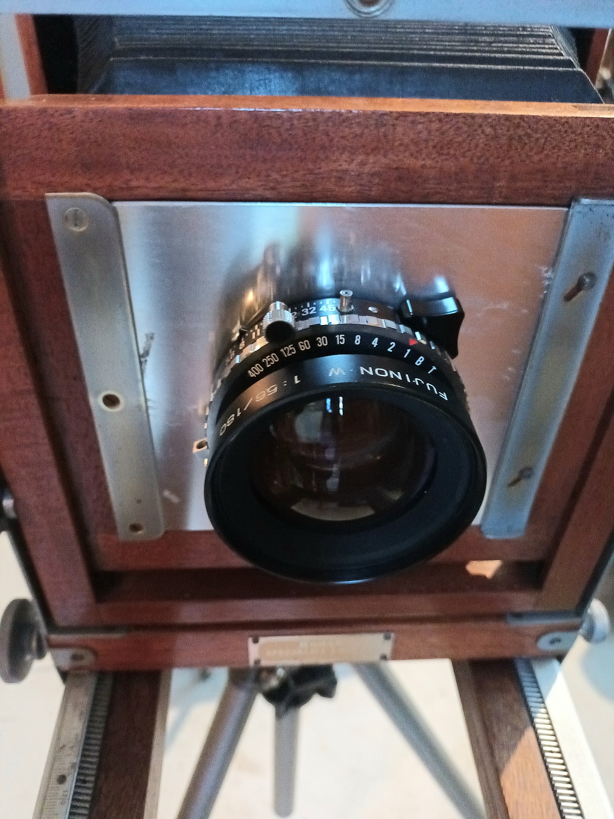

An iris lens board would be really handy.
Made a couple of basic lens boards with sheet aluminium backed with black felt material, seams to seal well......why can't all cameras just have the same lens board.

Most of the time, lens board size for large format was pretty much determined by the size of the format/camera. Big camera = big lens board. The worst match up I've seen is the 4X5 Busch Pressman D. Very nice camera, but tiny lens board. Certainly limits what lenses can be used on the camera. Most 8X10 camera lens boards were fairly large, but not always the same size per manufacture. I feel your pain!
Because then Sinar couldn't charge you $200 for something you could get off eBay to fit a Graflex for $15. This why I'll probably stick with my same cameras (Graphic View/GVII and Anniversary Speed) forever -- they use the same 4x4 board that I can make in under an hour out of masonite (or 10% more time to make four), with a utility knife or hobby saw and a hole saw in a hand held drill.
I made an adapter lens board, so I can use my Linhof/Wista lens boards on my Specialist 2. One downside to these cameras is it's hard to use a WA lens. Mine came with the 4¼" (108mm) f6.5 wide angle, technically it's a f6.5/11, meaning f6.5 for focussing but widest useful aperture is f11, comes in a recessed lens board as part of the kit with a fitting in the top of the case to hold it when not in use. The downside is it doesn't have a shutter.
