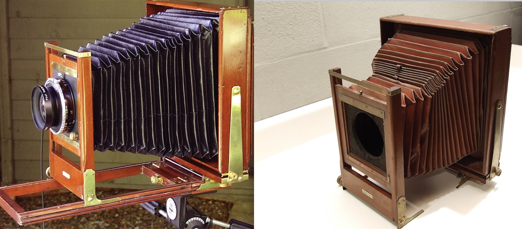

Next in a long line of "Cameras I Will One Day Sell" is my first wood camera, the venerable Kodak 2D, nicknamed "Betsy". Finished fixing her up today after several days of work. I like what she brings to the table: strength and simplicity.
Never liked wood cameras much, even the best-made ones, like Lotus or Chamonix.
Not a knock on the companies or manufacturing, just my preference for cameras that can handle all of nature's elements and provide a good/high degree of precision.
The 2D is not my first, or fifth, choice for a camera, but these days I'm just happy to have an 8x10 back in the house after a 2-year hiatus. I'm liking the ease of use, and the fact that I can make most replacement parts myself, if needed.
But I've already spoken to Betsy, and told the old girl that while she's still got "it", she's just keeping the seat warm until I can save up enough for an Arca Swiss. Given the economy these days, Betsy may be around for a long time.
Just finished a rough adapter board, and now shooting some film to test lightproof-icity.
And now, Betsy's master plan: to cost you so much in 8x10 film that you can never, ever afford that hussy Arca Swiss.
Betsy's got the chain on you, and she'll never unclip it.
She does have a great personality, but honestly I don't need help burning film; I do that quite well on my own. :smile:

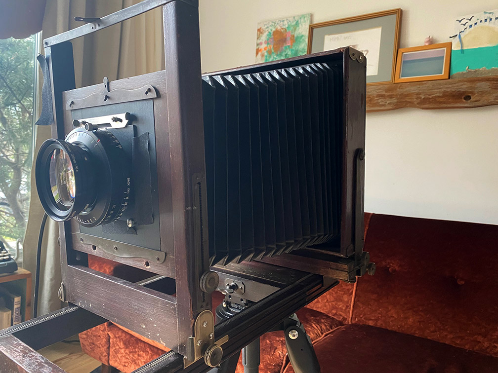

Jim Galli is loaning me a Kodak 2-D while I save up money to get the next 8x10 (sold my Tachihara). Comparing to the Gibellini (4x5), it's definitely "old Plymouth truck" vs. an Italian modern car ;-)
(the center column on the FLM tripod [thanks Ari!] cranked up all the way to match the height, ha ha)
Yours looks pretty nice, Richard; congrats!
I definitely like the big lens boards and the ability to support big lenses.
Soon I'll be getting a Kodak 12" Anastigmat and a 12" Ilex Paragon Anastigmat; big suckers, both.
By the way, does anyone have a fix for the front rise? Mine keeps slipping down with a big lens mounted.

Mine is a loaner, so...
Say, do you still have that Cooke XVa? Anyway, I presume you do know that normally you pull out the front standard knob to hold it in place right? Of course if the gear is worn or something,...

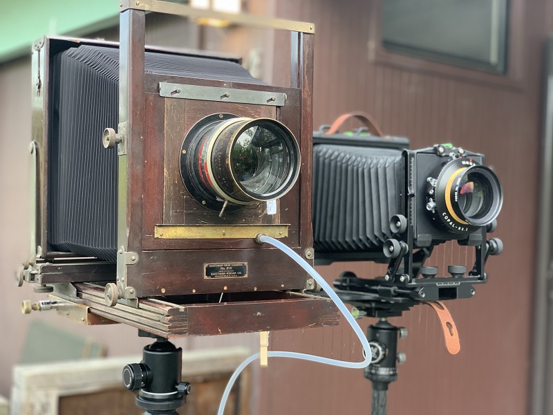

The knob on the right side of the front standard pulls out to lock in place. I don't worry about small amounts of play in the camera. I'm mostly using it for wet plate so precision isn't my biggest priority. What I like is it's solid enough to hold my big 19th C. lenses. A Chamonix would never be able to to do that. I'm using almost every inch of those 6x6 lens boards!

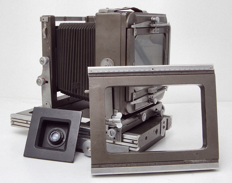

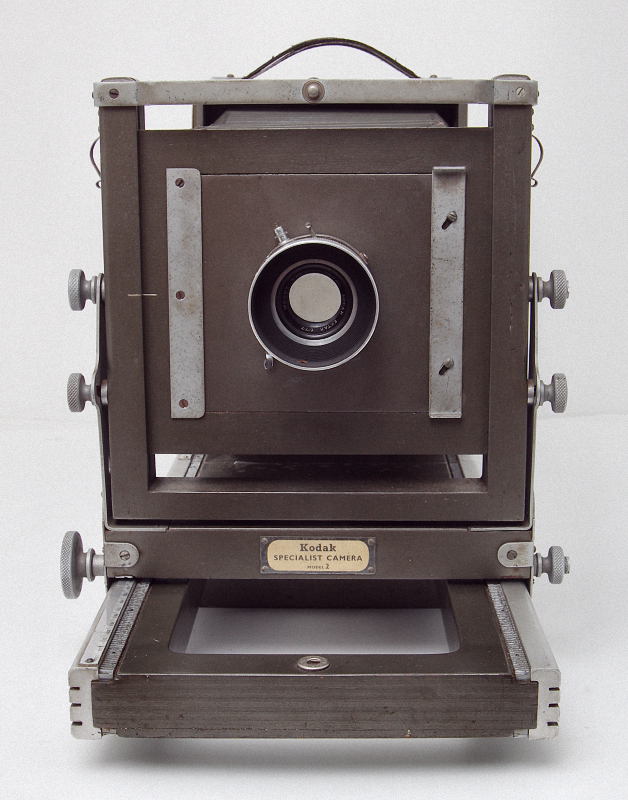

2D's were made for a few decades, and they were made here in the UK as well as in Rochester, they also evolved slightly. Here in the UK by 1940 the 2D was listed as The Kodak View Camera" and available in 3 sized Half plate, Whole Plate and 10x8. After WWII here in the UK the Half plate 2D was upgraded to become the Kodak Specialist 2, the major change was slotted aluminium edges to the base and extension rail and a metric scale on the base as well, this gave greater precision and rigidity, oddly the lens boards fit 90 degrees right to left rather than top to bottom.
The standard lens was a 203mm f7.7 Ektar, mine's in a Kodak Epsilon shutter (Ompur/Copal #0 compatible), the 2nd lens came in the Kodak outfit case as part of the kit and is a Dallmeyer 4ÂĽ" f6.3-f11 wide angle, f6.3 for focussing, f11 taking. While the camera is Half plate it's an International back so 7x5 DDS and 13x18cm DDS will fit as well. So effectively the 2D continued into the 1960's.
Like Ari I made a conversion lens board so my camera can use my Wista lenses, I'm using a 240 Nikkor W as my main lens.
Ian

I think the problem is that the 2D evolved quite significantly over the years and hardware definitely changed. Someone posted images of a 2D here a few weels/months ago and it had all the same geared movements as my Specialist 2
Here in the UK the only US style field cameras were the Kodak Ltd 2D and Specialist 2 and a couple of Kodak metal field cameras, they are a sort of cross between the traditional British Tailboard cameras and the Continental Reisekameras.
