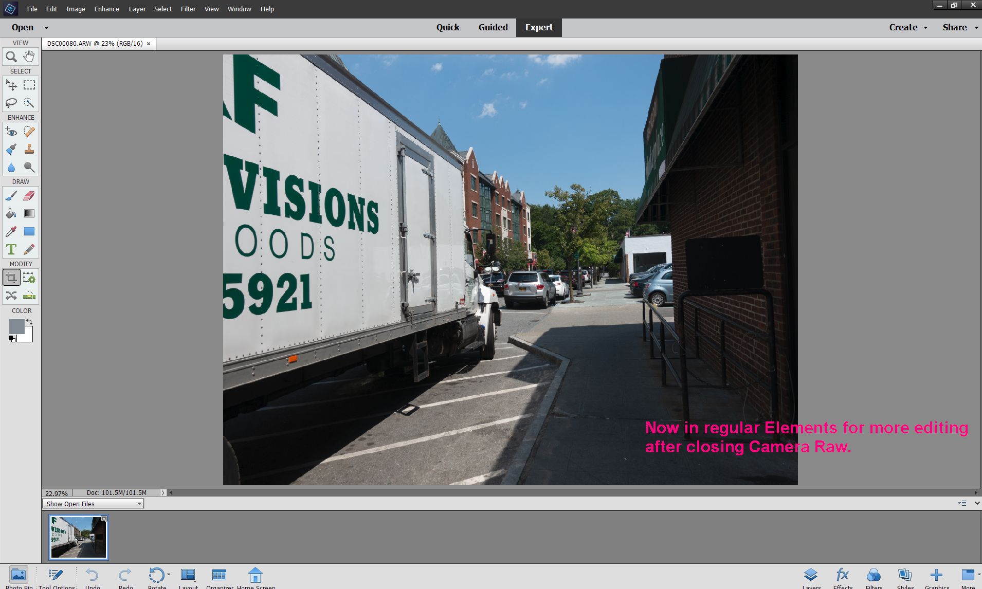

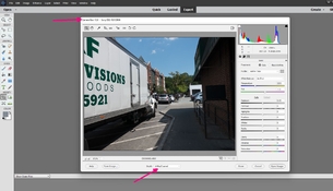

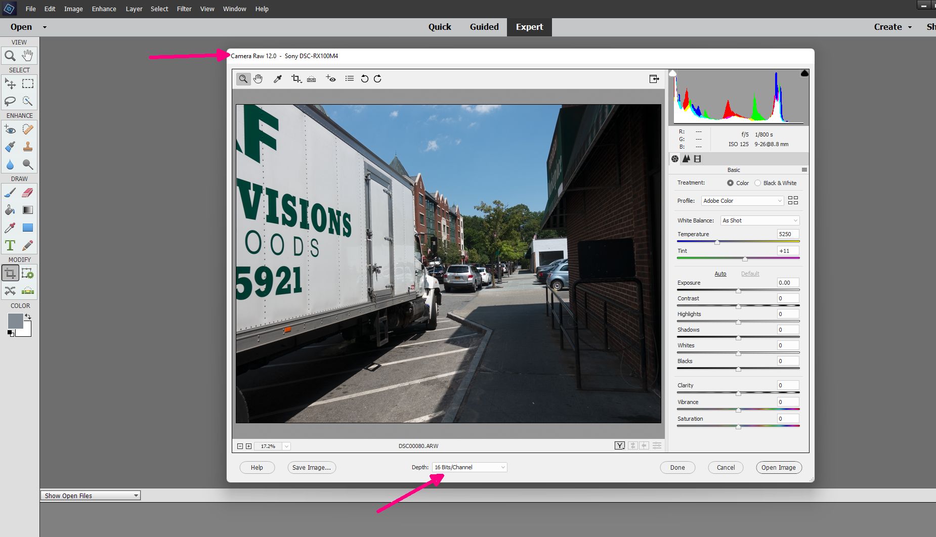

Sal, Does your earlier Elements have Camera Raw? THe later Element versions (see pictures) open RAW images in Camera Raw 16 bits. When you close it, it then opens Elements that will continue to edit in 16 bits except for certain kinds of edits, and even if you use them with 8 bits, you already took care of most of the exposure edits with Camera Raw. I don't know what an upgrade would be but it has to be fairly inexpensive. Just check that it handles your camera.
Left picture in Camera Raw then you close and it opens in regular Elements right picture.
