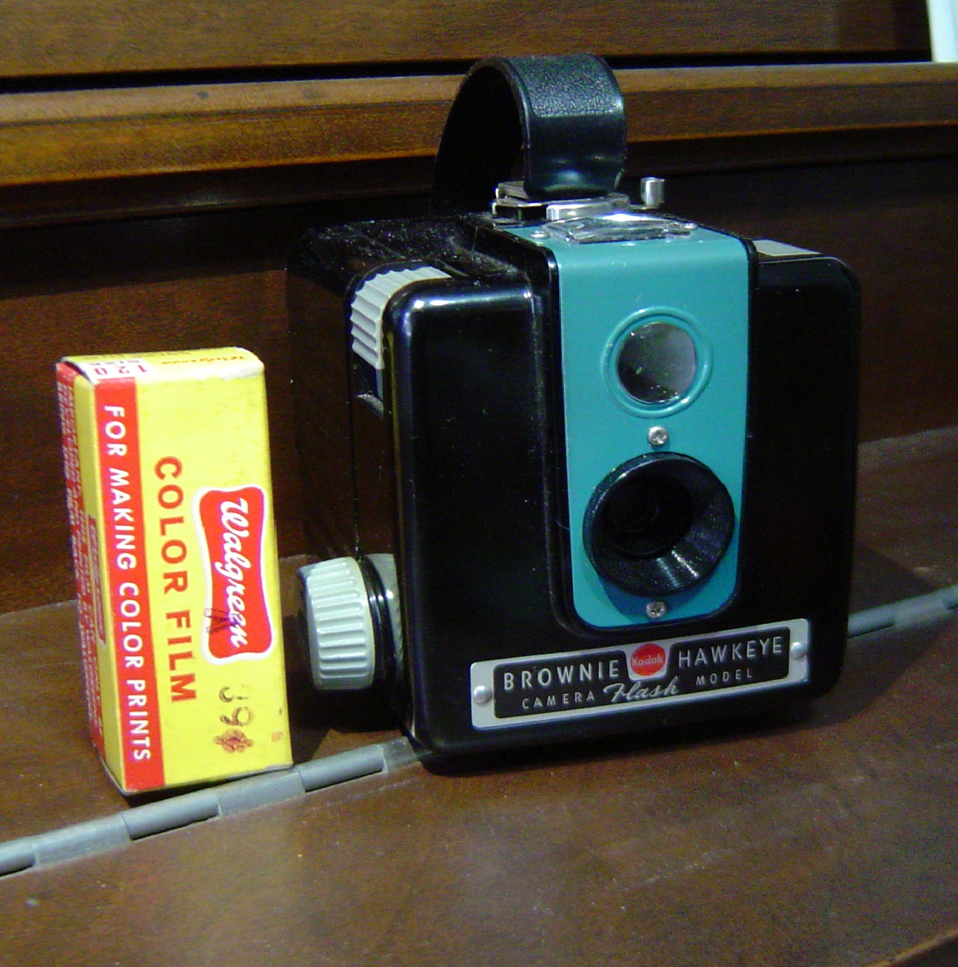

I actually made an error when I said f/125. It is actually f/212. Laser cut .4mm pinhole at about 3 3/4" inches to the film plane. I've shot with it already, and I'm quite pleased. I had to add a tripod socket to the bakelite case and a shutter cable release socket to it to make it film ready.
I painted the front teal color so I could tell it from my other (un-modified) Hawkeye.
