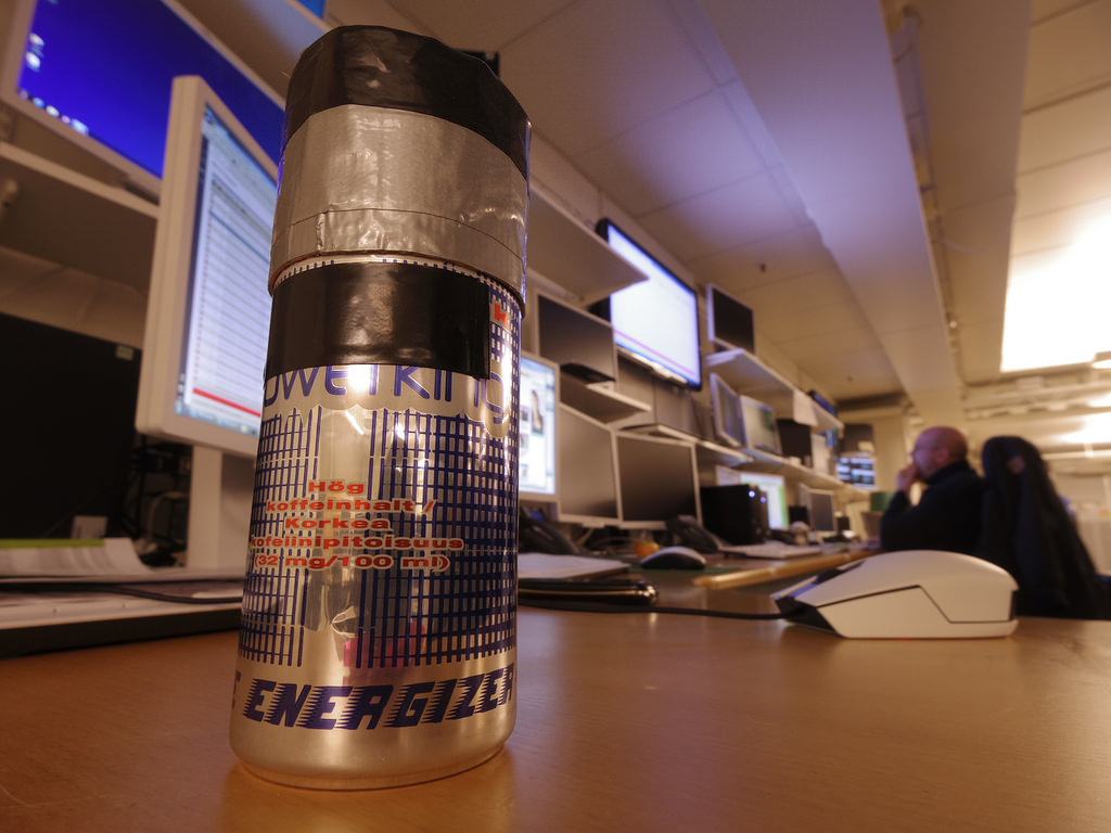

Here is a pinhole, shot on 4x5 tmax100 (old) in a energydrink-can!
What the lines come from - I dont know, I got them on all five sheets I shot...
10 minute exposure in the centre of Stockholm (sweden)

Just a wild guess -- is your film wrapped around the interior with the ends overlapping? Could be a difference in anti-halation properties where there is an additional layer of film against a shiny can sidewall.
Cool shot anyway!
Cool shot anyway!
Thank you! Well no, the film is not overlapping itself, however the edges of the film is very close to the pinhole itself, perhaps 2cm on each side. I thought that maybe the light catches the edges of the film and is reflected to the oppisite side? I am eager to try this again, but perhaps with a can that is a tad bigger in diameter, like a regular beer-can or alike.

Perhaps the lines are formed by an internal reflection. Is the interior of the can shiny?

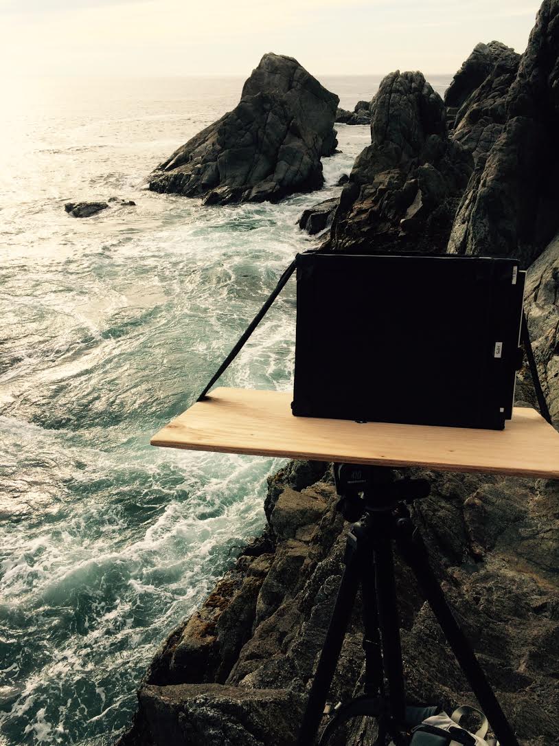

Originally I drilled a hole a little smaller than the t-nut and pounded it in with a hammer. That worked fine for a couple years but got loose when I put bigger heavier cameras on it. Then I used epoxy it and it lasted for quite a while, but failed again. The wood is too soft. Now it is held in with "gorilla glue" and it has been solid ever since. This is a very handy platform that can be used for all sorts of cameras, and the cup hooks / bungee cords allow various options for holding a camera in place. Thanks to Joe VanCleave for this idea.. I use this all the time.

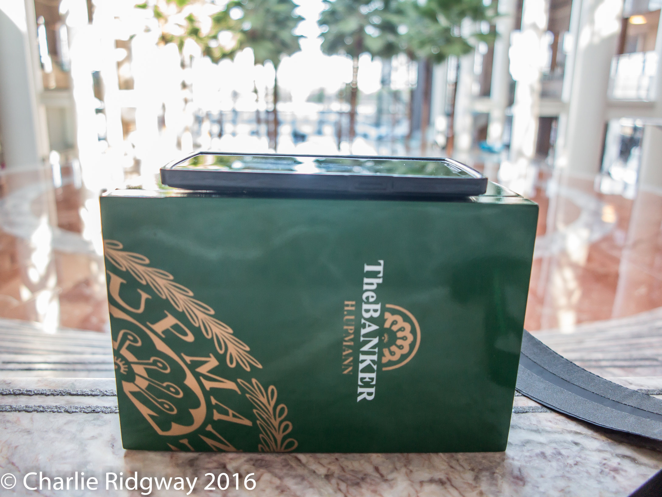

rsz_1img002.jpg This image was made at the Winter Garden in the World Financial Center, NYC. It was supposed to have rained that day so I decided well in advance that I would photograph my second favorite public space after Grand Central Terminal which I imaged last year. It turned out to be sunny that morning but I had previsualized so went with it.
rsz_img_3220.jpg The image was made on Ilford Delta 100 in TheBANKER. I think it is 60mm and f/168. Exposure from multiple spot readings but cane out to be the same as the average reading my tablet program calculated. I didn't want to disturb the enamel so I put the pinhole in the bottom of the humidor (makes it easier to load the film too) and have to set it on the ground since I didn't build in a tripod mount for the same reason.
