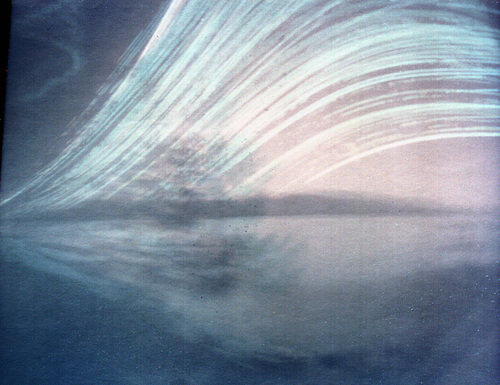

In the window of a cabin, looking out at the lake, exposing night and day. And you're right: that tree lost its leaves all winter then grew them back in the Spring! The streaks are the sun rising and crossing the sky each day. More here.
Very nice photos - thank you.
