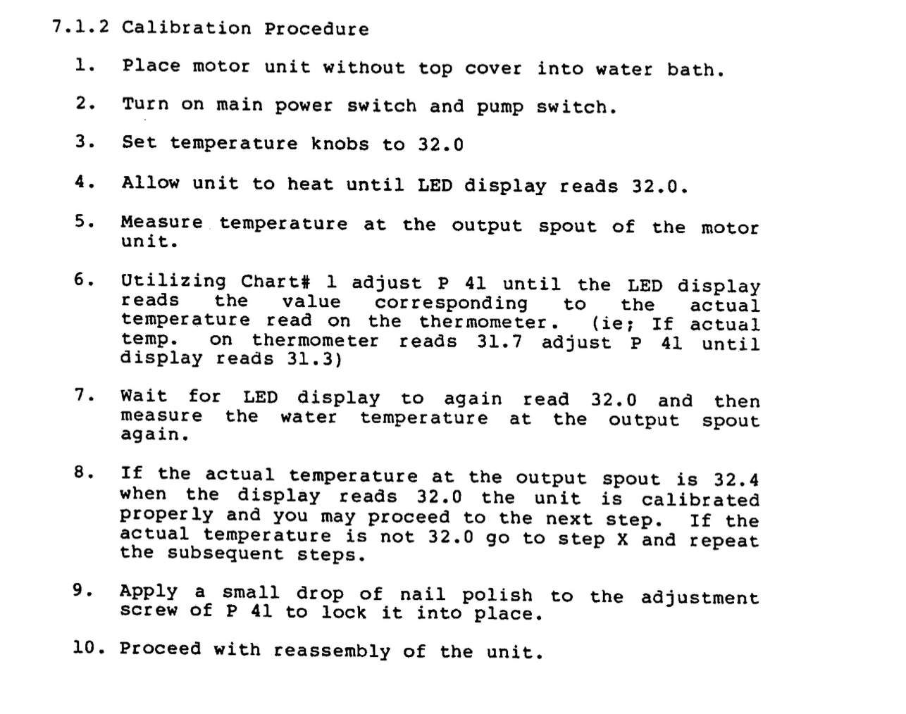

Not sure in re-reading this thread if people understand how the Jobo works. Over one hour warmup is needed. The temp one sets on the knobs is the processing temp. The water bath temp is about one half degree centigrade higher if the Jobo is functioning correctly. This is all in the manual.
For example Page 25:
So the manual for my CPP-3 does not have any sort of chart like this. But I did double-check, and it apparently has a settings menu screen where you can actually configure the difference between "indicated" and "real" temperature. I'm curious what mine was set to out-of-the-box, but I should check it. Of course I also need a good thermometer for fine-tuning it.
(Almost all thermometers claim a margin of error greater than the range we're fiddling with, so I'm not sure I have anything good enough on-hand.)
That chart was from the CPP2 service manual. Usually adjustment would only be needed if replacing the sensing probe or someone tampered with the settings.
