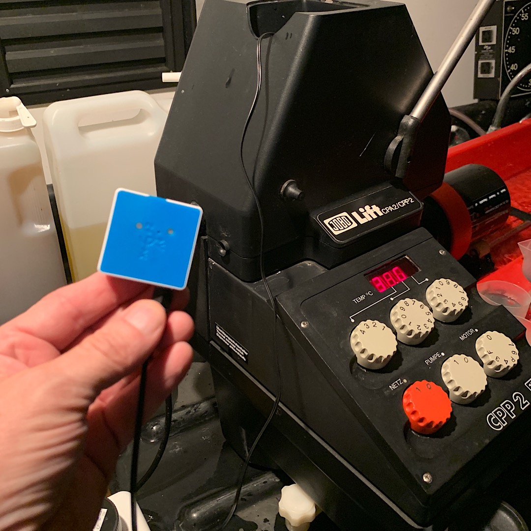

What I am sharing here is a method of monitoring the temperature inside the drum during processing.
The sensor connects to a smart phone and displays the data on a graph over time that you can also record to a CSV file.

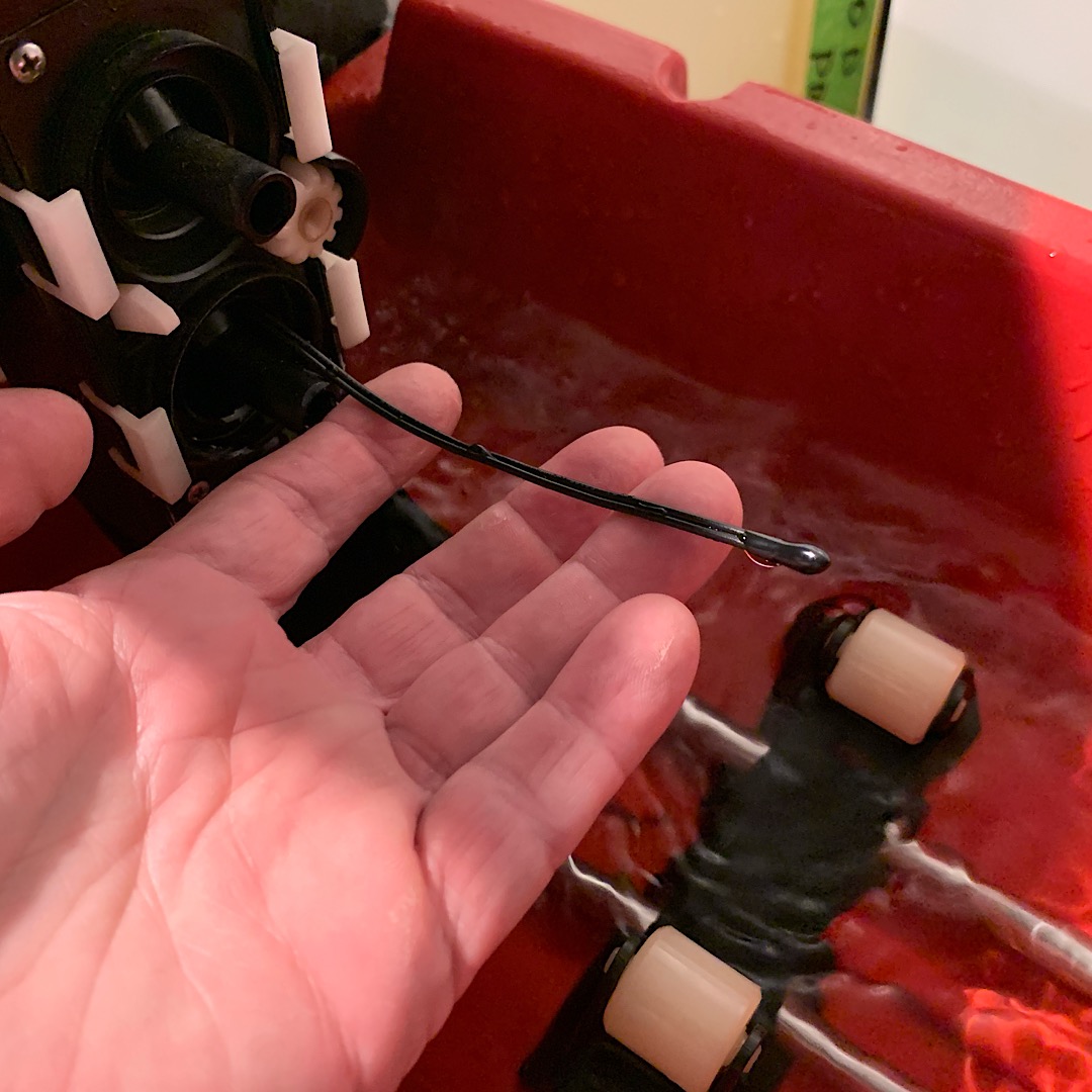

The only tricky aspect is feeding the temp probe down the inlet to the drum. I used a piece of string,
washing the string down the inlet with water until it floated out into the water bath, then tied the
string to the probe and pulled it through.

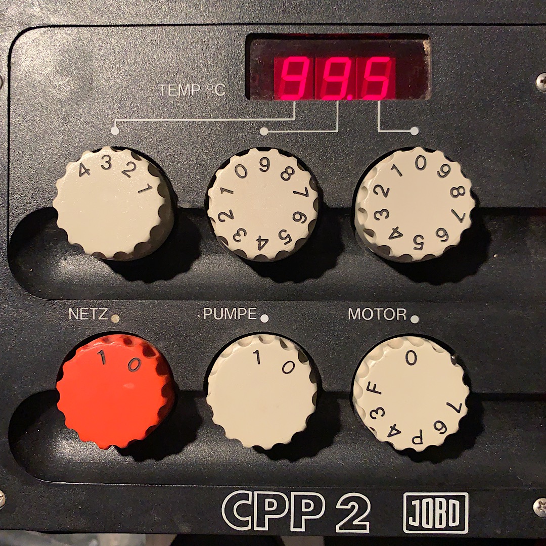

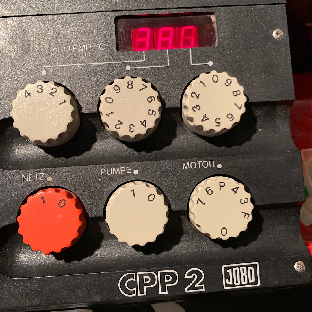

Those are images of my setup, temperature probe, Pocket Weather, Water bath settings at begin and water bath settings at end.
The Temp on the Digital Readout of the Jobo at begining is 39.5 C, the knobs are set at 39 C, the display fickered between 39.5 C and 40 C.
My recorded water bath temp was 40.09 C at end of two hour warm up.

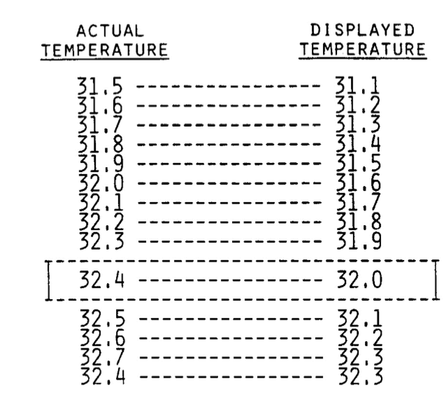

Not sure in re-reading this thread if people understand how the Jobo works. Over one hour warmup is needed. The temp one sets on the knobs is the processing temp. The water bath temp is about one half degree centigrade higher if the Jobo is functioning correctly. This is all in the manual.
For example Page 25:
The temperature of the actual process (inside the tank or drum) is equal to the temperature stabilized in the bottles or graduates, not the temperature of the trough or post-processing effluent.
