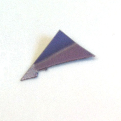

Just processed another roll of CATLABS 80. The leading corner of the film was bent in such a way that I can easily imagine it catching in a film back that has a more sinuous path than my Rollei.

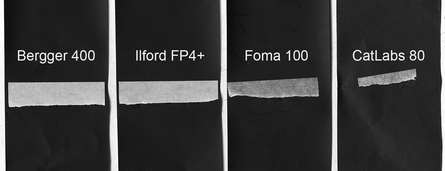

I compared the backing paper of four films and found CatLatbs used the least amount of tape. Plus the Foma and CatLabs tape was thinner than on the Bergger and Ilford film. That being said, I've never had any trouble with Foma or CatLabs film. I use RB67, Bronica SQ-B and Mamiya 645 cameras.

Looks like a great art installation. :whistling:
I'm not sure how the tape is normally applied on roll films, but those illustrations seem to suggest that the Bergger and Ilford versions are neatly applied by machine, while the Foma and Catlabs look to be bits of torn sticky tape put on by hand (by bored workers?) :smile:

I spoke with Omer Hecht about my issues with this film and he was very forthcoming and helpful. He assured me that the "quality control" issue has been addressed and that the film now being shipped reflects that.
He is also sending me two new rolls to replace the ones I had the tape issue with.
It seems that the issues are primarily with Hasselblad because of the torturous path the film must take through the film magazine. I had the tape pull away on my second and third (?) roll. I have now shot 5 more rolls with no issue. Now that I am aware of the issue I am very careful winding to the first frame in my Hasselbald magazines, after that it is the same as any other roll 120 film.
I also asked Omer directly regarding the marketing of this film as "Following in the footsteps of Kodak's famous 'Panatomic-X' (which was used in Polaroid's equally famous Type 55 film), CatLABS X FILM 80 brings back a classic touch with its unique look" he indicated in the affirmative that this emulsion was deliberately formulated to emulate the classic Kodak Panatomic X.
I am looking forward to receiving these new rolls to see if the tape has been applied the full width of the film to the backing paper.

Just shot and processed my third roll of CATlabs 80 120 film. I like the look, the base is very clear--not sure what the material is (mylar?), it is certainly not the same as Kodak or Ilford. There is hardly any curl from being rolled up, and it makes it a bit difficult to load on the developing reel--other films stay rolled up when removed from the spool, the CATlabs sort of relaxes and can't be easily gathered in your hand. Which for me means the film can possibly touch the table or floor and pick up some dust while loading. Also, this last roll was on the short side. The last frame ended up right at the end of the film. I have never experienced that with other brands.
Weak QC. One has to wonder if they are attaching the film to the backing paper by hand... How did the tape look compared to the example in post #113? Thanks for sharing.
The film would probably be trouble free in most folders or Mamiya C series TLRS - anything with a really straight film path.
Interesting you say that Matt-I've put several rolls through my Rolleicord with no problems and the negs developed in ID 11 1+1 look great. Anyway you'll be seeing some of the results in a future postcard exchange.
