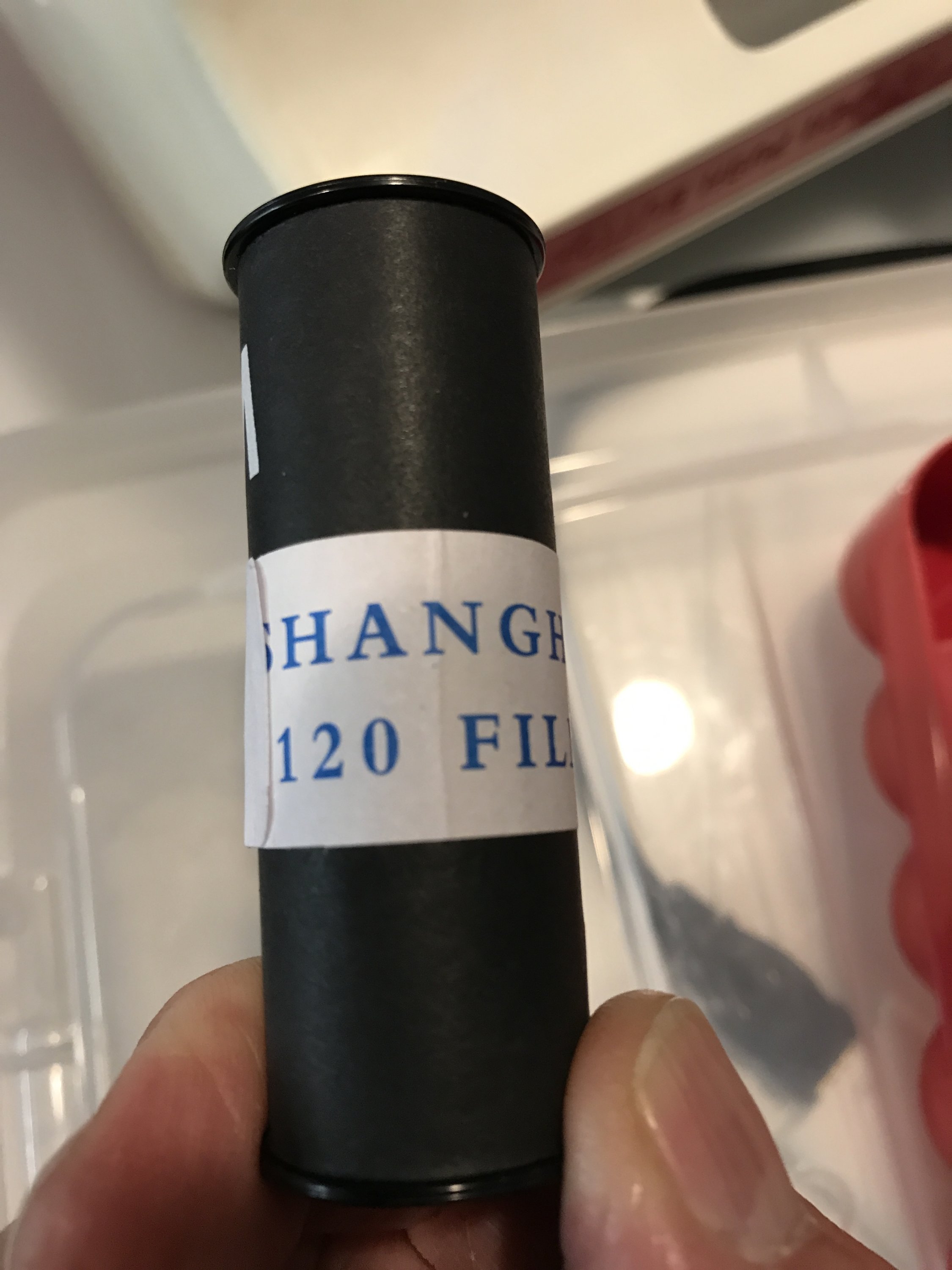

I just shot and developed (its hanging to dry) my first roll of the catlabs 80 film. a few observations that tell me this film is the same as shanghai Gp3
1) the backing paper. thick almost construction paper like (?). the same as a roll of Gp3 I have sitting in front of me.
2) the cheapness of the film finishing screams gp3. I have not shot a roll of film in years that is the same as Gp3, except for this
3) the thinness of the film base as well as the clear color is the same as the Gp3 I have used before
4) the finishing sticky paper says shanghai Gp3 on it. doesn't get much more obvious than that
5) Like Gp3, this film is available in 120, 4x5 and 8x10, but NOT 35mm.

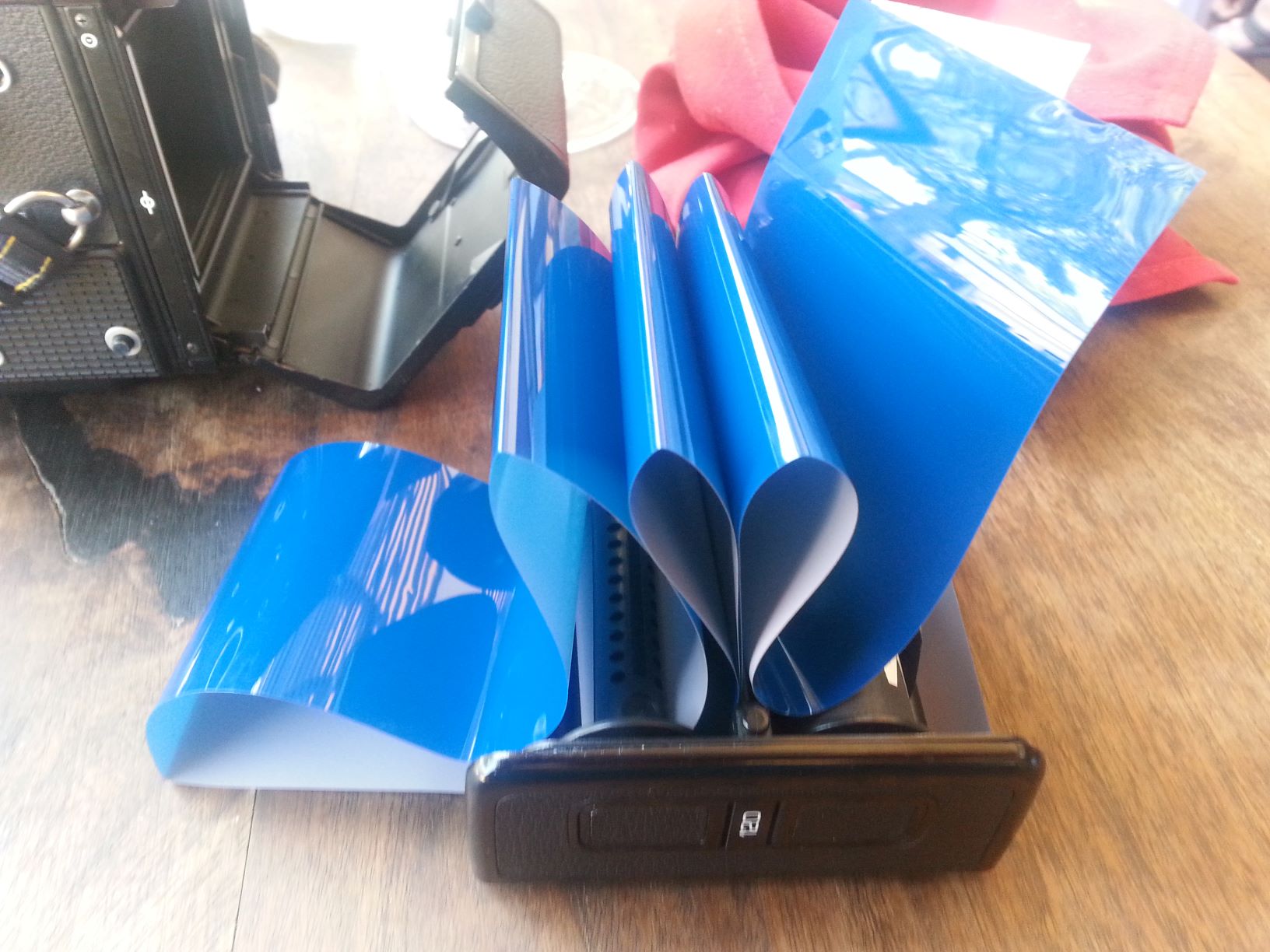

So my second attempt at using the film did not goes as well as the first. When I opened the back I was quite surprised to find it blossom into a total mess. This time I used a Bronica SQ-A. I've run over 100 rolls thru that back with no issues. I subsequently tested a roll of Acros and it came thru fine. I did email the company and they are sending a replacement.
Yep, that's just what mine looked like, Hasselblad A12 magazine . . Thought I was going to damage the magazine getting it out, that would have really pissed me off . . . destroy a $200 magazine for a cheap roll of film.

I strongly suspect that the issue is being caused by the tape not going far enough across the width of the roll to hold the corners down and one or both are lifting up just enough to catch on the tab hanging over the negative area as the film is advanced to the first frame.
I’ve run several rolls through my 500CM now and every single one I’ve felt catch on something as I advance to the first frame. I’ve gone slow and stopped as soon as it catches and pushed a little on the dark slide while still gently trying to advance and that’s been enough to get the corner to pop back under the tab and let the film advance without tearing off the backing paper.

Considering that this is supposedly a first batch I’m not surprised, nor would I expect issues with every camera, however, failure to address it in future batches would be cause for concern. The 500 CM is somewhat unique in the tThe film magazine is relatively small and circuitous. Other cameras probably won’t exhibit the same issue. For example, I would expect no problems with my GW690 as that film path is amazingly flat in comparison.
first batch for catlabs, but same as always for shanghai. they have always had this issue for as long as ive used their film, what is it, like over 10 years? its just the way they make/finish their film. if you dont like it, dont think its gonna change any time soon. just buy different film if it doesn't work for you. luckily, their are many choices out there.
After thinking long and hard on this . . . . I have decided that if I have another problem with this film pulling away from the backing paper in the Hasselblad A12 Magazine, I will be asking for a full refund and returning the remaining film stock I have.

I bought 5 rolls of 120. The first one seemed fine, the second one must have detached from the backing paper as the camera (Rollei 6008) acted as if it was at the end of the roll after the first shot and just kept on winding. The sealing tape at the end of the third roll had Shanghai printed on it.

Out of curiosity I've done a direct comparison of GP3 and the new catlabs film. There are no real differences. The finishing is the same.
And the film is the same. I tested it in Rodinal and made the sensitometric work, too: The characteristic curves are identical, the film speed is identical.
